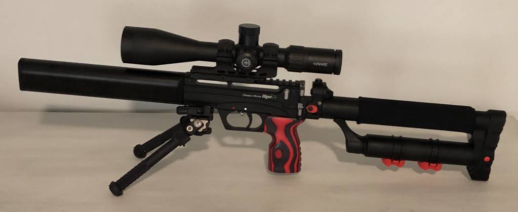

Hawke Compact 6-24×50, SFP, Illuminated AMX reticle, #13220 – 13” long / 23.6oz – Perfect for your Leshiy 2 :)

For my Leshiy 2 I have a Hawke Airmax 4x16 SFP compact waiting for the Leshiy 2. However, I will see how I like the Hawke on the Leshiy 2 and if I don't like the Hawke I might swap it out with the Vector Optics Veyron 3x12 FFP I have on my Taipan Compact or find a new home for the Hawke and get something else. But in the future I plan to get a high tier scope for the Leshiy 2 so lets see.
