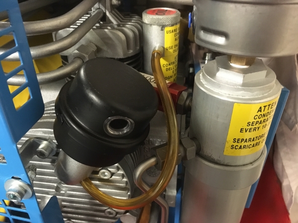

This is another myth when it comes to HP compressors. On my Coltri compressor there is a hose that goes from the oil fill tube to the intake manifold of the first stage cylinder. When the compressor is running I can watch as a small amount of oil, from what is being splattered around in the crankcase, flows through the clear hose to the intake manifold. You can guess where the oil goes once it enters the manifold.....into the first stage cylinder, then into the other 3 stage cylinders at ever increasing pressure and heat. When I purge the fluid from the water separator, which is located after the 4th stage, it isn't just water that comes out, it's a mix of mostly water with oil mixed in. Yet somehow my compressor and air tank don't erupt in a catastrophic explosion. Now it may be that the special oil used in the compressor is non-flammable but the bottom line is the compressor, at least the one I use, was designed to feed oil into the cylinders and the oil, at least this type, doesn't explode at least in conditions up to 4700 psi that the compressor is capable of making.
