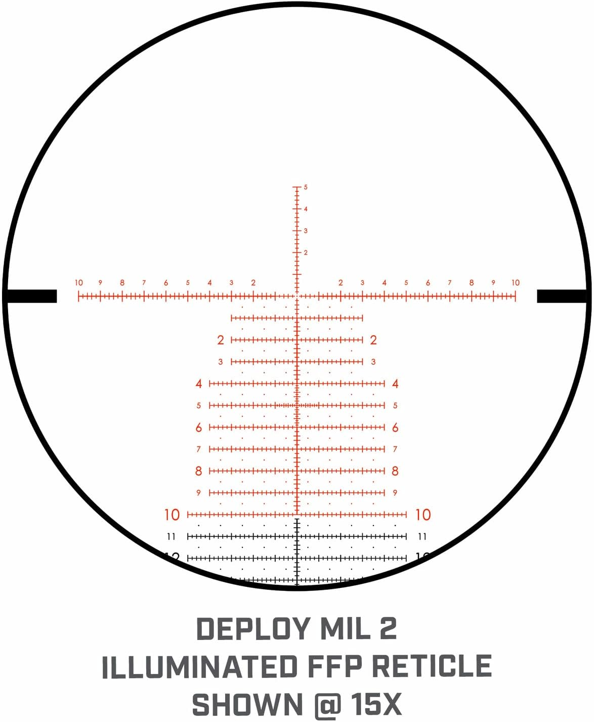

Bushnell just sent me an email. Their new Match Pro ED in 3-18×50 just came out.
Bummer = the minimum parallax focus is 15 yards. darn.
the reticle at 15 X may be a tad too fine / thin ? Def. worth looking through.
It's. 04 mil line thickness so too fine at lower magnification.
My H59 reticle in the S&B is .05 mil.
I don't understand why these manufacturers are adverse to putting slightly thicker reticles on scopes made to be used at 3× to 4x on occasion. It's like they think a target can't be hit with the extras width or ???.

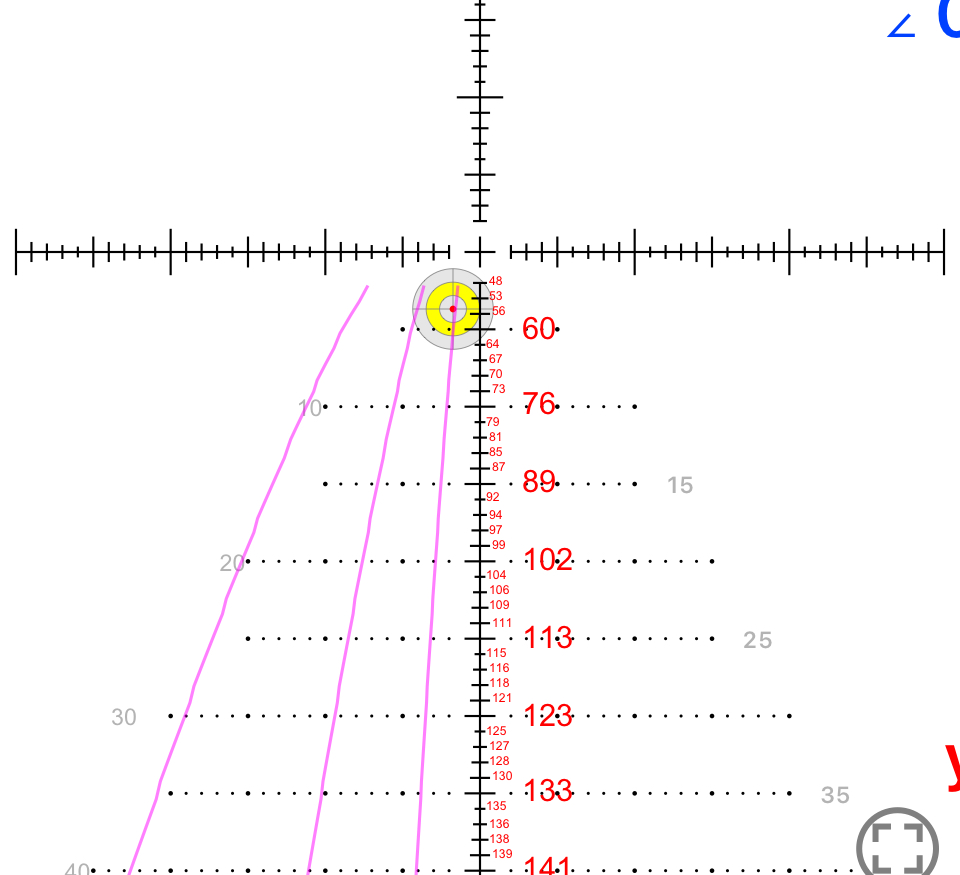

I just moved from a athlon helos 6-24x56 to a athlon 4-20x50 to try for field target. Anymore i only use this reticle as it is easy for me to see and i dont loose it in dark lanes like the ctr dot.
I really like the 34 mm tube and 56 mm objective and it does work well but seems to be inconsistent in its ranging. Im on today off tomorrow with it. Hence the change and it might be for the better for me as the 4-20 seems to hit the mark much more consistently. (So far) 1 thing i woul like to mention to you is there is a very large change in how the scope ranges depending on how the ocular is set. Currently im wearing my dollar store readers to be able to have the ocular adjusted in and still see the cross hair clearly. Heres a shot of my wheel for the 4-20 yellow marks are 10-55
Just thought id add im sending the 6-24 back to have them look at it.

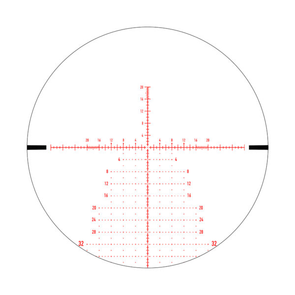

A new point of interest in comparing the TWO different versions of the Element Titan 3-18X50 (34mm scope tube body) FFP / IR
MOA has 3 hold over points zero to one - or 3 tick marks before your large line (bottom picture)
MRAD has 4 hold over points zero to one - or 4 tick marks before your large line (top Picture)
what this means to my eyes and brain - is it's easier to differentiate on those dicey close range holdovers having that one extra line of markation.
Thoughts?
.2 MIL is around .72" at 100yds so yes with the MIL/MRAD you have a more precise reticle.
Yep, and the hashes on the Element Titan MOA reticle are 1 MOA, or 1.047", at 100Y.
I must admit I've always preferred .2 mil reticles from say 14x and up. I had a ton of success in centerfire long range steel matches with the H59 reticle using holdovers and holdoffs because .1 mil is easy to bracket between the hashes when needed. Also tree reticles helped when I needed to aim out far for wind which was often here in Arizona.
