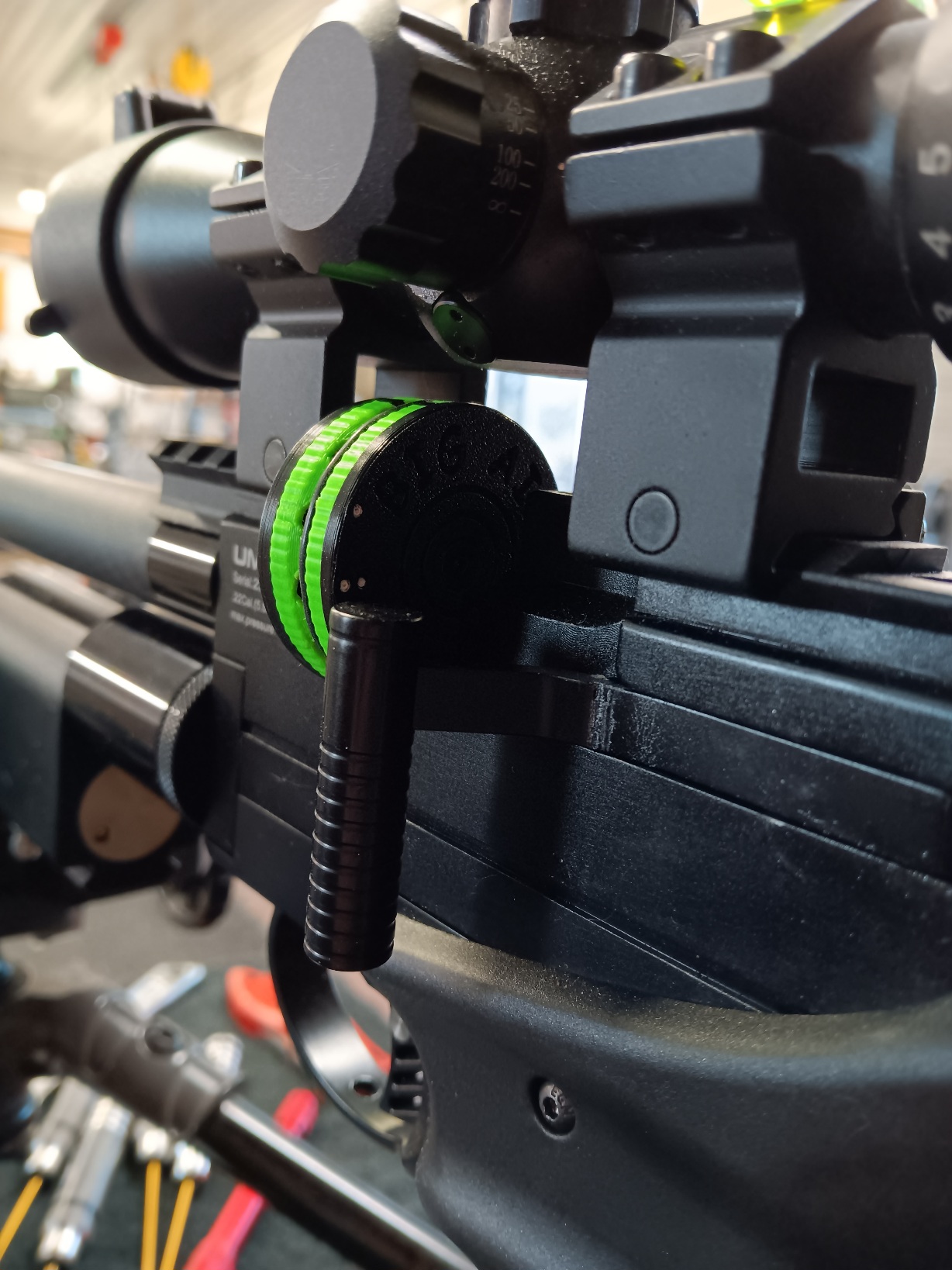

I would gladly purchase two of them . They're nice ...Made a custom side pull lever, what do you guys think!

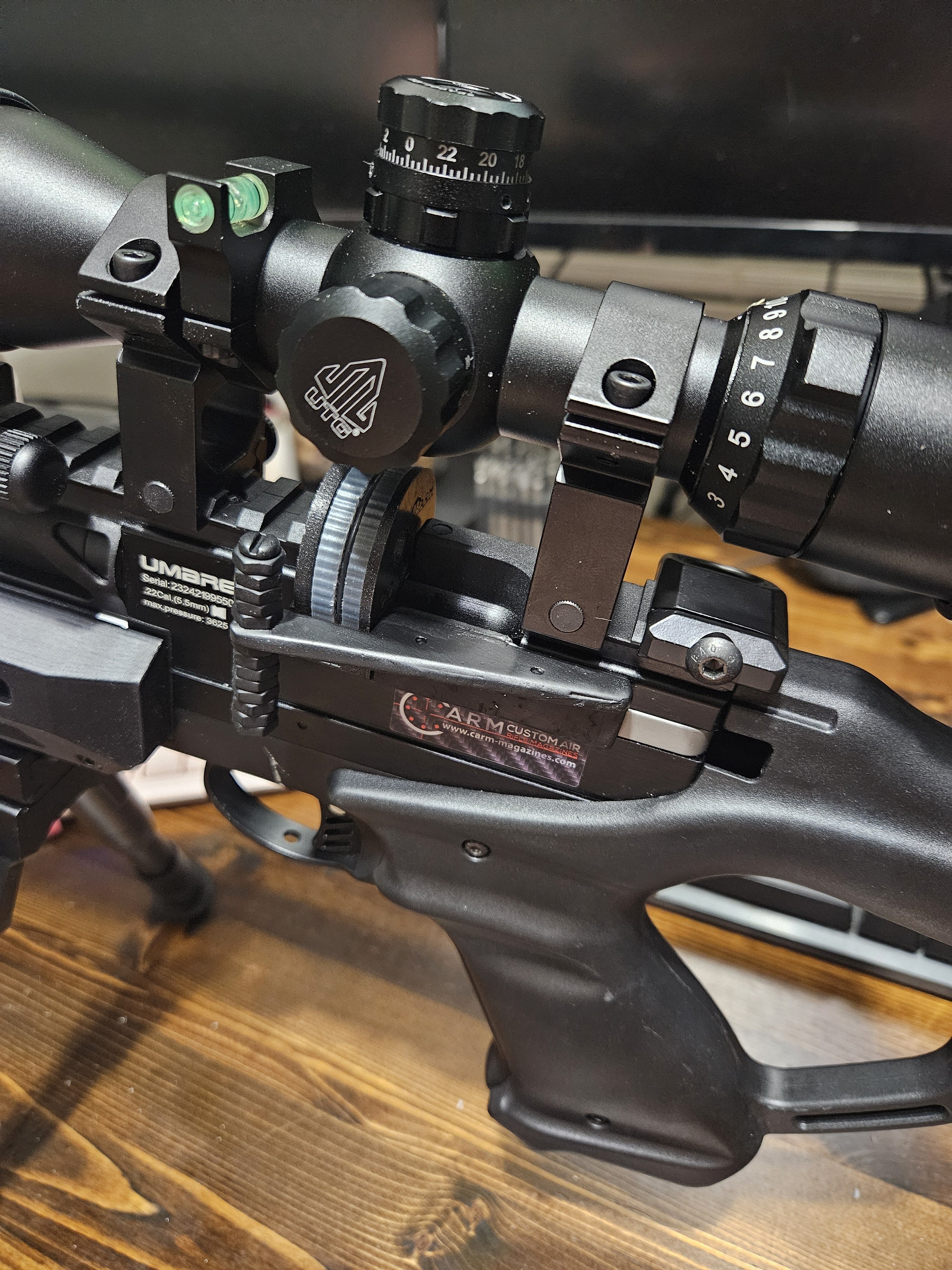

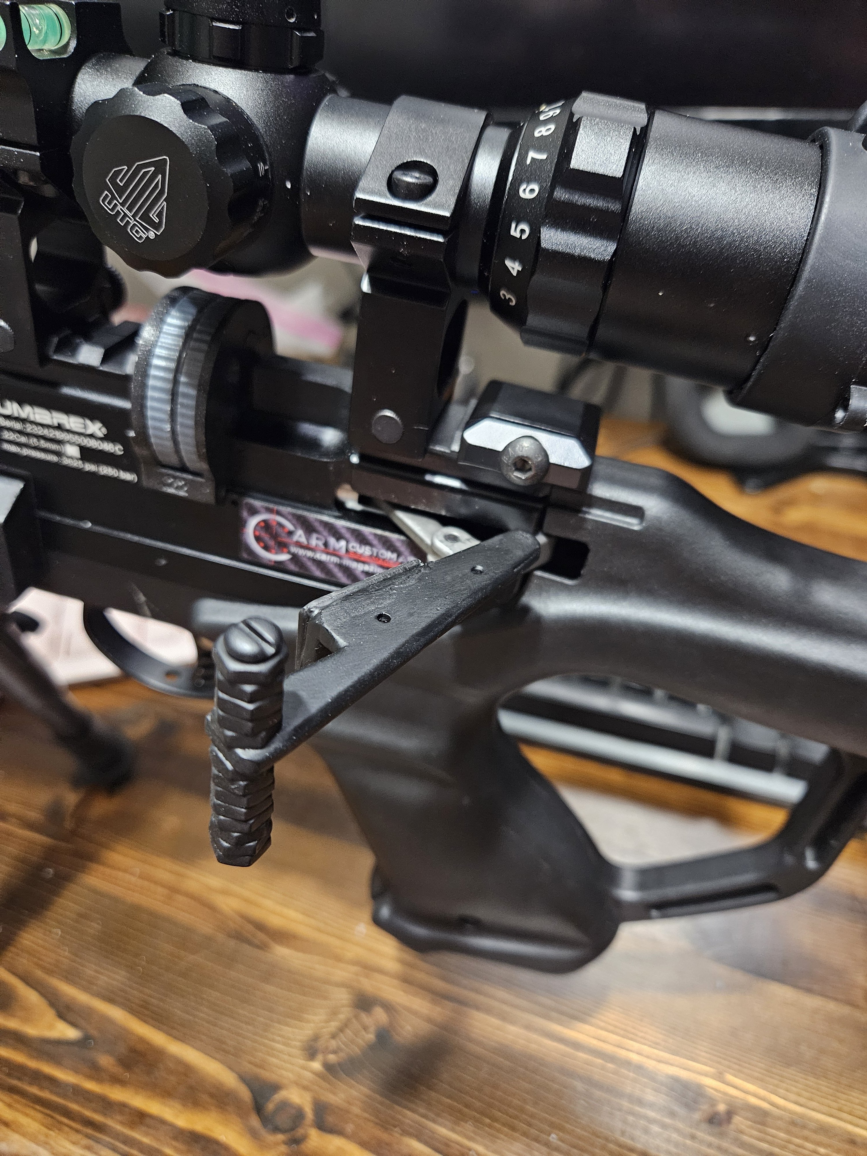

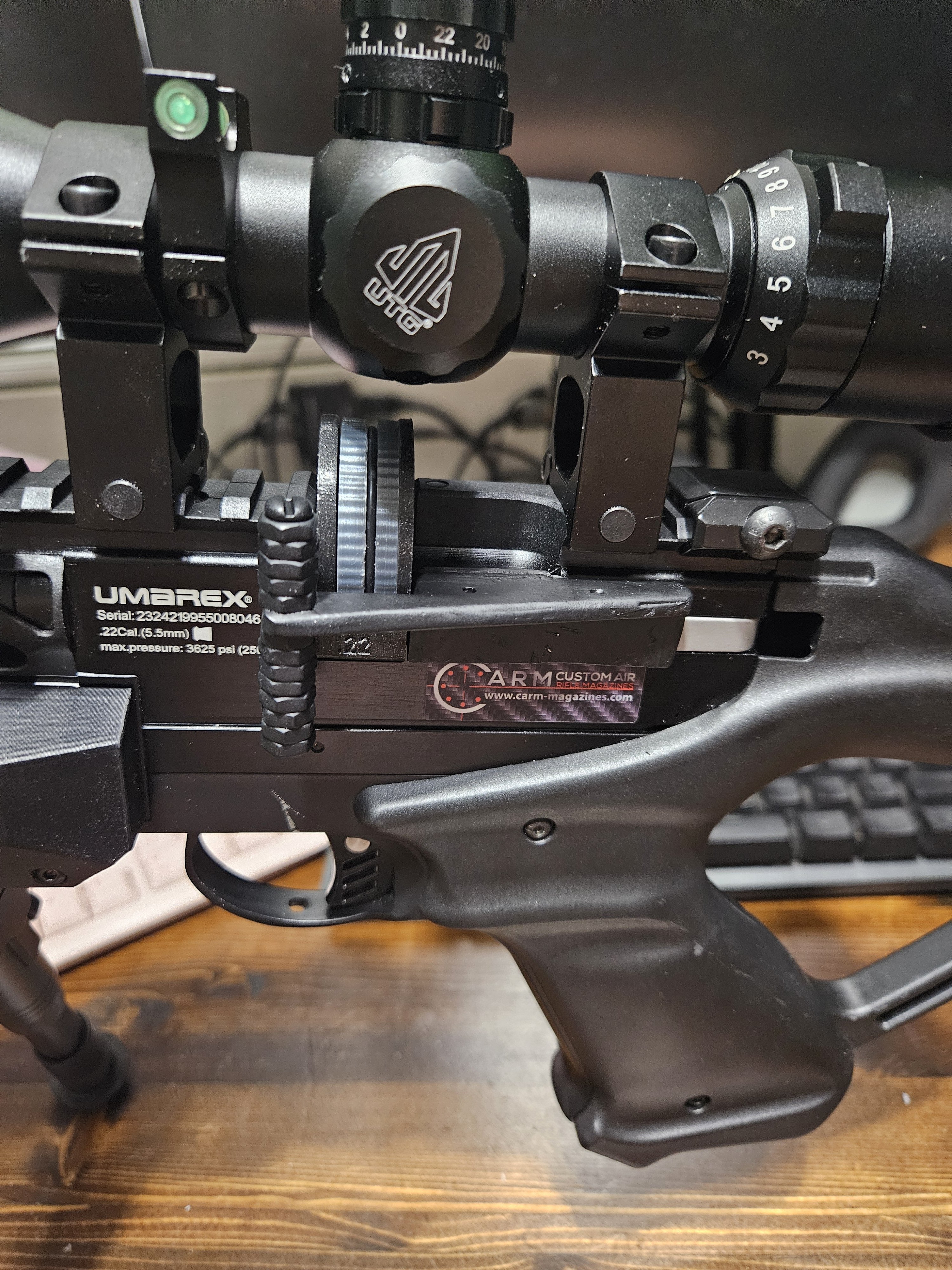

No sorry, I used 3/4 in angled aluminum though. I based it on the below. Post 480. Used 5020 jb weld. Do not leave any access it will get in the way.Any for sale?
ok thanks.No sorry, I used 3/4 in angled aluminum though. I based it on the below. Post 480. Used 5020 jb weld. Do not leave any access it will get in the way.
