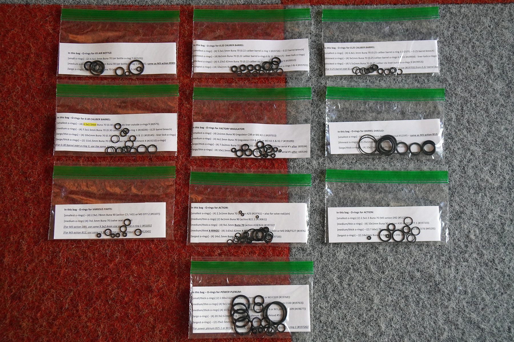

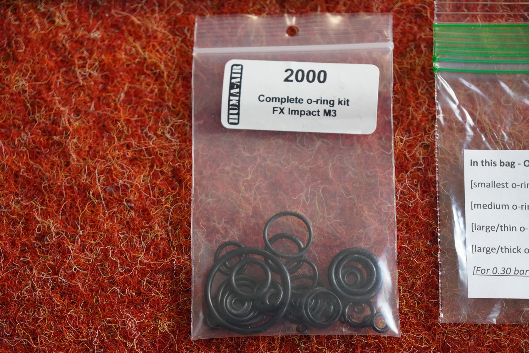

Please see the photos below to compare what the typical commercial "complete" Impact reseal kit looks like (a single, unlabeled bag with a couple dozen orings) versus what my kit provides (multiple bags with o-rings carefully sorted, sized and labeled).
Here's what's included in each kit (o-rings will be carefully separated by rifle part and sizes into ziploc bags and clearly labeled as shown in the photos below):
