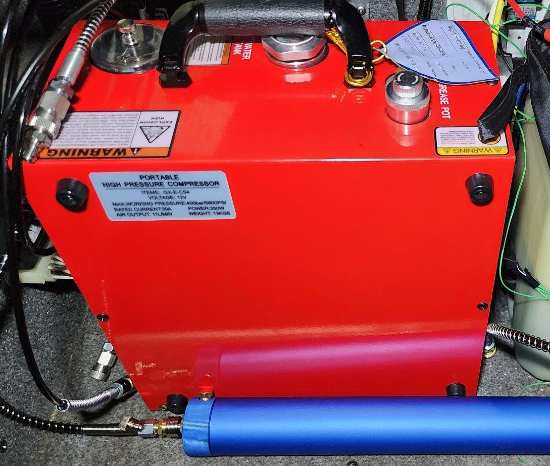

My time with a CS4 is very short (<3 hours so far, and 2.0 of that was a break-in run), but after running it straight for 30 minutes to take my 97cu ft tank from 220 to 245 bar, I have confidence in it. I have been following the yong hengs, shoe box, and other compressors for a few years, and never felt confident enough to pull the trigger on one. My last fill (30 minutes) took the coolant and head temps from 75.0/74.9° to 112.0/114.2°. (Ambient was around 70°).

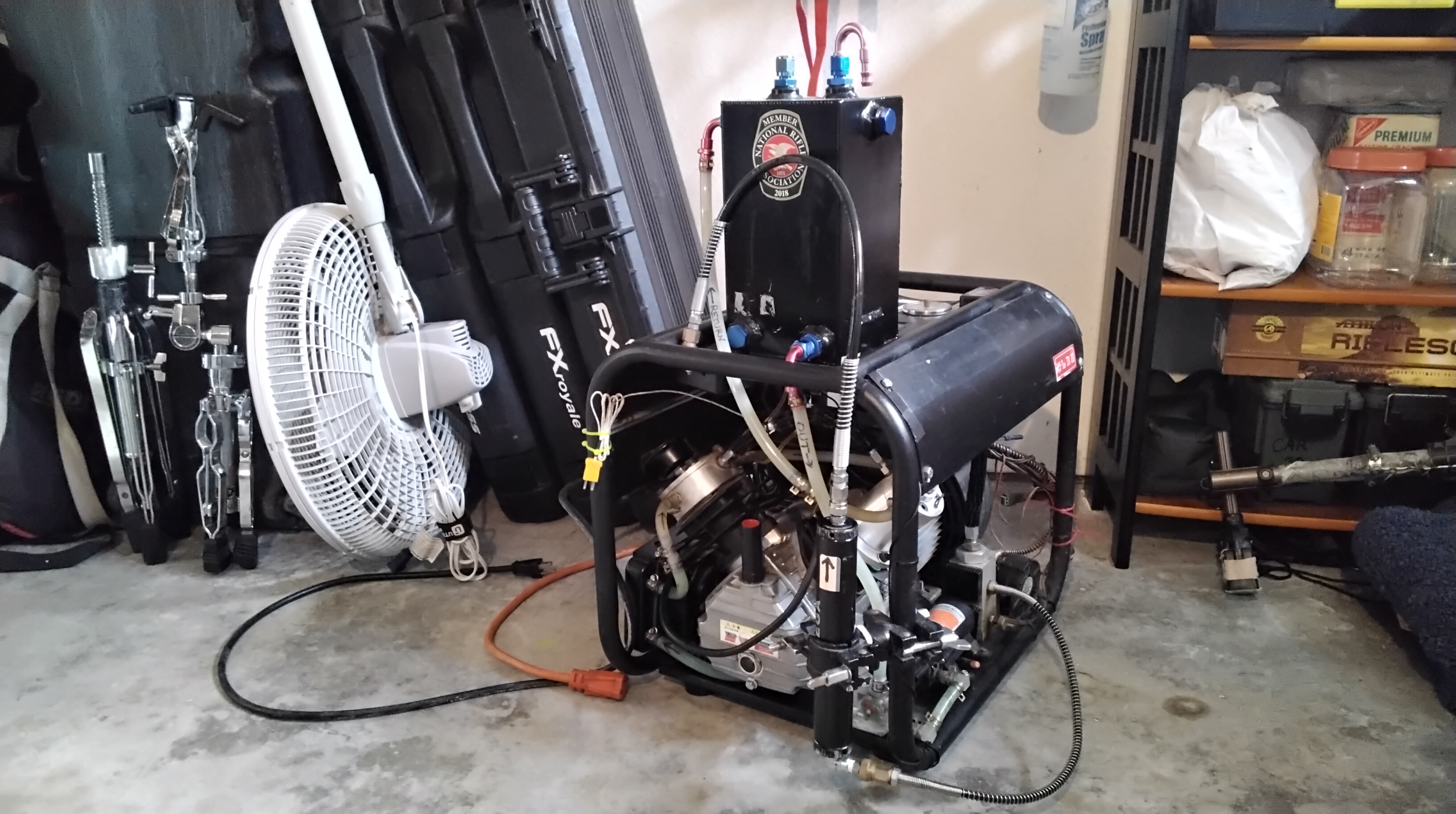

Picture worth a thousand words. Here's my trouble-free three-year-old YH, everything in picture, except AGT Uragan on upper shelf, cost less than $400. Bucket, stool, water-pump/hoses are set up and broken down each fill session, all else remains in place. Dump water in washing machine on laundry day, green ice bottles to freezer. Not portable and loud but fills guns in minutes, never going over 50 degrees C, providing clean, dry air. WM
Here's mine. A little pricier, since it's 3 years after yours, but no bottles, bucket, stool, and nothing to break down after each fill, whether it be a 7-8 minute gun fill or a 3-hour 97cu ft fill. $658 for pump and 1 filter (hoses excluded, as they seem to be in your post). Takes about 8-9 minutes from 150 to 250 bar, and is VERY quiet. Hasn't gone over 41° C/105° F yet. Might do so when summer is in full swing. (This setup is outside, not inside).
Well, your YH has already proven itself over the test of time. Now let's see if ours are up to the task! (do you do any large bottle filling off yours, or just guns?)
No tanks, just PCPs, 250 and 300BAR. Rotate my collection on backyard 50 and 66-yard targets. Select two, or three, shoot few mags, next day, weather permitting, several more, also a few mags. After 3, or more, are at, or near regulator drop-off, set up YH and refill. Best guess is one YH refill session every 3 to 5 days, runtime per hour meters @ 38 hours. Gauge started leaking @ 20 hours, using liquid-filled one from my Chinese HPA handpump, doing fine. WM
