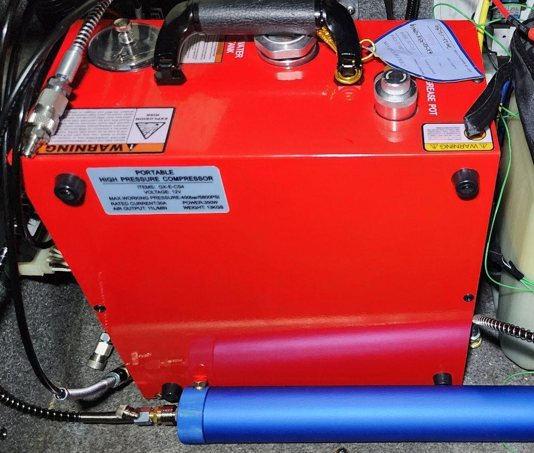

Here's mine. A little pricier, since it's 3 years after yours, but no bottles, bucket, stool, and nothing to break down after each fill, whether it be a 7-8 minute gun fill or a 3-hour 97cu ft fill. $658 for pump and 1 filter (hoses excluded, as they seem to be in your post). Takes about 8-9 minutes from 150 to 250 bar, and is VERY quiet. Hasn't gone over 41° C/105° F yet. Might do so when summer is in full swing. (This setup is outside, not inside).
What Brand is it?
