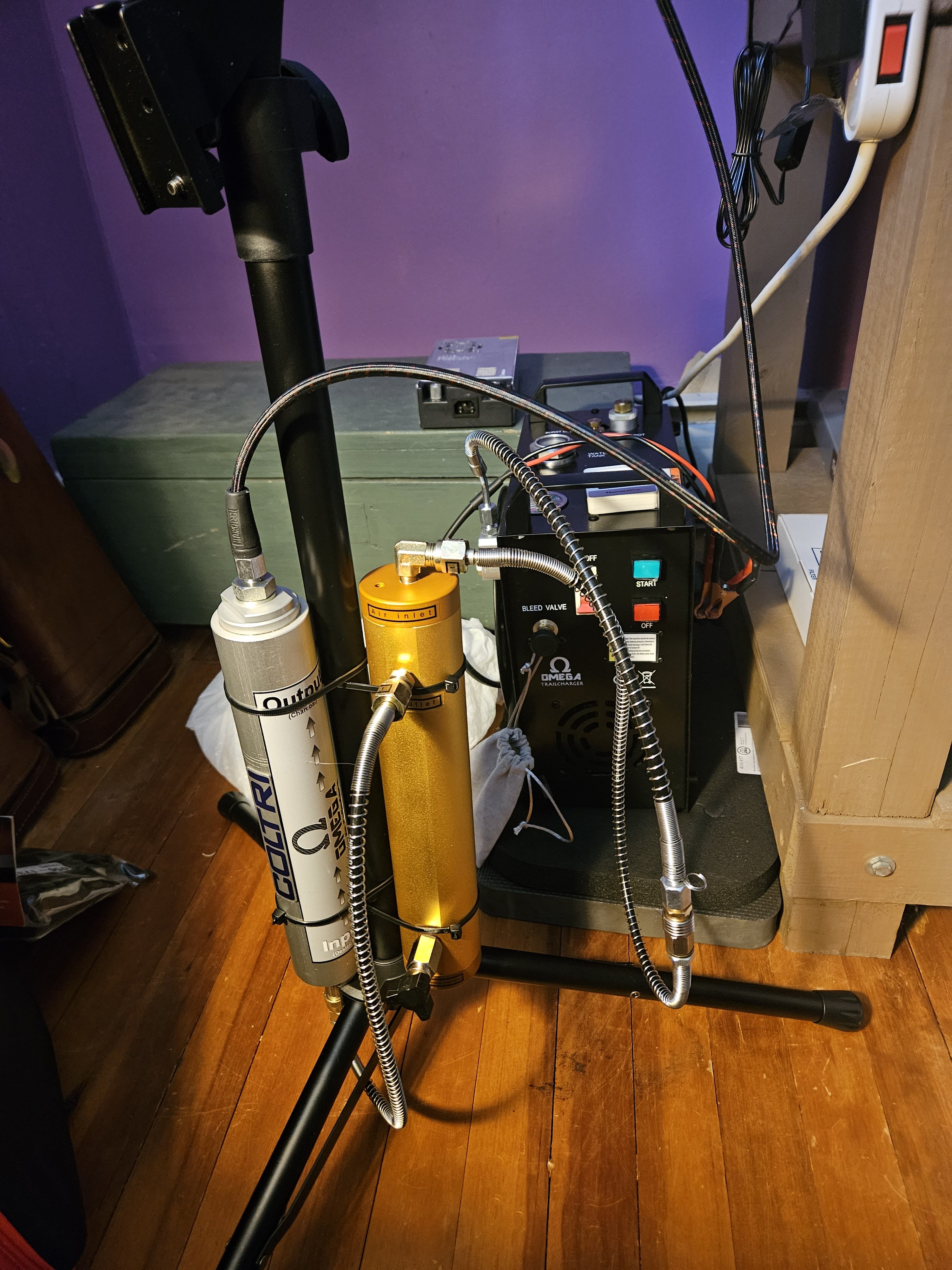

Thank you for the review. Prior to reading this I was not sure if I did this correctly or how much it would help to minimize water/vapor from getting into my rifle's. If I understand you correctly I am doing a reasonable job of protecting my rifle tanks from corosion.
I am using what I believe is a centrifugal coalescing filter (GOLD) as my 1st stage coming off of an Omega Trail Charger Compressor and then continuing the HPA through an Omega Clean Air Molecular Sieve Desiccant Filter (SILVER,a rebadged Coltri) as a 2nd stage prior to filling my airguns. Do you see any real additional benefit to adding a Tampon filter to it and if yes at what point in the pathway?
