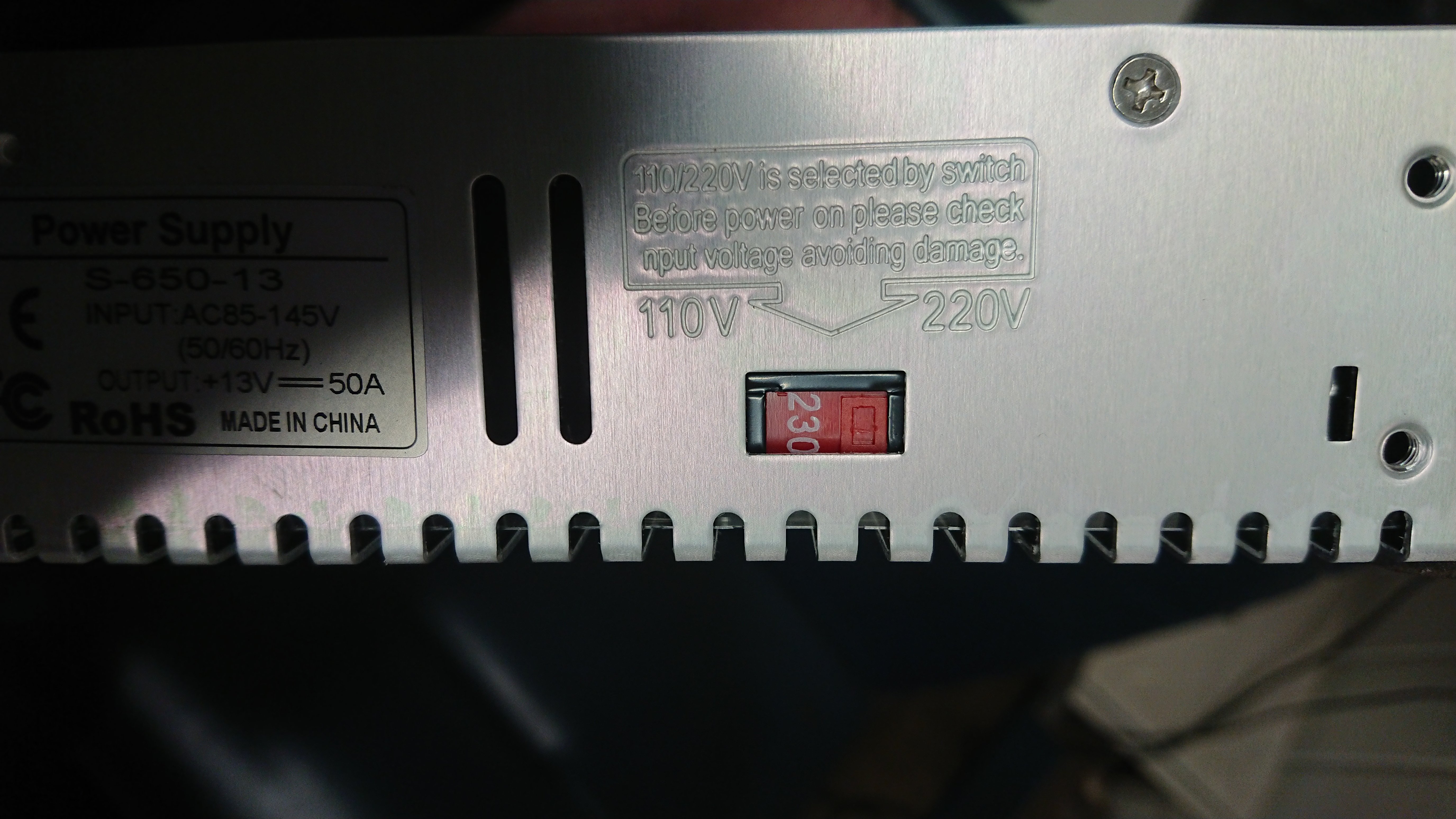

i don't want to burn the inverter- i already did by plugging 12v inverter to my 24v outlet in my truck so before i start today i will make sure..
i know you are in the states with 110-115v and i am in Germany with 220-230v but if you have the same compressor i have with the external power inverter then you too need to switch this volt selector..
so please tell me or make photo whether you see the number 115v when you set the selector or you turn away from the 115v and see 230v?
i am pretty sure you slide it to see 115v and not away from it (to 230v) but i rather ask before i make a boom here..
Yes, here in the states we see 115 volts in the window..
great- thank you for confirming that..
now i will select 230v and see that in the window and be good..
i just don't trust the Chinese and the way they translate to English.. sometimes they mean the total opposite of what they are saying in English. :D
