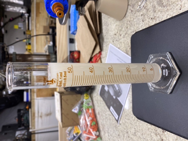

It was time to change the output filter on my compressor so I was able to measure how much moisture has resulted over about ten months of use.
During this time I have topped off a 6.8 liter tank from ~170 to 300 bar eleven times. There is a dehumidifier in the basement near the compressor which should be holding the input air at 50% humidity. The white liquid in the beaker is from the accumulated output from the separator tower and is about 60ml. The weight of the output filter increased by 8 grams which I estimated to represent about 8 more ml. So a total of 68ml (~2oz) over the eleven fills. Good or bad I don’t know but it’s what I got. Hope this helps put the moisture issue in perspective. Edit: Based on initial replies I will add that each fill took about 10 minutes and I did purge the separator after each fill and left 80 bar in the compressor to keep moisture out when not in use. The point I was trying to make is if you compress this volume of 50% humidity air you will produce this amount of moisture. If you can’t account for this it is in your tank or in your gun.

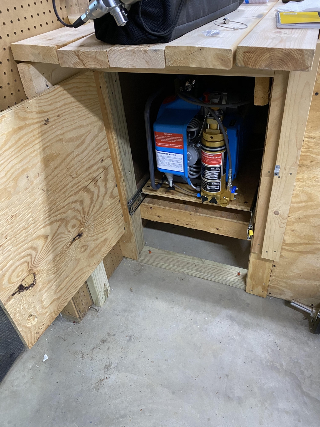

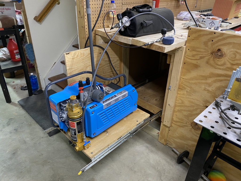

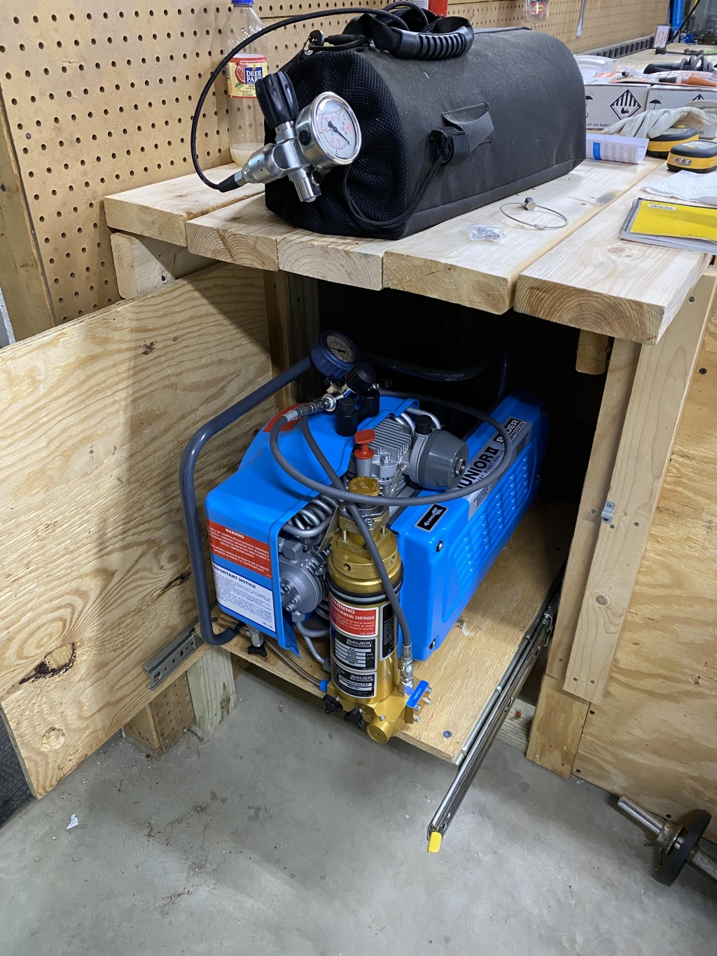

I see that you own a bauer compressor based on that blue filter. I too own a bauer junior, can you send me a couple pics of your setup? id like to see it thanks.

All very careful information to consider... especially when a graduated cylinder is involved!
