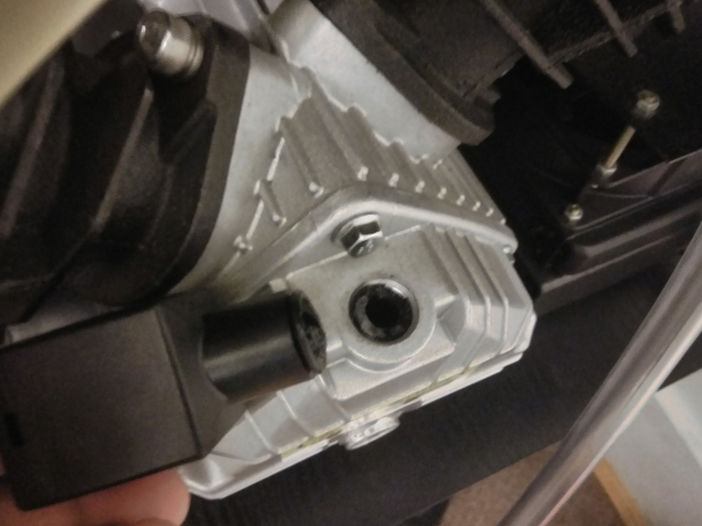

Had my hatsan lighting for a month now. Only used it maybe 5 times and had 4 hours on it. All is good until today. I turn it on no more and 2 second and I heard a pop and something flew from the compressor. I look on the floor and found the oil breather. I was sure I screw in on, how can it flew off. So I look at it and the thread broke clean off. How did the crank case even build enough pressure to blow the breather clean off like that? Isn't the breather supposed to let air out so it doesn't build pressure inside the crank case? I've seen someone with a crank case blew off. Probably due to same issue. Glad the breather gave way and not the crank case. But damn. Any idea how this could of happen and how to avoid it in the future?
if you look at the threads they will tell the store of where they have been damaged and where the final break did occur
so did it really blow off or just fall off from the vibration at the time of the crack making it to weak to stay in place
with that said the new breather might need same extra support or a whole new breather of a different type
just guessing
Yup, either damaged plastic/threads, or, something like damaged piston or rings..
The crank case shouldn't have very much pressure in it at all..
If/when rings or a piston goes, the pressure from the head can 'blow by' down into the case,
built up pressure, and create havoc - like possibly blowing off a breather/filter..
Hopefully it's the cheaper/simpler issue of the two..

IF there is any damage to the con-rod/piston/rings, you'll know it due to sound, rattle,
or, the comp just won't be able to build up any significant pressure..
