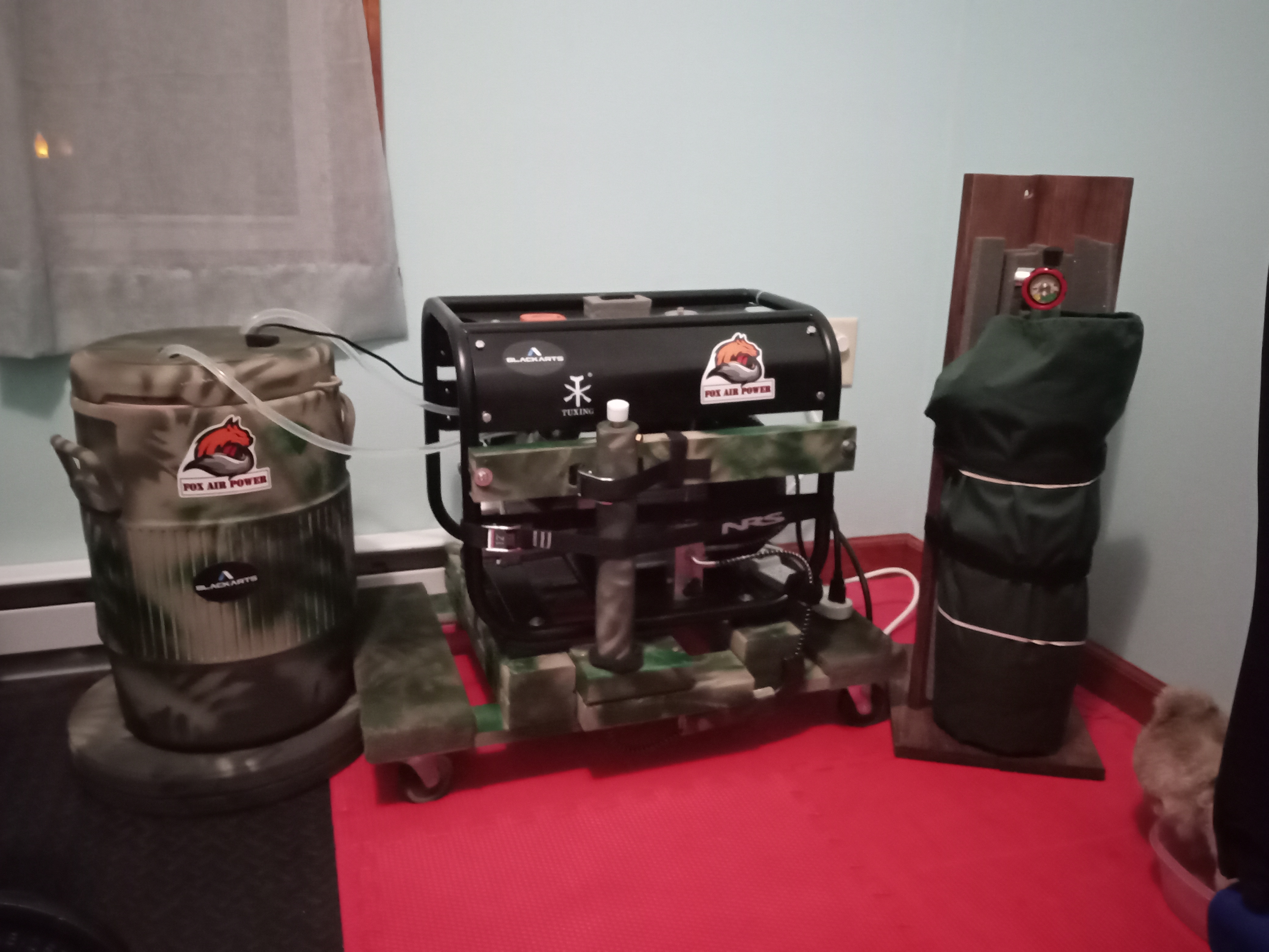

I have a Tuxing twin cylinder, It's the heat that what we should avoid. I don't let mine get over 140, I was told 180. recommend oil- ISO 95 compressor oil. I use Kobalt, 16-KS CO is a high preforming synthetic compressor oil. I have had it for about a year, fills my 25 cal avenge 4100 psi, AEA challenger 3800 psi and the air tank 4400-4500. All i have done is change the oil often and keep the temp down,

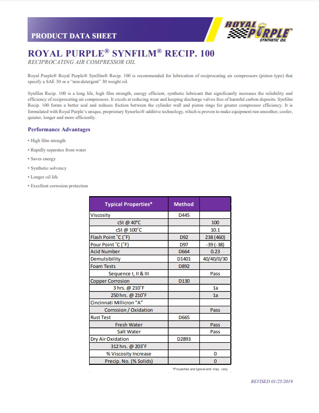

Ok I keep hearing Royal Purple has caused detonation because it,s flash point is to low. Post above said
RP has a flash point of 460F as SecoLube 500 has 520 F. Ok I got to wondering about that. I just checked
& the sec,s I found show Royal Purple to have a flash point of 271C which is 519.8 degree Fahrenheit ?
Some one is wrong! Fly. This is crazy I went back to make sure on my info, and on RP site they indeed posted
a flash point around 240C I knew I just read a Flash Point of RP 271C & 519.8 degree Fahrenheit. What ???? So I did
more looking. the site I found the 252C at 519.8 was posted on Zorro tools which it a large tool company that sells
all types of lubes. Then I checked some more & on another royal purple site they listed the same ISO 100 oil as
252C @ 485 degree Fahrenheit? Now they also have a ISO 150 oil that is 260C @ 500 degree F. I plan to call them
tomorrow & see what’s up. I,m running RP now and plan on using up what I have now. I,m thinking changing to Amzoil.
They have always had great oils. There compressor oil is rated at 508 F flash point & that should be safe. It sells
about $20 qt .
Fly
Reactions: 357cal
There is more than one RP compressor oil listed, there are 4 different oils. The two for our compressors must
be ISO 100 rated. The RP listed on Amazon flash point is 495F 257 C. Global has another muti- Vis with a 505F @
263C flash point. I know this is very confusing but my understanding is the one with the 460 F 238 C flash point
is not multi-VIS. I will let you know what ever more I can find out. That’s why I plan to switch to Amsoil. I checked my
RP & it is muti-Vic & it has been just fine. Oh well we did find some things out but I m still calling RP & maybe get
them to respond here. I would think they need to make sure the ones using there product has the right one.
Fly✌️
