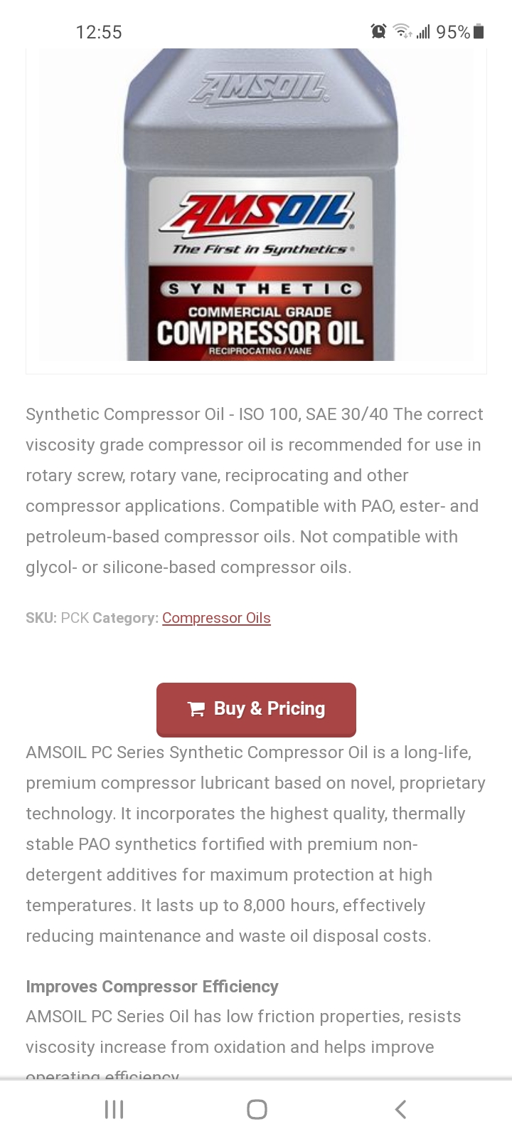

According to the Amsoil website it's POA...
"AMSOIL PC Series Synthetic Compressor Oil is a long-life, premium
compressor lubricant based on novel, proprietary technology. It incor-
porates the highest quality, thermally stable PAO synthetics"
I have a Yong Heng, bought it used with very little use. The previous owner used Husky ISO 46 oil in it. The oil was clear when I purchased it. After filling 2 rifles from 150 bar each, the oil turned pretty dark. Unfortunately I am not able to find 527 or any of the better oils locally. Having it shipped is to costly. I was only able to find AMSOIL, the dealer carries both full synthetic and non synthetic. I bought the full synthetic. I removed the plate and sight glass and completely drained it that way. Initially I tried the plug, but it was barely coming out. I discovered when I took off the cover plate that there appeared to be rubbish or sealant material stuck in the drain hole. Cleaned it out and now can see plenty of day light. After filling with AMSOIL I filled 2 more guns from 150 bar to 250 and 300 bar. I noticed the odor wasn't as strong as before. At first glance when looking at the sight glass, I panicked, all the oil was gone??? Fortunately after looking at it closer it was at the mark. The oil was extremely cleaner compared to the Husky. I don't shoot much as I am limited to where I can shoot, but being able to fill my guns at my convenience is a blessing.
