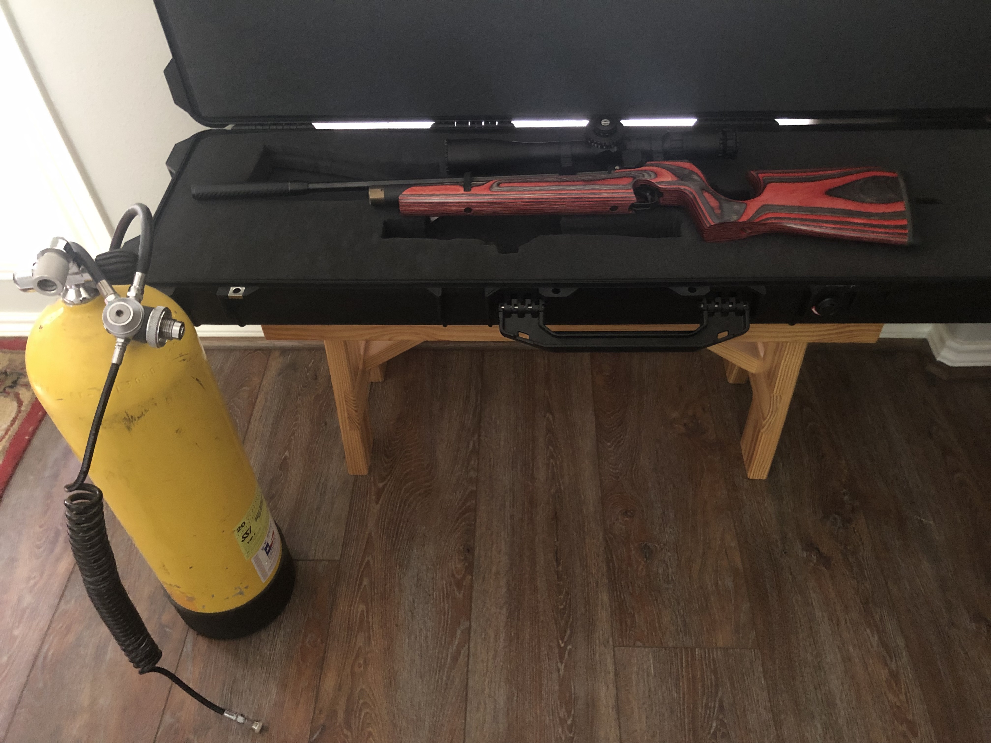

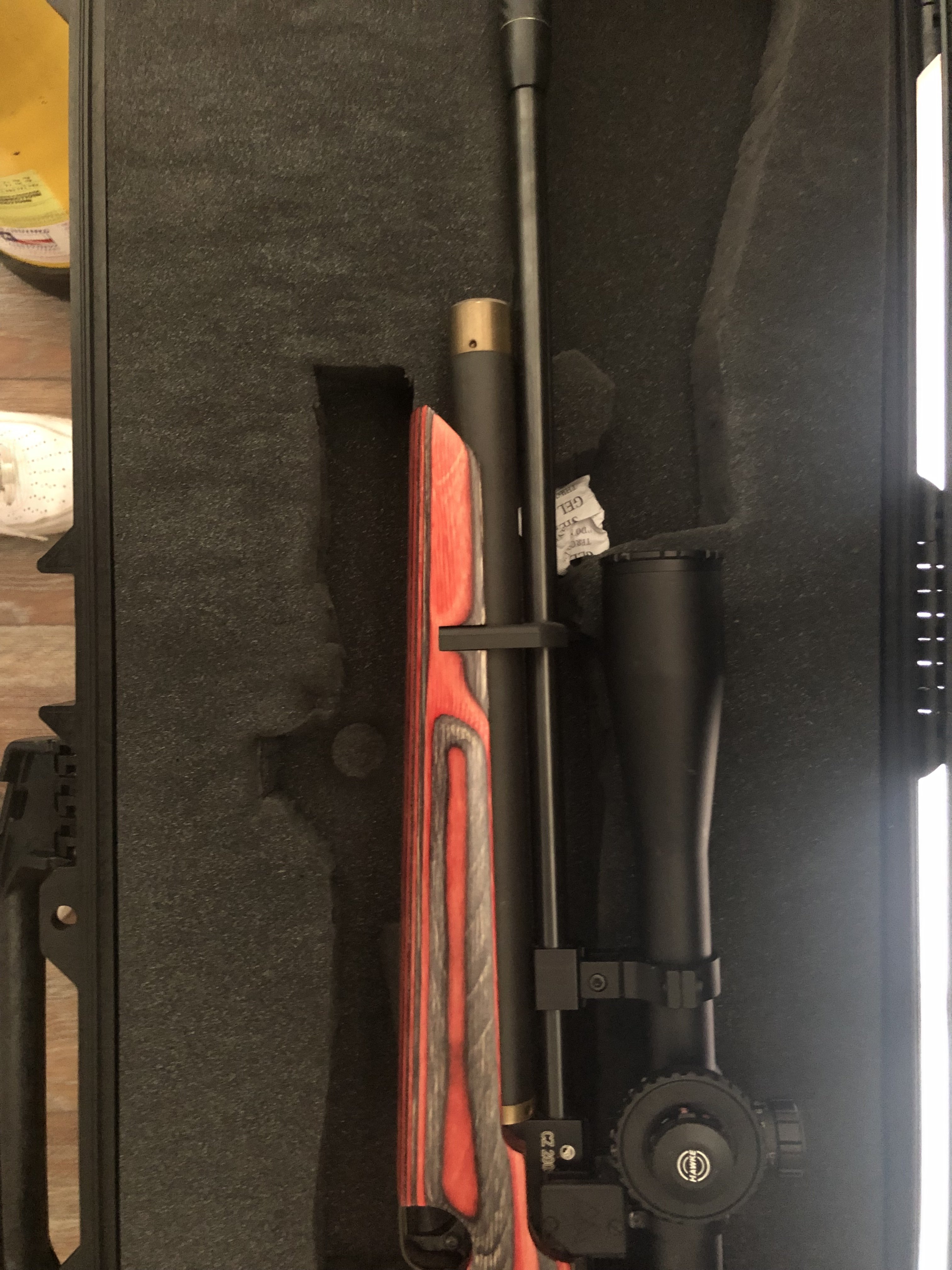

I shoot a CZ 200 with a scope. It has the removeable gas cylinder. Pic attached

Pics of your rifle says nothing.
