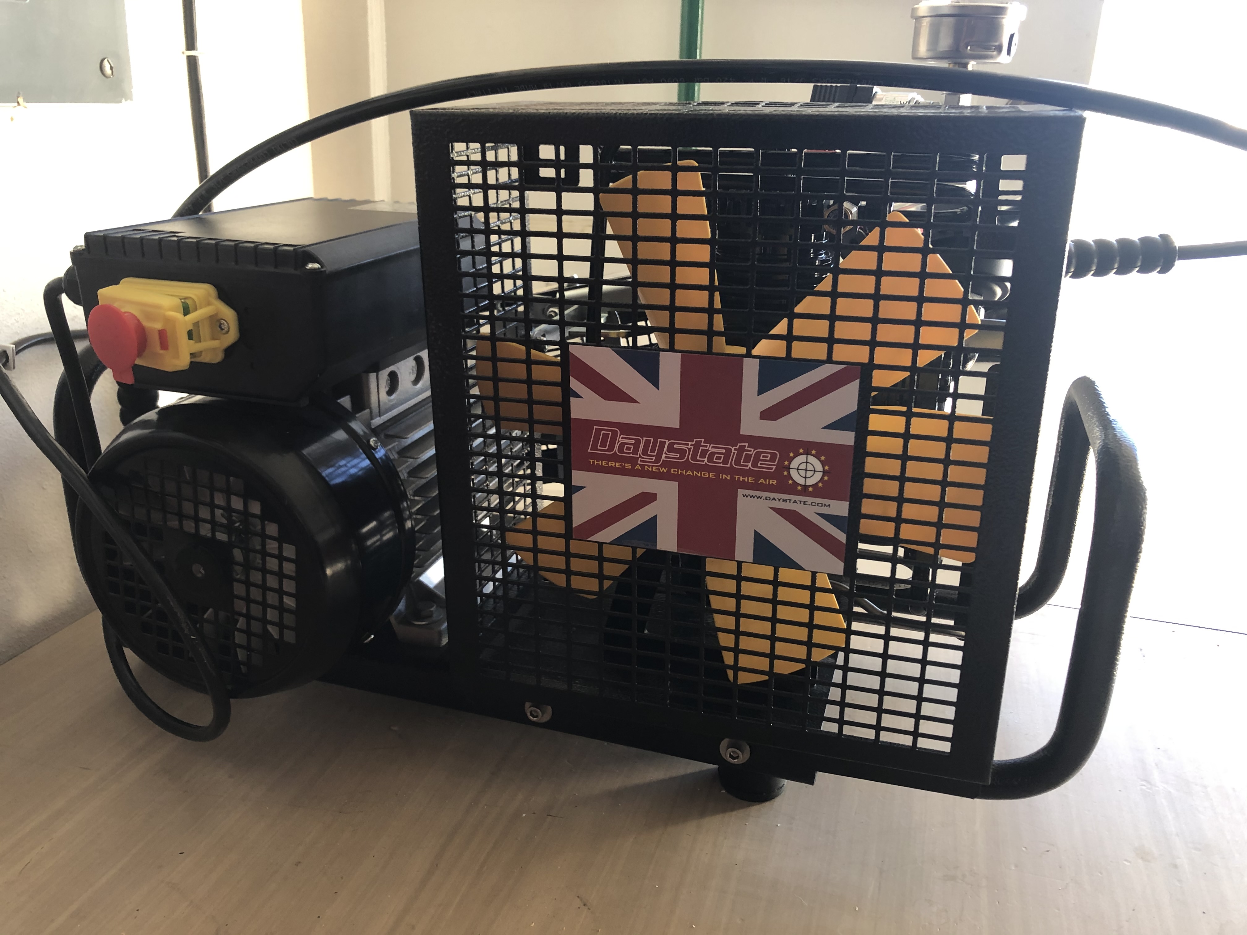

I don't know what Chinese made products you are referring to but I like my 4 Chinese made PCPs and my Chinese made YH. Out of all of them the only one with a reasonable owners manual is the Avenger, however. My P35 in 22 has higher scores on the 30 yard challenge than many guns that cost several times it's price. My YH is working great and has for a couple years now. It tops off my 45 minute SCBA tank from ~3300 to ~300 bar in 15-20 minutes. I certainly would not claim Chinese made products are perfect but the one's I've tried have been very useful and good buys.

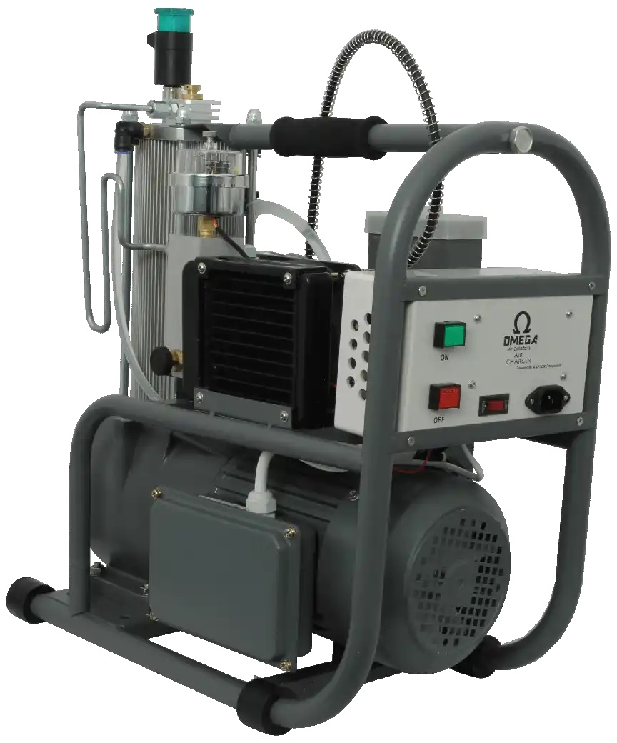

For a couple more bucks you can have a real compressor that will fill your SCBA tanks... Team Centercut has one of these that we bring to the bigger tournaments, and it just quietly tops off the SCBA tanks that we have, about 20 minutes from 200 to 310 bar.
Omega Compressor at AoA
Looks like $800 + more to me. That’s a lot to “top off”. But you are correct it is nice!
