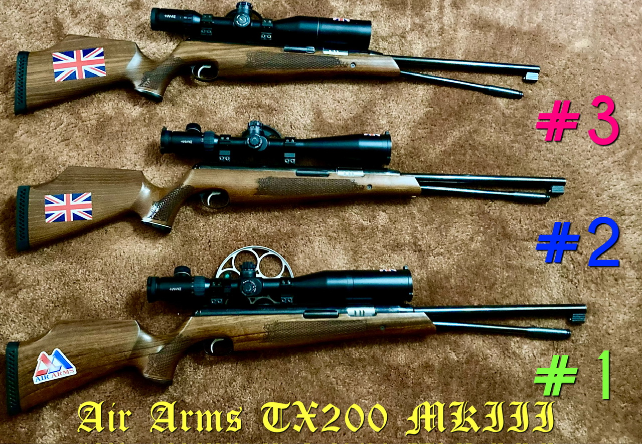

All of these have been treated with many hand-rubbed coats of BLO.
#2 is beech!!!
