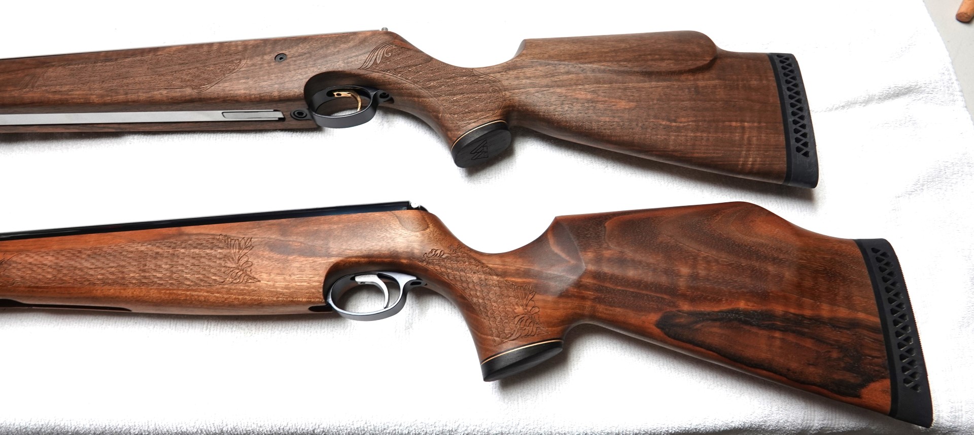

The more I think about it, the more I think mine wasn't in a plastic bad either..lol. Just laid bare in the box, maybe I was thinking about the Weihrauchs I've opened.Any opinions on beeswax or Howard's Feed and Wax? I'm going to take some photos today of "before". I actually got both a TX200 MKIII and a Pro Sport from PA. Neither was in a plastic bag. Both simply in the interior box, well done. They do look a bit dry, and as you will see, quite different in color. I'm leaning toward Watco Medium Walnut for the initial application, but still up in the air about the final finish after a few coats of the Watco. Weather sucks here in N. Indiana today unfortunately and for the rest of the week, making it a bit challenging.......Again, I really appreciate all of the discussion and opinions, that's why I came here.

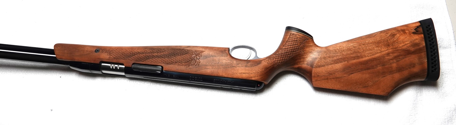

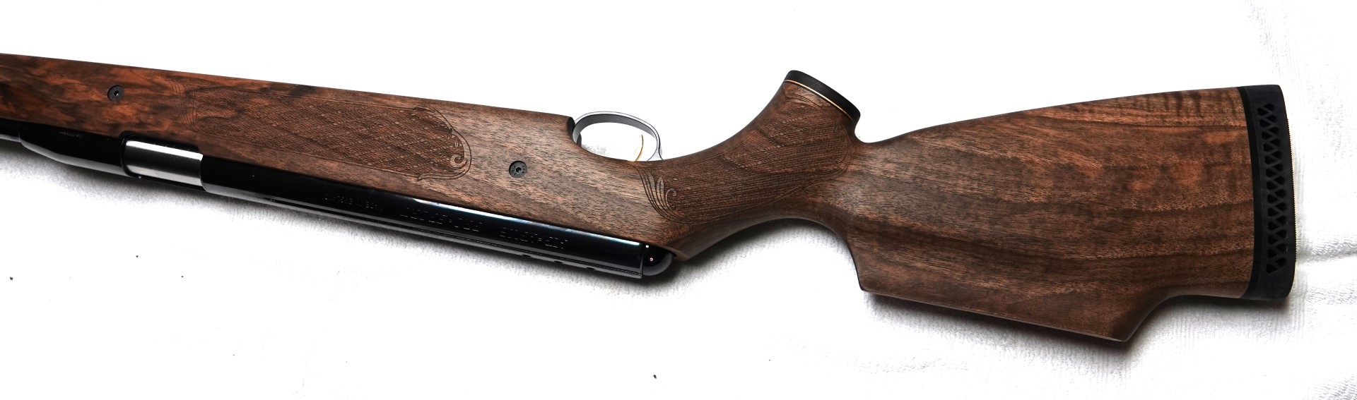

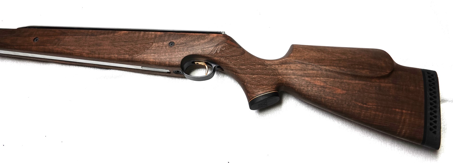

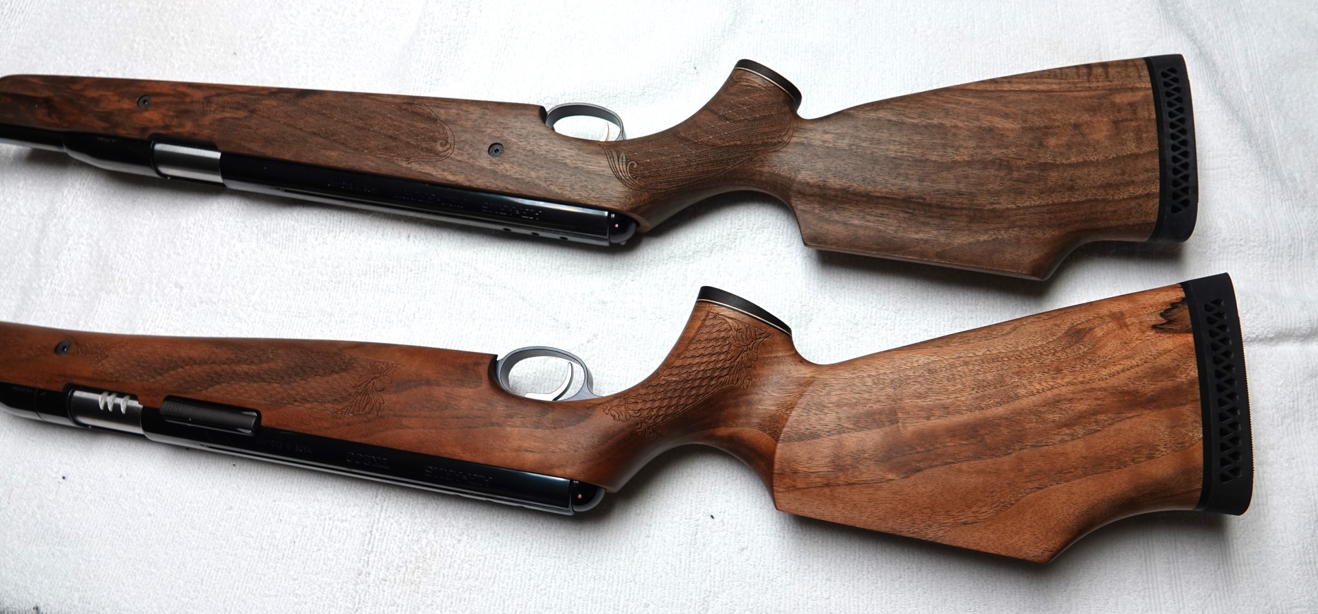

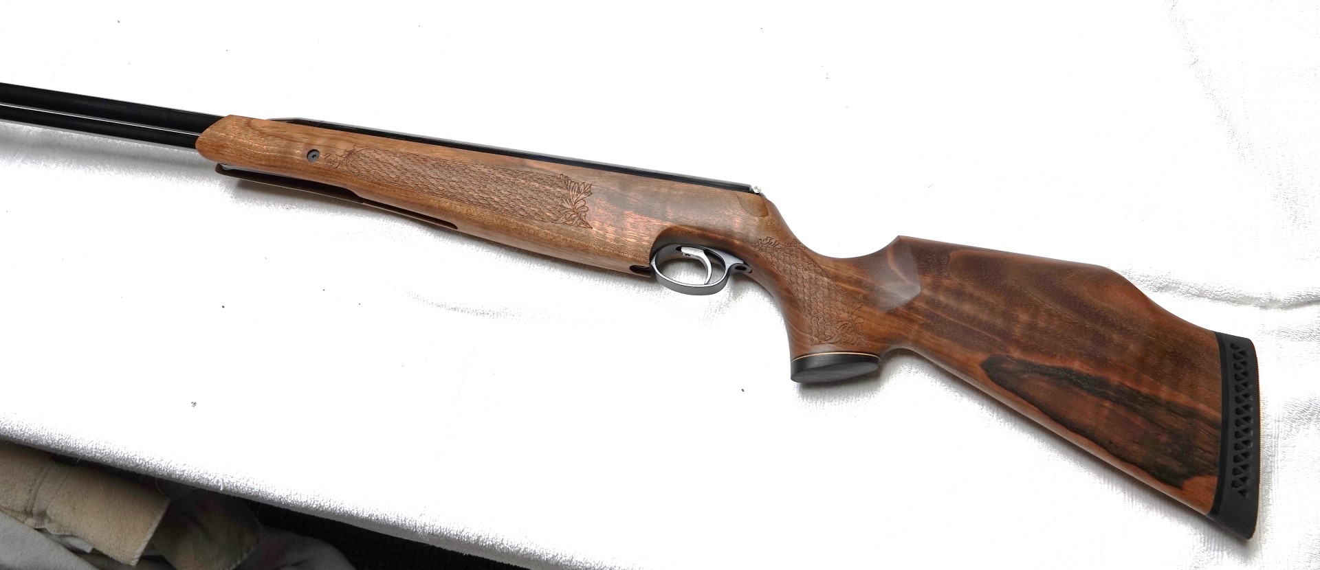

Empty as all AIR ARMS are.Here we go. Photos of both the TX and PS straight out of the box. Nothing applied to the stocks yet. Some interesting grain for sure.
"Empty".....meaning what?Empty as all AIR ARMS are.
You finish speakers. what look do you want ? Then advice will flow. Just don’t use true oil. Unless you want glossy plastic.
As in pores…. Take a loop and look at the stocks. They are not filled. There is hidden chatoyance when they are filled and wet sanded in ."Empty".....meaning what?
Thanks for that clarification. Chatoyance is a great word......As in pores…. Take a loop and look at the stocks. They are not filled. There is hidden chatoyance when they are filled and wet sanded in .

I do like the finish of Tung oil, but the wait for it to dry is very LooooooongI used the 100% tung oil and I like my results. No the pores aren't filled, but I didn't sand it. I did apply several coats over a couple of months, as it takes time in between coats. And it takes time for a complete cure once done. But it did darken the wood from it's dry light colored factory look.
Probably would've been better if I had sanded to fill the pores, but It's not bad. And yeah, at least 3 days between coats, longer is better I think.I do like the finish of Tung oil, but the wait for it to dry is very Looooooong
But look at the results![]()
