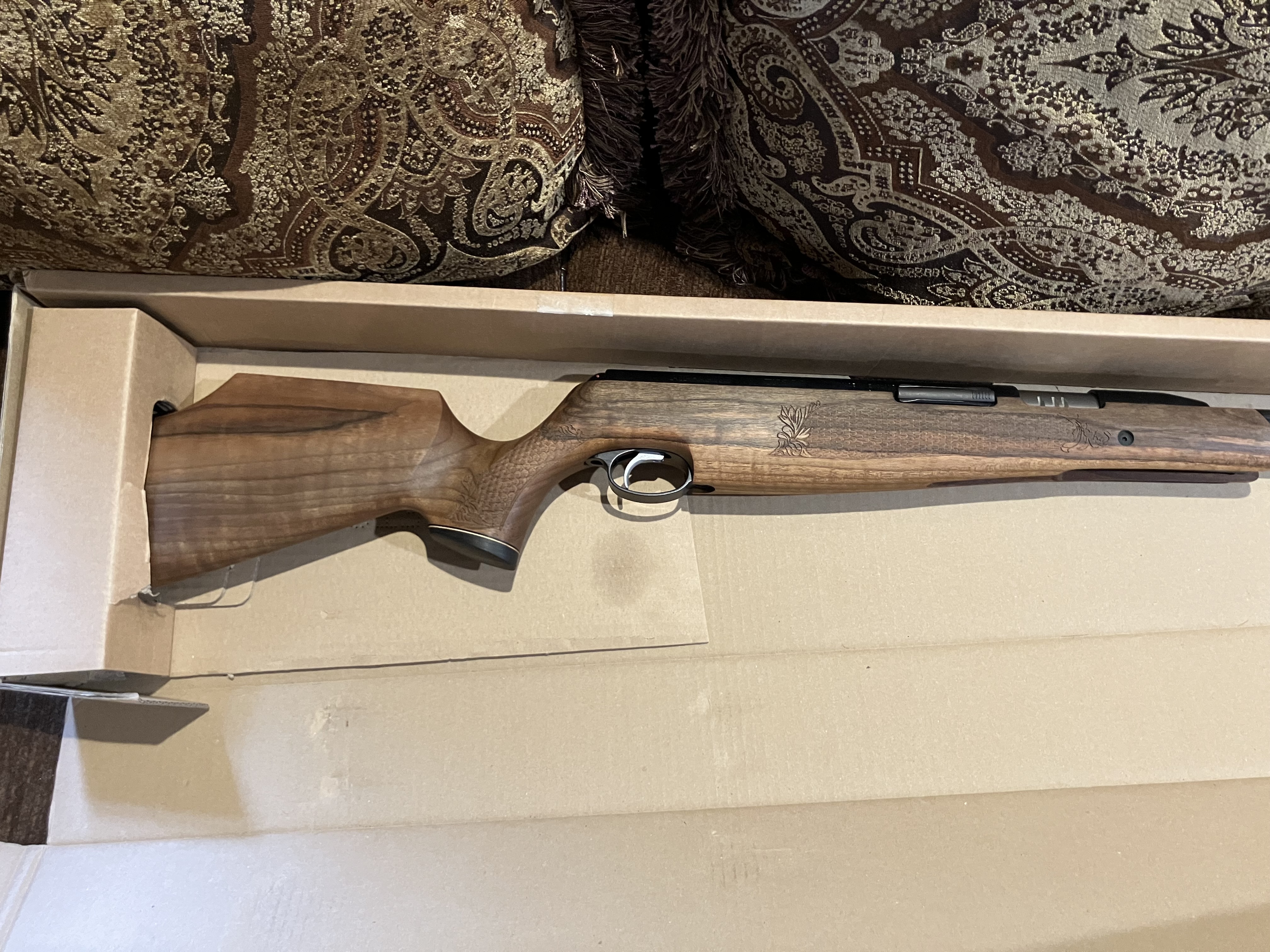

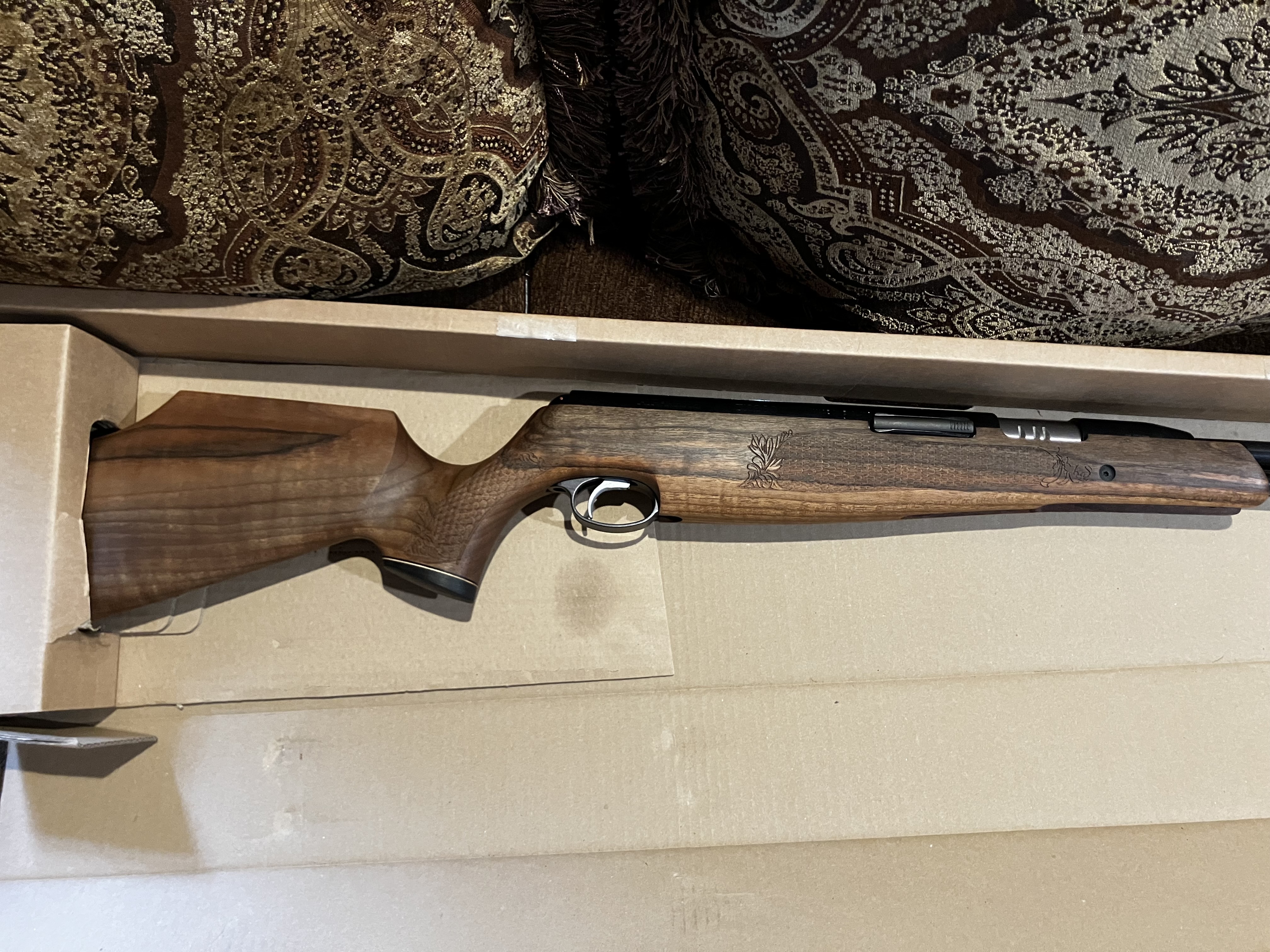

I may need to oil to darken. Image enhanced below to see what it may look like. In reality its closer to the first image
