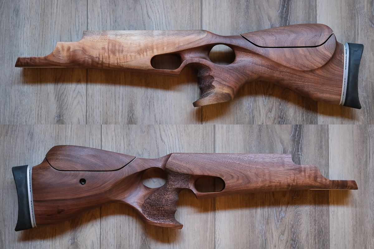

here a very unique "Blond" walnut AA TX stock that was much more plain prior to several waxing applications.

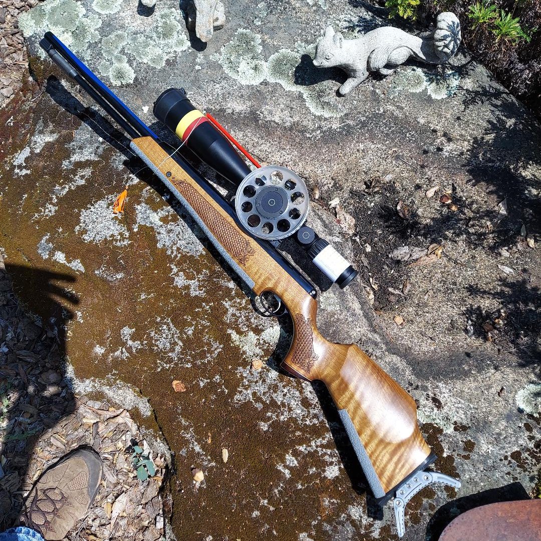

Is that grip tape along the lower edges?
What's the blue tape on the barrel?
Yes, Rubber grip tape along stocks bottom areas and Blue tape along top side of barrel for low scope glare and protecting it from rust opening/closing cocking handle ( salty sweaty hands )
* Set up as a FT rig when picture taken.

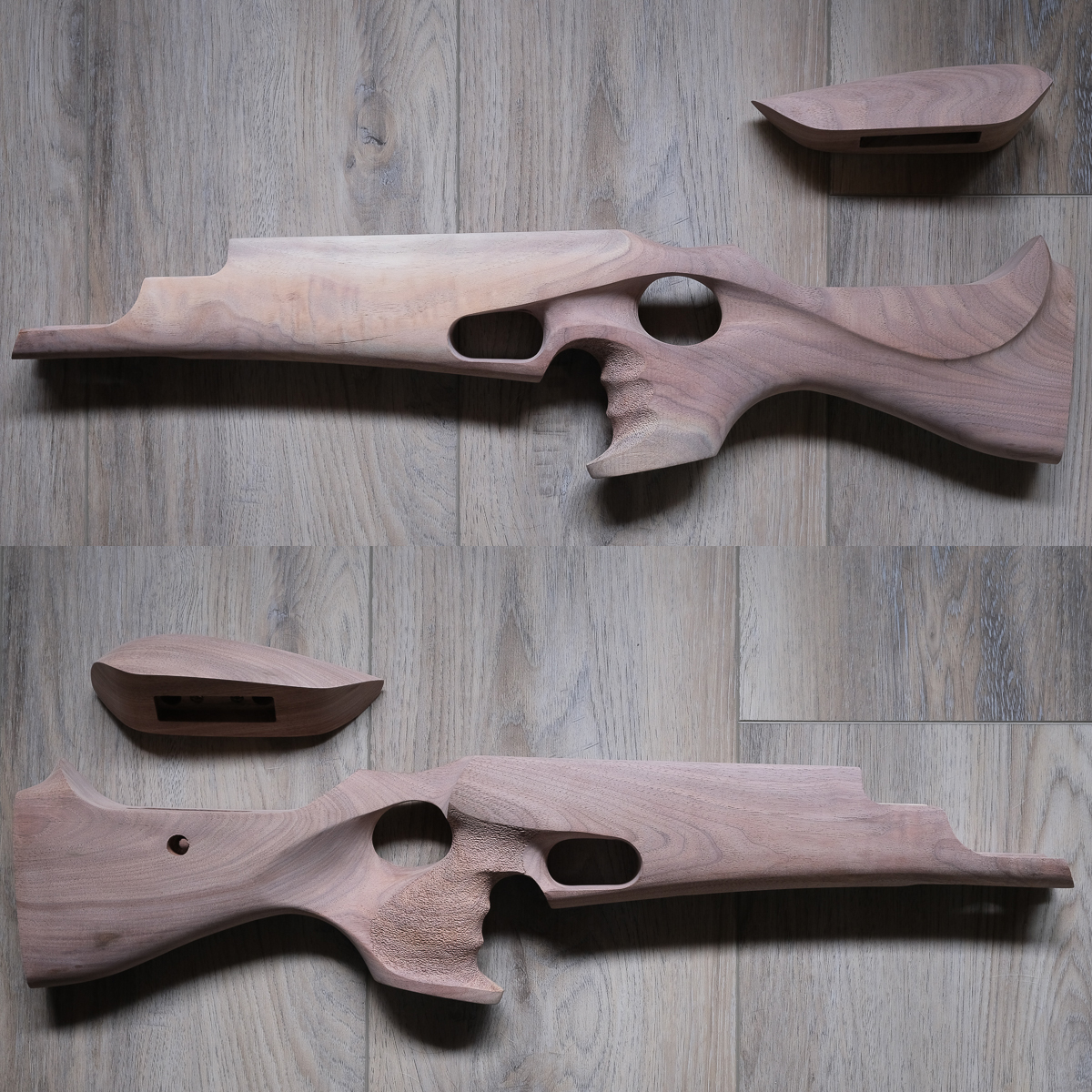

Below is another example of RLO being applied to bare walnut.. I applied 3 coats to this stock. It really accentuated the grain patterns and wood color differences.
I see mill marks, From the duplicator. 🤔
block sand that stock Down. 😉
sand them first few oil coats in and fill them pores, then do you will start to get that wood to show its potential.

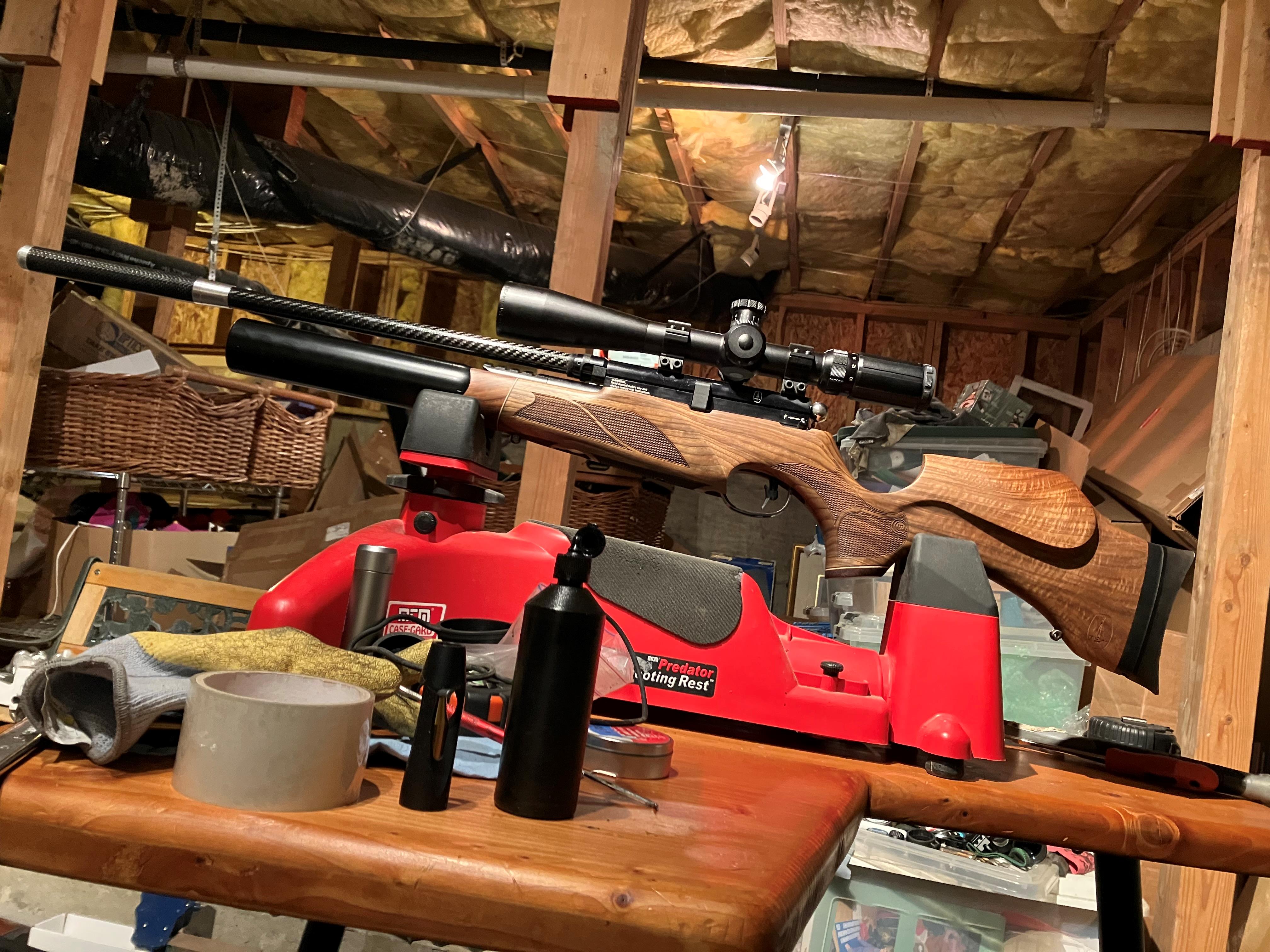

Just received a new air arms TX 200 in Walnut today. Would like to know what the expert consensus is about conditioning the stock right out of the box? It looks a little dry. Thanks for any help.
Hey Guys,
I know this is going to sound crazy, but when my BSA R10 came years ago with a beautiful Walnut stock ... it was dry and needed conditioning.
I accidentally wiped some gun oil on the stock which looked very good, so I covered the entire stock with regular gun oil - it looked fantastic and sealed the grain. Couldn't be more simple ..... I reapply about every couple years (y) .
