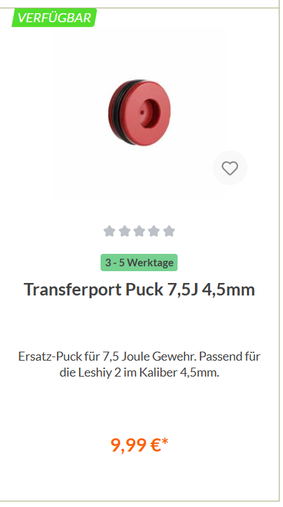

check this out- i just got an email back from the dealer and he says that in order to open the leishy2 back to original 54fpe all i have to do is turn the regulator all the way up AND drill a bigger hole in a "puck"
what the heck is a puck? not sure he called it by its german or english name but maybe you will know what a puck is..
and then when i need to bring it down all i do is put in a smaller limited puck just like it was in the first place when it was limited to 5.5fpe-

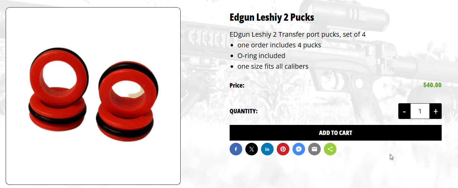

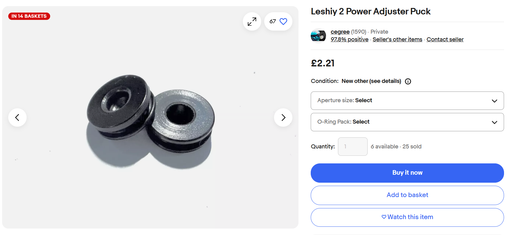

i guess a puck is that red rubber (or plastic-cant tell from the photos) valve that sits behind the pellet magazine?
i just found more info so please correct me if I'm wrong-
a puck is a transfer port and that's what he means i should drill bigger (or just buy a bigger one)

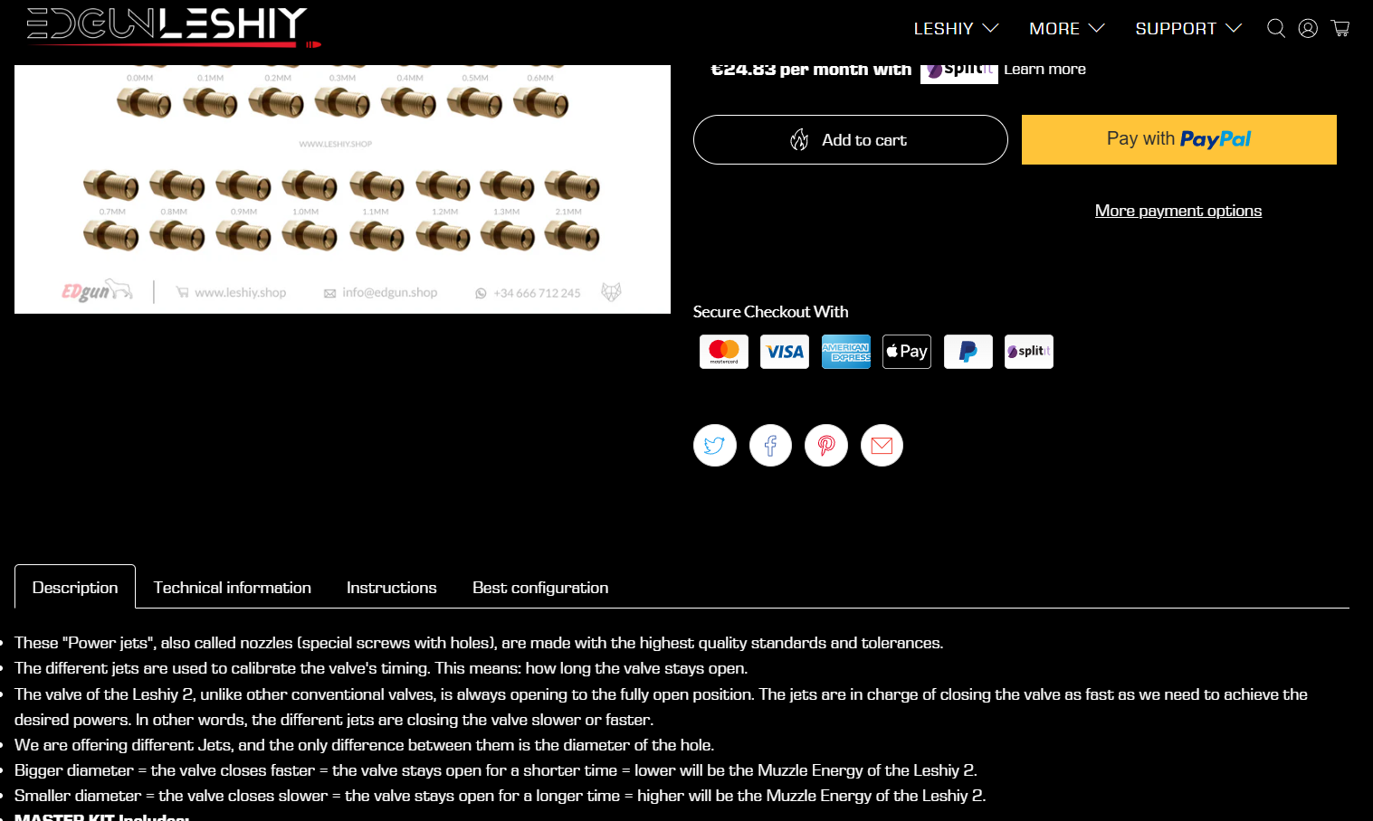

a power jet is a nozzle which limits air in the plenum to keep the valve open longer or shorter but that's not what i should drill right?
check out the pics
@grzech2005 I don't understand why you'd want an F-version and then turn it up. You could as well get a regular version then. But drilling the puck is easy, or you can just by a bigger one, it's cheap. Turning the reg is not complicated either.

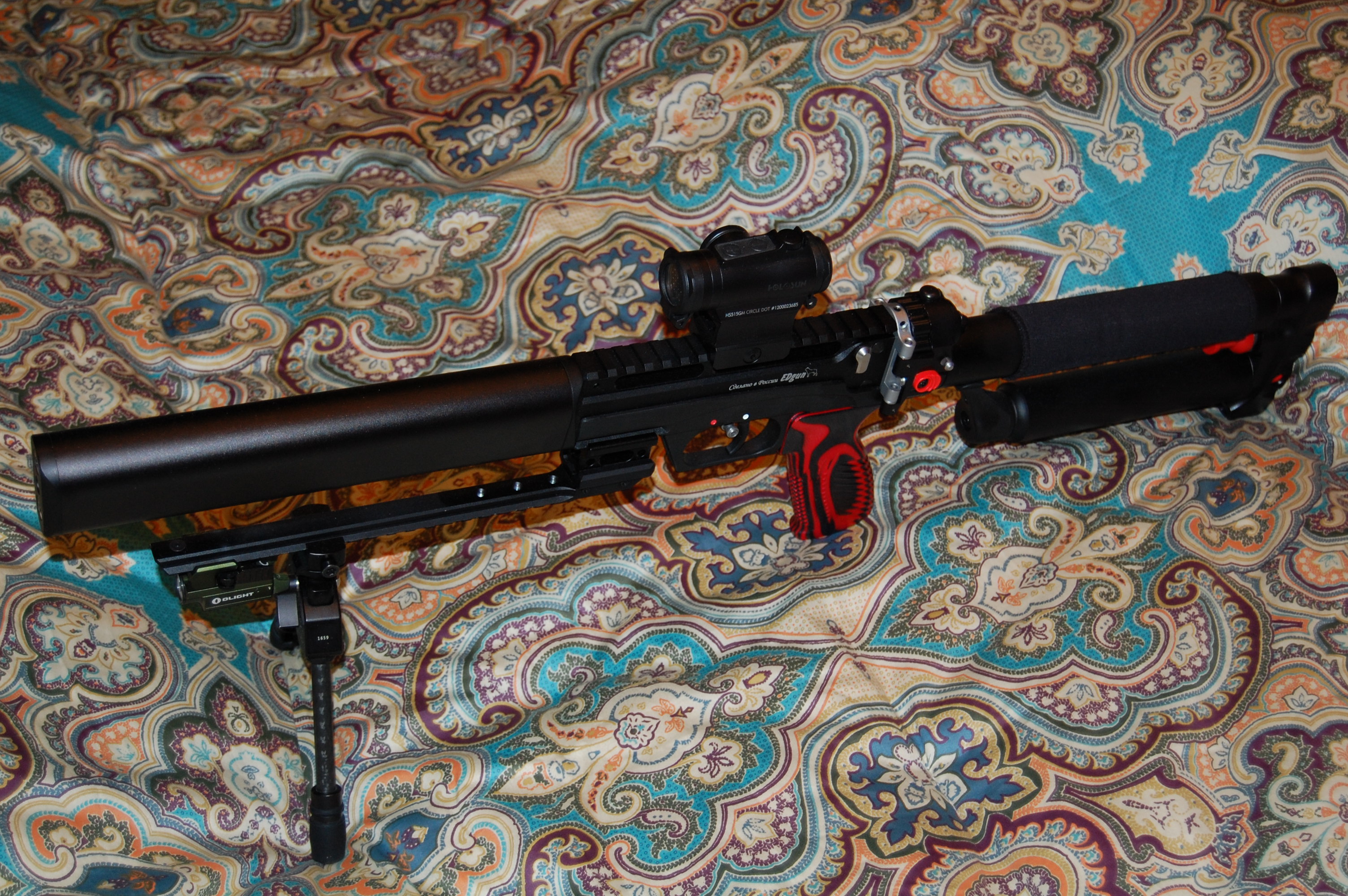

I have a 350mm .22, and a 450mm .25. I love to shoot with the guns, they are a lot of fun. Also very accurate, at least in my .25 version. The .22 is a lot more finicky (at least mine is). I'm still trying to find out what's the reason. But you can tune and change anything you like if that's your cup of tea. Mine tends to be more accurate with higher power (smaller power jets, and higher regulator).
But for the fun factor: it's the gun I currently shoot most. I always puts a smile on your face!

- changing the puck is really easy (a 3 sec job) as it's externally accessible in the rear part.

so it should not be a problem bringing my limited gun back to its original power just with the drilling of the 5.5fpe puck (the one that is inside now, the restricted german version puck) or buying original one in open power version-
-do you know which puck size that would be for the .22 cal L2?
-should i play with the power jets, have you done it with yours to change power output and which did you buy or change?

you can indeed always revert the power levels. However, you cannot undo your drilling. So you’d need a second larger one next to the small puck. So you can change. There’s just one regular size, the biggest one. This is what you need to shoot without restrictions.
I have played with my jets, but it depends on the projectiles you’d like to shoot and at what speed. I’m currently at 2x 0.4, but also because I shoot in .25 as well. For .22 the 0,7 or 0,8 jets are recommended. My advise: buy the complete set of jets, so you can experiment.

I have a 350mm .22 L2 and love it! I have not tuned mine *at all* and it shoots very well. Noise is subjective, but it's actually pretty quiet - much quieter than my 250mm .25 L2. I'm sure some massive addition would make it quieter, but that would kind of defeat the purpose, imo. It's a blast to shoot. The L2's are the most fun of any of my airguns. The hardest part is finding an appropriate scope...

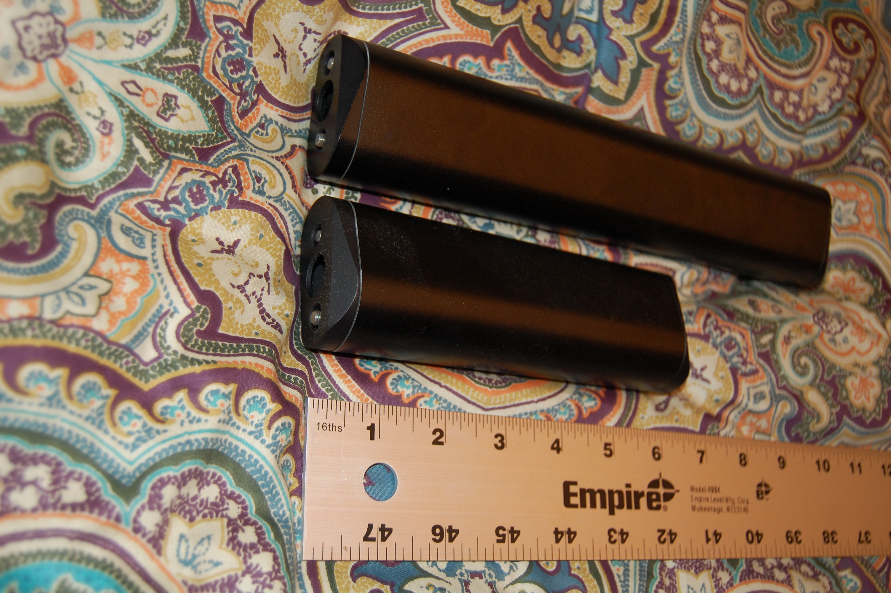

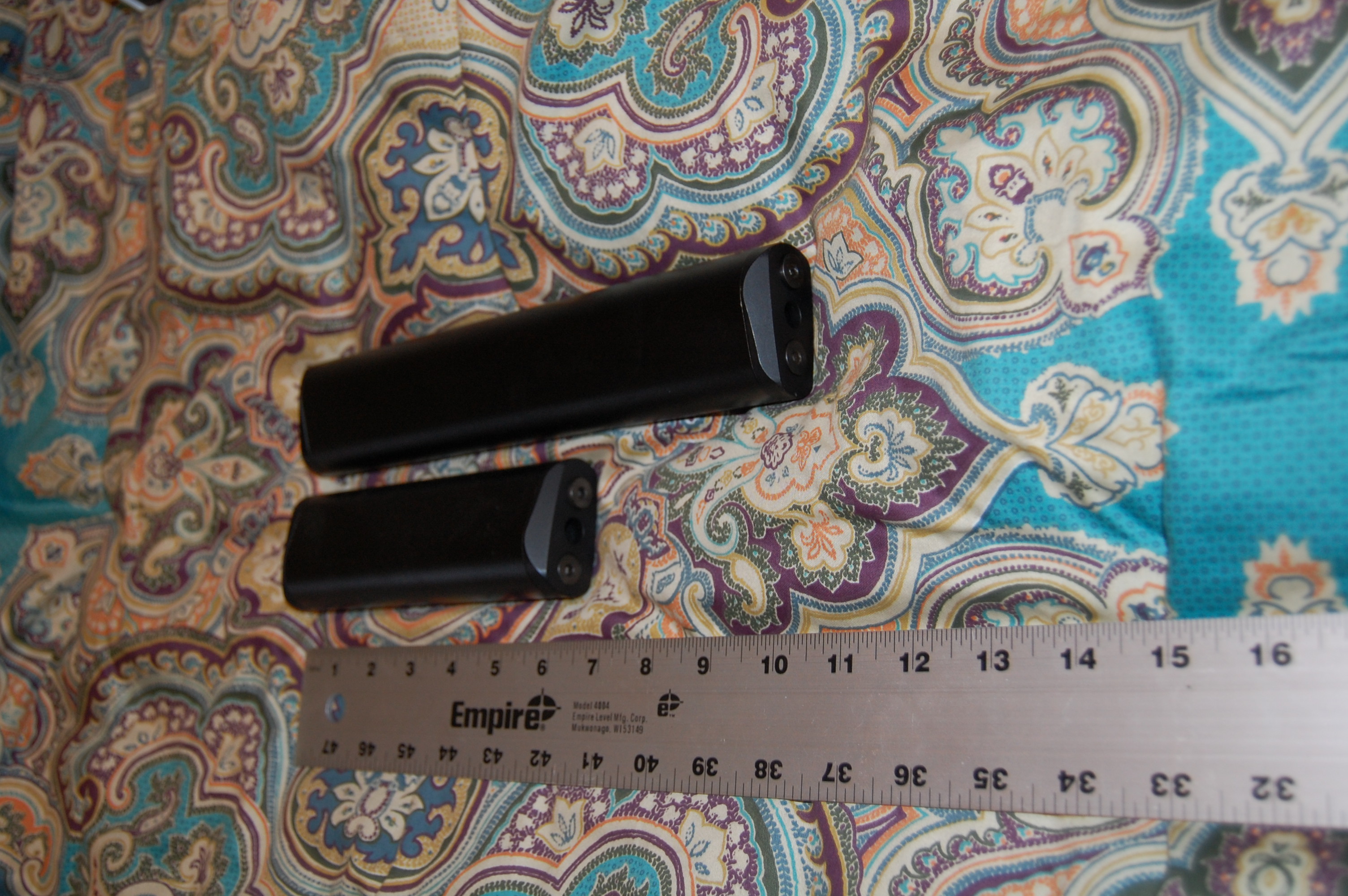

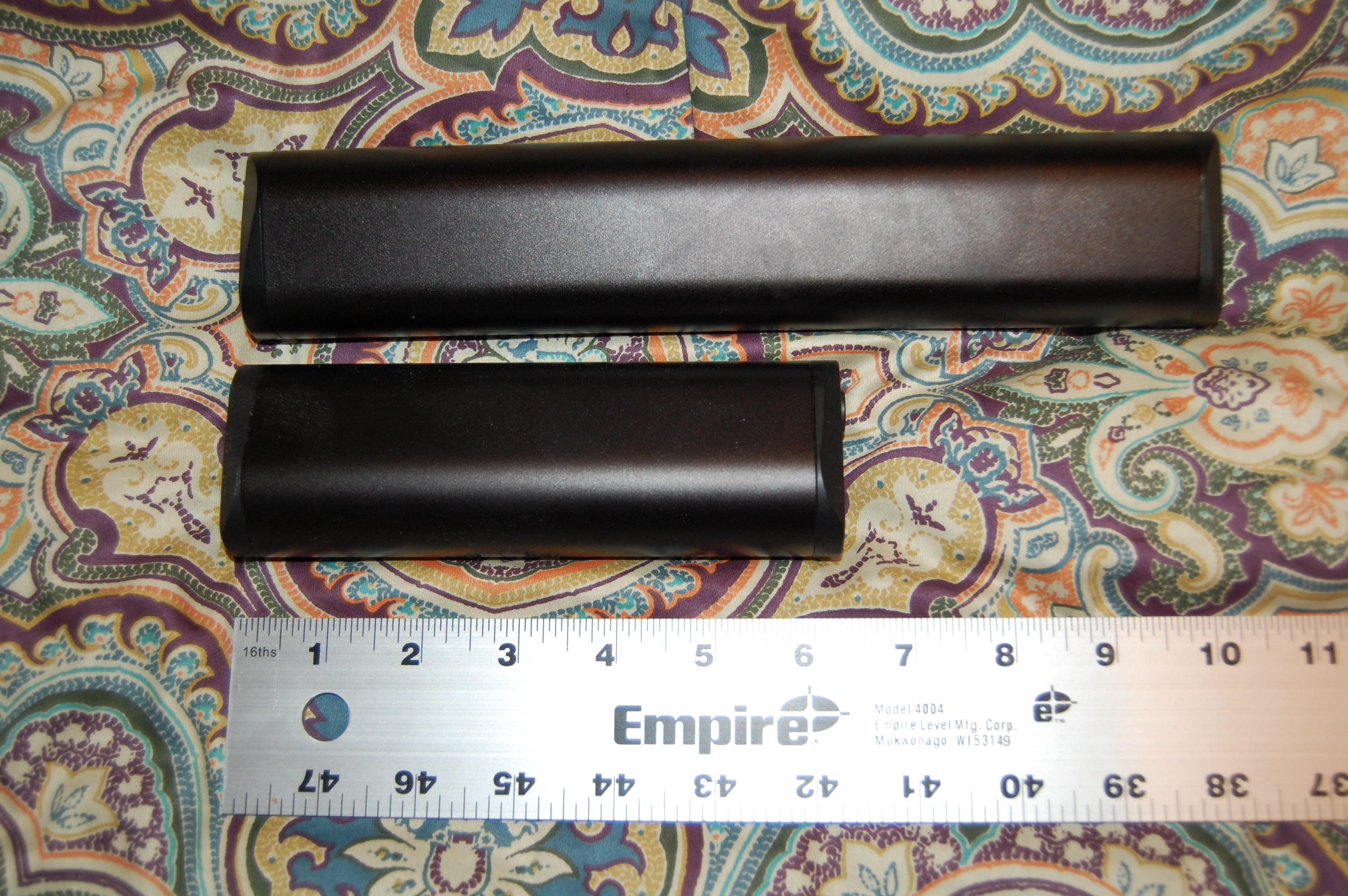

You’re making it too difficult for yourself ;-) 250 en 350mm is the barrel length. You see that in de difference of both shroud pictures: difference is exactly 4 inches or 10cm, which is the difference in barrel length. The moderator is the same for both shrouds.
wait a second! the 2 pictures from ChickenDumpling are the barrels??
i thought these are moderators (suppressors- like donnyfl and such)
so those 2 black oval tubes next to the measuring tape are the barrels with shrouds?
Just the shrouds and they have an internal moderator. The barrels and the moderators are different lengths. You can run the 350 moderator on the 250 barrel. The moderator, shroud, silencer (I use these interchangeably) are in an-all-in-one deal that goes over the respective barrel. While I still have two leshiys ... one in .22 and one in .30, I don't want to disassemble to make this more clear for you. But yes, you are over thinking this. Short barrel, short moderator. Long barrel, long moderator. Short barrel can use the longer moderator too.
