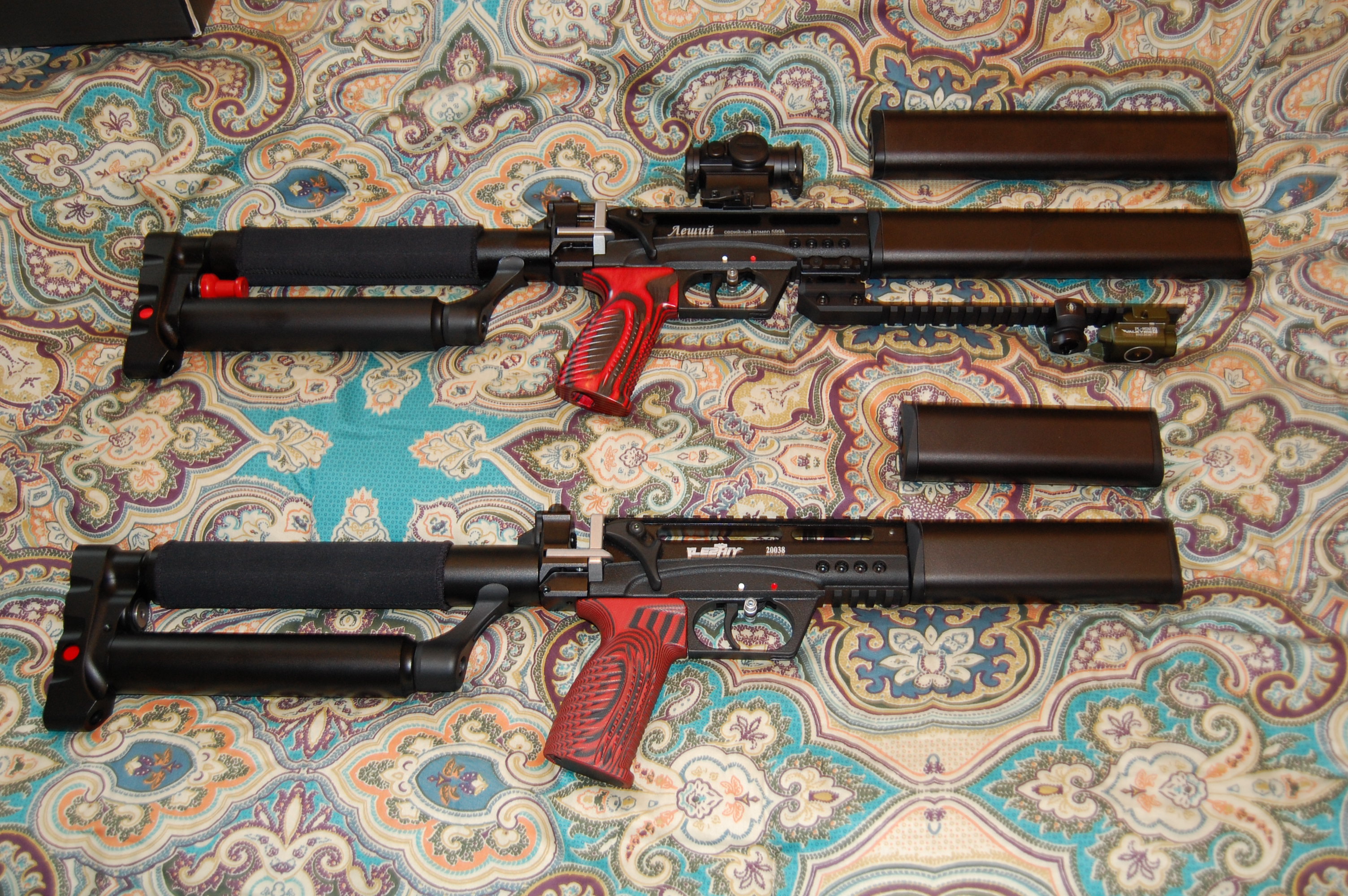

Just the shrouds and they have an internal moderator. The barrels and the moderators are different lengths. You can run the 350 moderator on the 250 barrel. The moderator, shroud, silencer (I use these interchangeably) are in an-all-in-one deal that goes over the respective barrel. While I still have two leshiys ... one in .22 and one in .30, I don't want to disassemble to make this more clear for you. But yes, you are over thinking this. Short barrel, short moderator. Long barrel, long moderator. Short barrel can use the longer moderator too.
Recommend you go to youtube and watch some of the videos ... they'll go through various configurations / disassembly. ;)
but inside these black oval shrouds sits the real barrel?
its a barrel and shroud and moderator- all in one??
got it- its a shroud and silencer that goes over the barrel so you can take that shroud down and it will expose the real barrel
and the barrel is the length of that oval black shroud- right?
The barrel is indeed in the shroud. As with any other shroud obviously. As said by @ChickenDumpling , have a look on youtube. I.e. Airbuks has a good one where he changes the standard shroud to a Donny FL one. That way you see how the components work together.

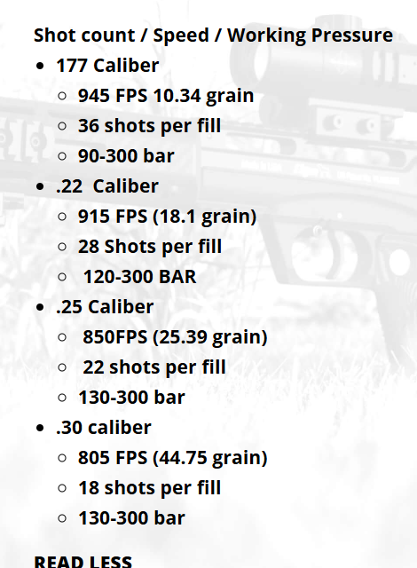

can you tell me please why are the fps so much slower when compared to a dreamline?
i see specs from edgun stating that you get 805fps with a .30cal but the dreamline gest easy around 960fps with that said caliber?
is it because of the barrel length being only 350mm instead of 600mm?
can you make the fps higher then those edgun specs? maybe the specs are moderate tunes and one can crank it up much higher?
i knw you have .22 but what is your highest fps that you got out of it?
edgun specs says .22 will reach 915fps with 18.1gr pellet..

edgun specs says thaat you will reach 915fps with 18.1gr pellet with your 350mm barrel..
have you reached higher fps somehow and how much?
@grzech2005 those comparisons make little sense, as it depends on how you tune the gun. The above figures seem to be based on a regulator pressure of 120 bar. When tuning my gun I was able to reach a max speed of 920 fps with 25,4 gr pellets. This was with zero size jets, a regulator pressure of 165 bar and a 350mm barrel. Not a sane tune, but I was trying to find the max. I reduced it after to 870 fps with 0.4 jets and about 145 bar reg.
Reactions: grzech2005
thanks- you answered my question...
that would be 48fpe/65j for the 25.4gr at 920fps (with "0" jet and reg at 165) which is a whooping 40%! :eek:more then the advertised 34fpe/46j
wow- that is higher then the 30fpe/41j advertised for the dreamline .22cl with 500mm barrel..
so if i get the gun i know i can reach your values by using "0" jets and reg at 165 out of the .22cal 350mm model

edgun site is probably correct. But they use a 120 bar tune. I use a 165 bar setting. That's not the same, and obviously gives different pellet speeds. You could also summarize is as follows: Leshiy 2 provides more power then you would probably use in practice. so I wouldn't worry about it.
