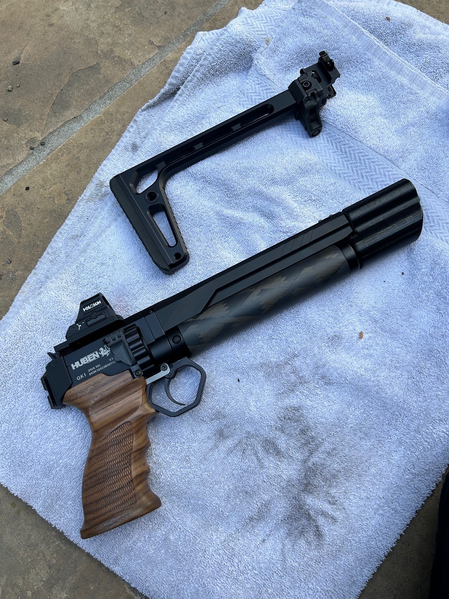

I have the GK1 .25 and never had an air dump. Like all PCP's if you want to have no issues always shoot them once a month or so as the longer you never shoot them the seals could go bad. When the weather has been to bad to shoot is when I have dry fired it with no issues at all.
My compressor only fills to 4500 PSI and I use that to fill my air tank to 4500 PSI; that is not a problem at all. When I go to the range I can shoot all day and my tank will still be at about 3800 PSI. The GK1 is very reliable as long as you shoot pellets. The ones whom have some issues due to jabs are mostly when they use slugs as the GK1 you need to get just the right slut diameter and to me it is not worth the hassle as this is just a pistol so why bother? I have shot thousands of rounds without any problems. I just one day at the range I went thru about 750 rounds and would have done more if I could rapid fire. The accuracy is amazing and just the best pistol out there. I sold all my other air pistols after getting the GK1 as I could not find time to shoot them.
I attached a pic of my GK1 with the shorty moderator you can get from one of the people on the forum and the other is my first day at the range where I sighted the green dot at 25 yards then used the one target for the entire day, repasting new bullseye stickers on every single range break because all 5 bullseyes were filled with holes in each round. Oh yes we shot 750 rounds that day!
