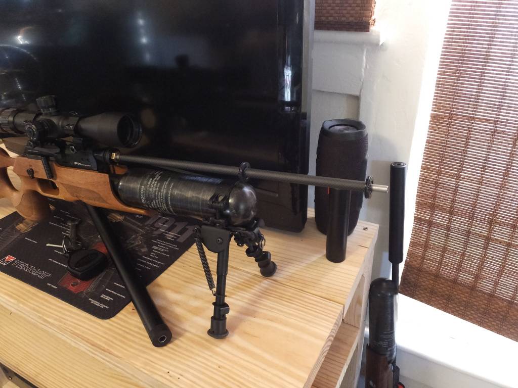

Tuning Continuum added 500mm superior heavey with all Humma TP.
Cleaned the barrel, then 100 strokes with flitz. Swapped 380 for the 500. Then ran a tank of air with several slugs a d 18.13s. The 21 hybrids looked good as well as the 23gr Neilson but only 30 yards. Reg set at 130bar the pellet setting. Now someone must be doing this any hints at reg setting or other tips to save a bit of ammo. Will dig the crony out next time to check speads. Will need to pick up a new Crown case and?? Have the ATN 5-20 on the gun till the M3 gets here.
