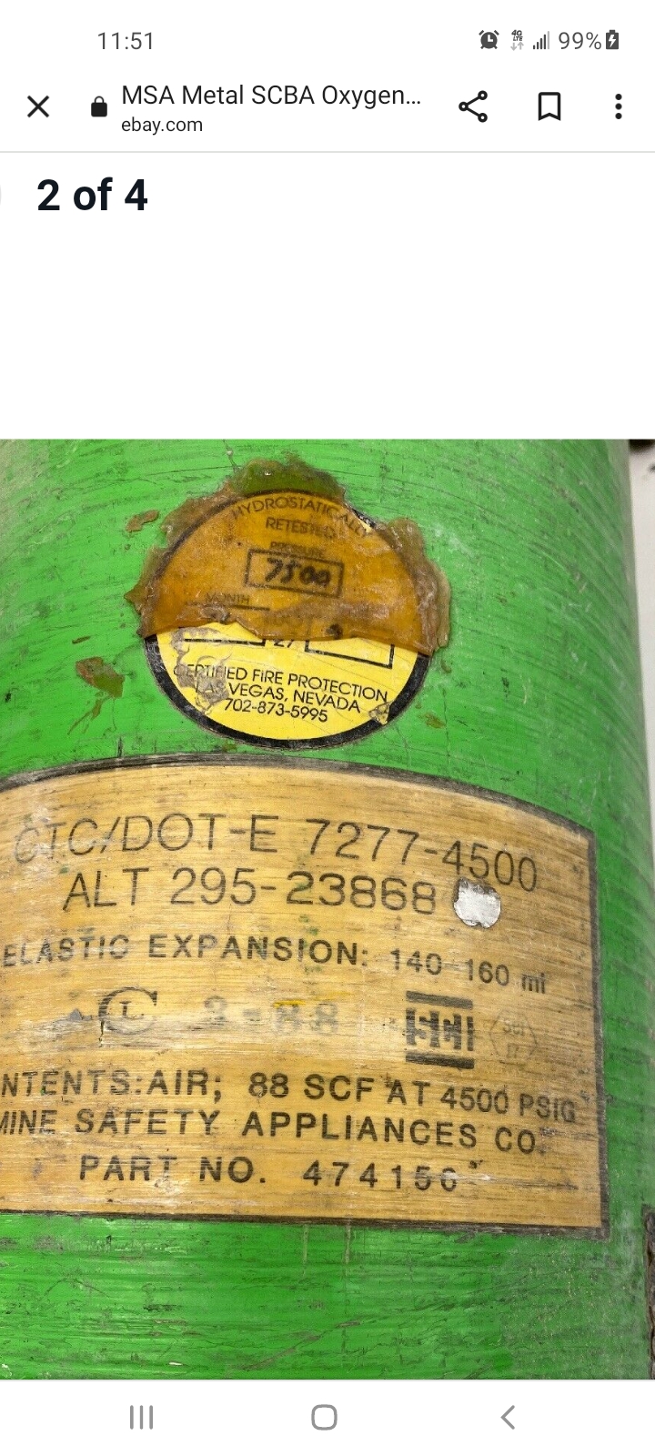

Lol. Point taken. Thank you everyone for your input. I have attached a picture of the tank I was asking about.
That IS the TEST pressure only. Hydrotesting usually brings the pressure up to 3 times maximum gauge pressure & then inspected for deformities. It's NOT the working pressure rating. Look at the BOTTOM of the label. It says: contents: AIR (not oxygen) @ 4500psi. Do you have a picture of the tank valve and gauge or does it not have one? I'm not convinced that's an oxygen tank. I think it's an SCBA! Doesn't look like steel on the outside. Looks like carbon fiber. Post a full picture. I can probably help you out. By the way, tank was manufactured in March of 1988 so no shop will fill or even hydro!

No worries. The thing that attracted me to it was that it's steel. Which is questionable at this point. At least steel has no expiration on it's lifespan, just as long as it passes a visual and hydro test. The 2 tanks I have now are both Scott 30 min. SCBA's 06 and 08. Still waiting to hear if the recertification to 30yr. is ever going to happen? Again thank you so much for all the help.
