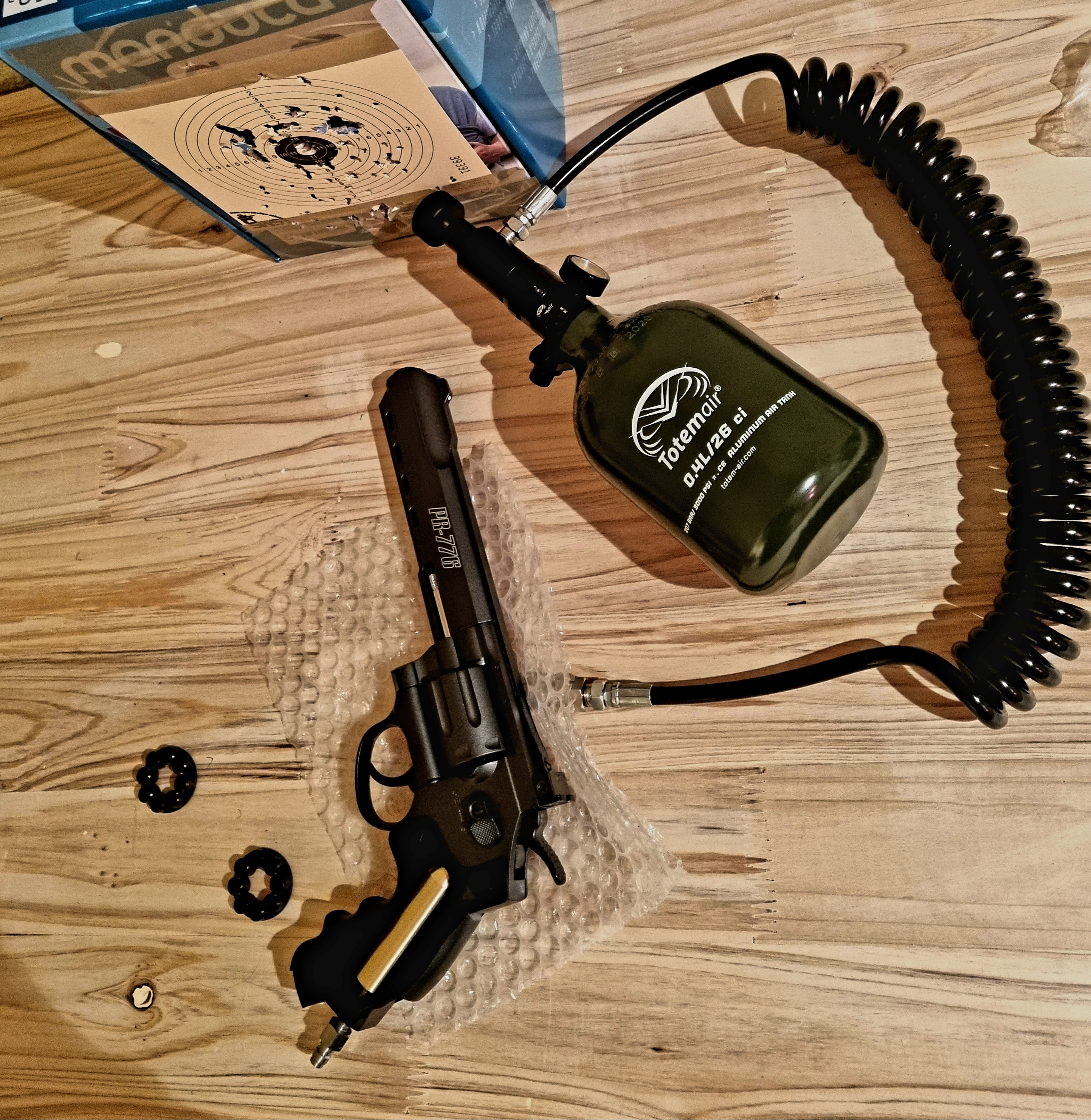

Base: The gun
As base I used a Gamo PR-776 Co2 Revolver in .177 (it’s quite a standard revolver, you can find under many labels and names). It`s one of the „typical“ 100-bucks-Revolvers, so nothing too great, but it has a rifled barrel.
The heart of the project: The “co2 to hpa converter”
You can find these all over the internet and purchase them for 15 – 20 bucks. I assume they all come from the same one or two factorys in China, as I ordered several and didn’t find any differences. What you get is a pretty well made metal cylinder (empty on the inside) and a filling-adapter with a thread. The thread wont go into the adapter (pictures are a bit misleading there), only the tip goes into the cylinder (there’s a sealing ring on the inside).
Cylinder. First thing you notice: The cylinder is a look-alike of a co2-cartridge – as long as you try to put it in your gun. Then you will see, that there’s a small but important difference. The co2-cartdridge is rounded, while the lower end of the cylinder isn’t. It ends in a “corner”. So it can be difficult to fit it in the magazine of some airguns. In my case it was necessary to adjust it. I saw a picture of somebody, starting to adjust the magazine and take of material of the backend of the adapter. Not a good idea, because it’s way more simple to adjust the “bottleneck”, so the upper end, of the adapter. I just took some sandingpaper and filed away maybe 1mm. Then the adapter fitted into the magazine. It still need’s a little bit of room, so it can be pressed against the valve. It is made of aluminum, so it is quite easy and there’s plenty of material. In my project it was necessary to put on an additional o-ring on the top of my adapter, so it connected to the valve without pressure loss sideways. Here’s a picture of the cylinder next to the magazine of a Umarex P08 and fitted in (gonna be my next conversion I think, as I want to try converting a BB gun as well).
Filling adapter. There are two different threads that can be ordered. A smaller one ¼-20 and a wider one m12*1. A lot of airguns have one type or the other. It’s initially used for a screw, that presses your co2-cartridge against the valve, to open it and power your gun. This screw has to be removed (should be easy, as it’s a part for maintance and can be replaced) and replaced by the filling adapter. If none of this two is fitting, I personally would order the smaller ¼-20 and a screw tap. But I never tried this actually.
I then used a pipe wrench to screw in the filling adapter into the cylinder using very little force. I just screwed it in by hand and then used the pipe wrench for another 1/4 to 1/3 turn.

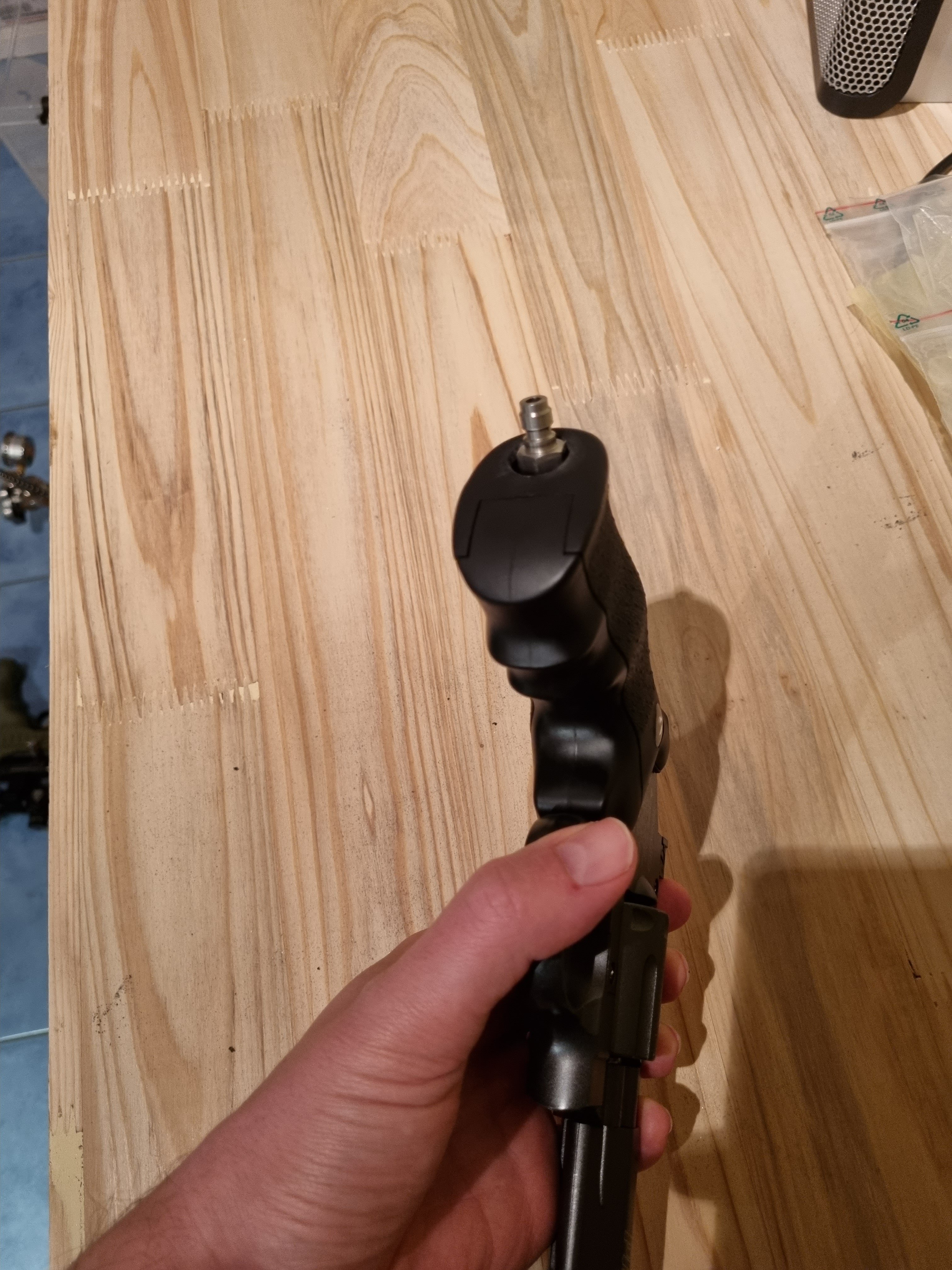

After that, I adjusted the grips of the revolver by drilling a 15mm hole in them for the adapter. That's it

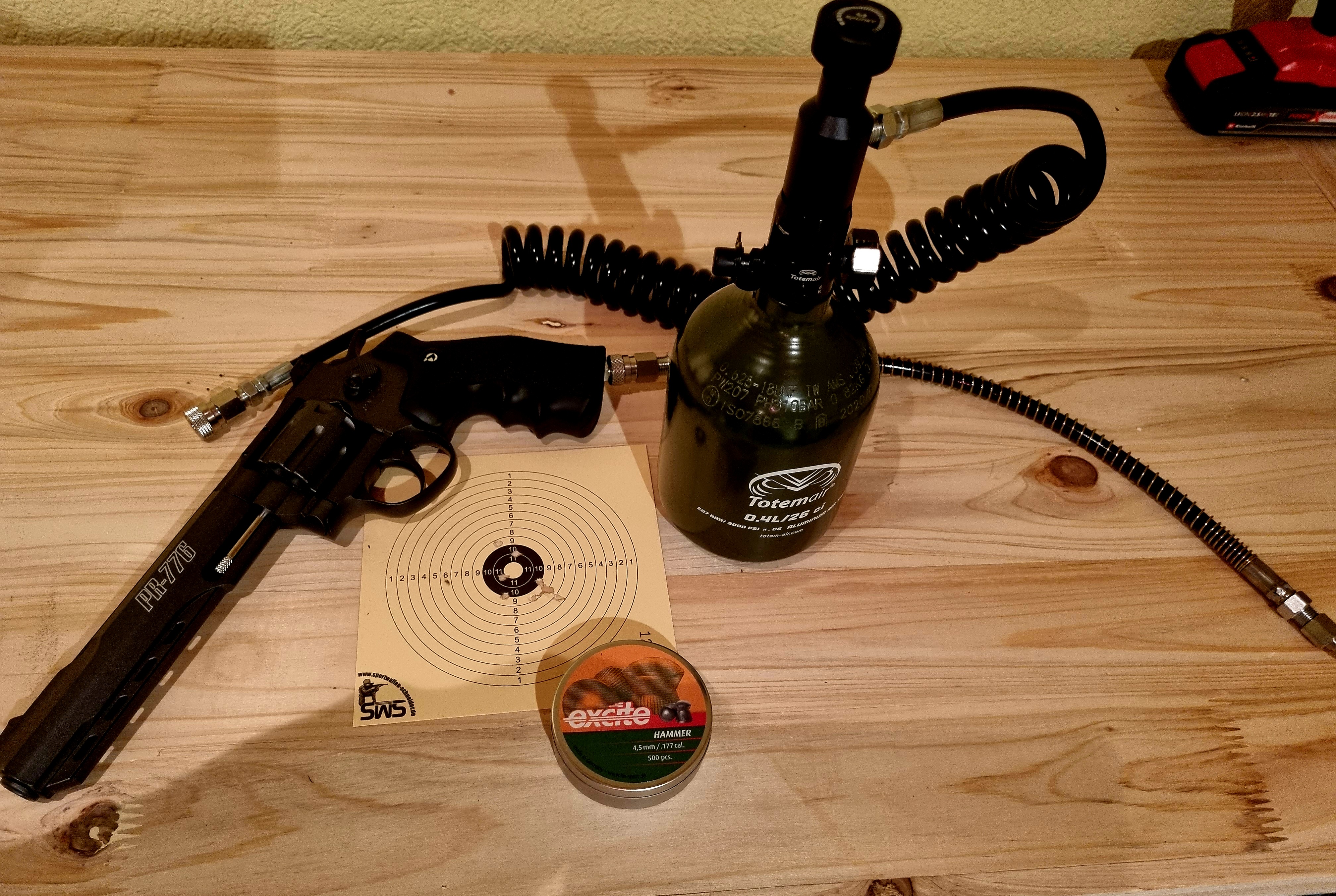

I adjusted the shims in the hpa-tank regulator to 1050 PSI, reaching the desired speed. That results in pretty consistent 295 fps with a variety of just +- 8fps.

The bigger issue is getting the pressured air into your home. I already own a compressor and a big 610 cui compressed air cylinder, so it’s not that much of a problem. This is my yong heng setup I use for my other pcp guns. If somebody lives near a diving shop, firefighters, paintball area, it’s also easy to get pressured air.
*The system limits you to one magazine. So changing to a new magazine after firing out the first one is impossible – doesn’t matter for revolvers or other models, where co2 tanks and magazine are separated of course.
*No ”quickdraw”-drills or fancy dynamic stuff. The hose is in the way, so its not possible to do draw and quickfire drills or stuff like that.

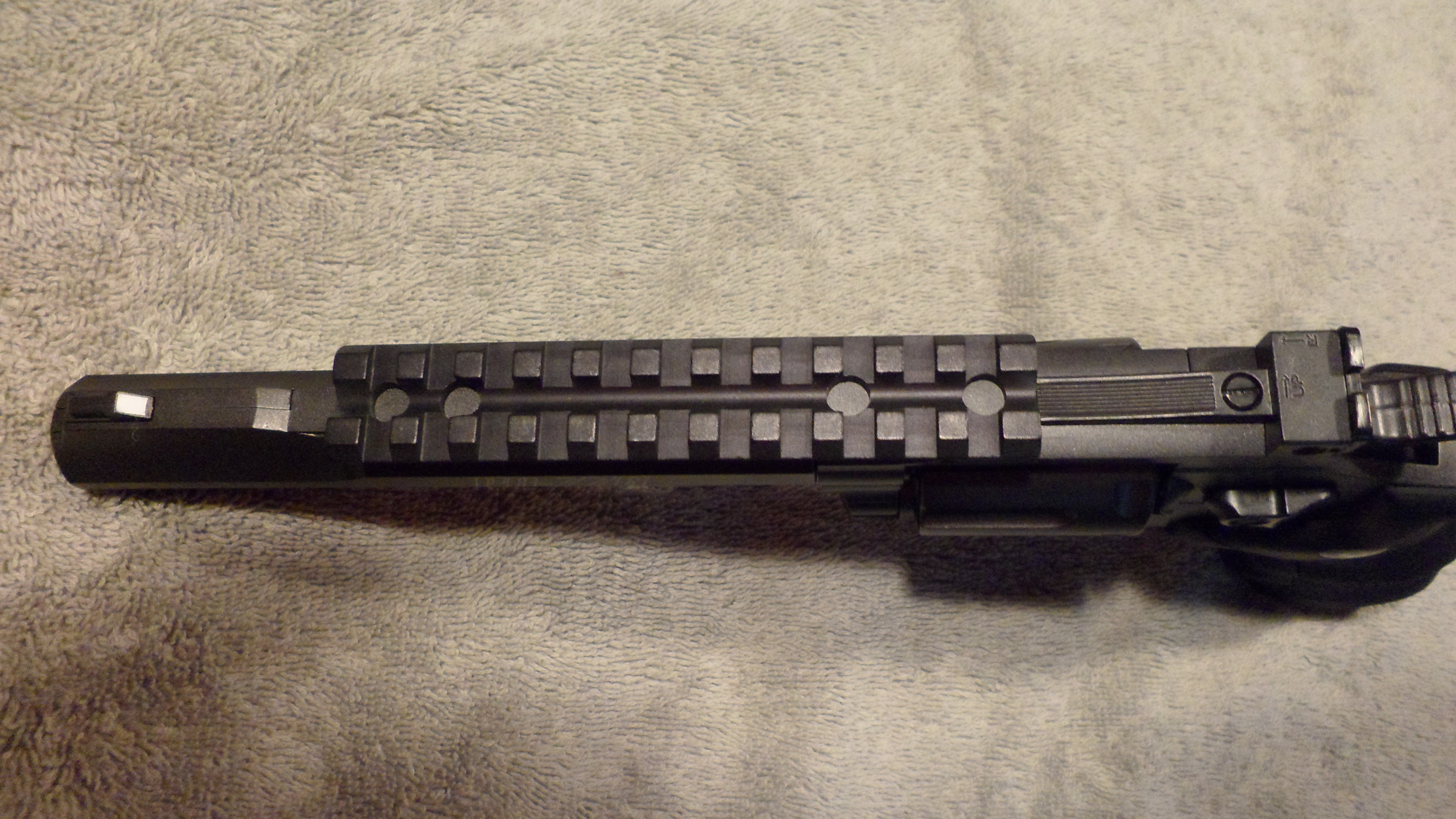

a bit of a hand scratcher but okay i am a tinkerer
so, you need to add a weaver rail and it is easy if you can do that
cut a slot dead center in a weaver base the width of the barrel stripe and epoxy it on than you can add a red dot or reflex sight
pick one that is cut out down the middle so the open sight still work
you can cut the slot with a table saw or i use a router and table with and mill bit
Reactions: Jarnold
Looks pretty decent to me, well done! There actually is a rail from Gamo itself - it will also fit the Crosman SR357 (same frame obviously).
But atm I have great fun shooting it with open sights (already got a rail and a reddot on my Walther CP88 competition 6"). I am thinking about designing and printing out a little LPA/glassfiber-holder with my 3d-printer to give it a "glowing" frontsight, also to cope with the shots going way too high. If I aim for the center on 9 yards, the shots nearly fly over the top of the target. 3 inches too high :rolleyes: But besides that, I like the gun a lot.

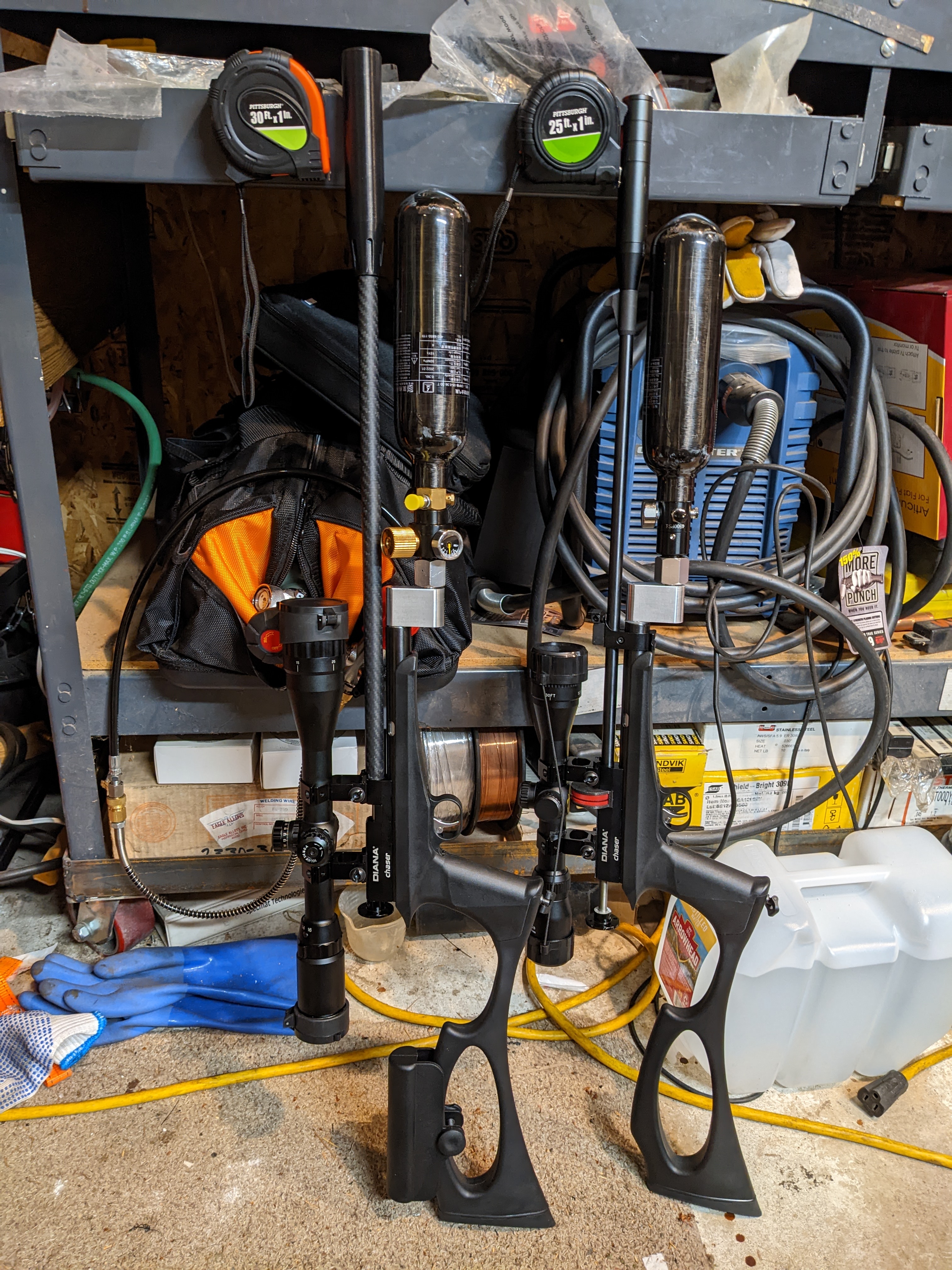

Having run or converted several Co2 guns to PCP, you're likely getting more power increase than you think. 1200 PSI is what Co2 produces in hot temperatures, but 1200 PSI air produces more velocity than 1200 PSI Co2. The reason you feel you haven't gotten much velocity increase is because Co2 report is louder than air. At 1200 PSI air you're probably getting 10-25% more velocity than on Co2 at 90 degrees F; yet not as loud report.
Even at the same pressure, air should give you a velocity increase compared to CO2.
I am sure I measured the velocity at some point, but don/t remember it now.
I have a Chaser in .177 that I converted to HPA and with a 1200psi reg I get 850fps for over 150shots 360cc tank
the best it ever did with co2 was about 650 fps on a Hot day

I have been working on my Chaser .22 HPA conversion for about a month. I wrapped it up last week and it works better than expected! I'm so curious about the improved power that I bought an FX chronograph yesterday (which is more than the cost of the HPA conversion) to do some testing on it but it's been too cold to put it to use. So far, at 23 yards I think I have about a 2 inch group going on my metal target. It may be better than that when the wind stops blowing and I can test it on paper. Honestly, it's way better than I thought it would be. I bought some JSB Exact Jumbo Monsters 25.39 gr and they hit with some force! I'll keep you posted an put together a parts list with some links and you can decide if it's worth doing to yours. It's a chaser rifle, not the pistol.
Reactions: Jarnold
Go to Froggy's site on ETSY for the drop block, Aliexpress for the bottle and reg and Carm for good magazines
Nice work on those. Tell me a bit about the barrel on the one on the left. I'd like to change my silencer on mine away from the factory installed one that's on the barrel but I don't know how to get it off.
Also, where did you find the cheek riser?
Froggy's is the place for the drop blocks. You can find him on etsy and ebay too.
Froggy's also sells a heavier hammer spring. I tried it an found it pretty stiff but I have also done another spring tensioning mod to mine so maybe it was overkill. I IM'd him through the froggysairguns.com chat and he got right back to me with some tank and valve suggestions.
I got my bottle .45l bottle and 1800 PSI valve from amazon. If I buy another bottle I will get a slightly smaller one. It works great on the bipod and gets 100+ shots, its just a bit heavy up front off hand.
The gun specs say it shoots 500fps out of the box with Co2. I don't know if I ever achieved that speed. If I did, it was with Barracuda Greens.
I just took some shots with the chrono and here's what I came up with... one magazine with each of these 2 pellets:
JSB 18.13 - 670fps - 18.1 ft lbs -
JSB 15.89 - 704fps - 17.5 ft lbs -
Not mind blowing but still decent pesting power for the investment.
It's still too cold to set up targets to show the accuracy but it's fine for my needs so far.
