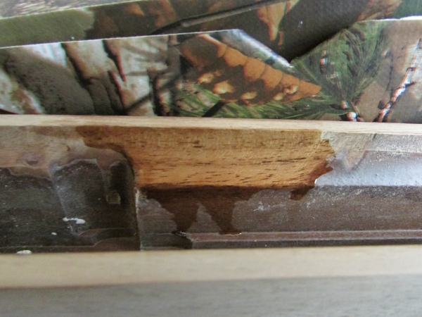

The same feller that gave me the 760-D Pumpmaster his buddy picked out of the trash while out junkin' gave me a Hatsan model 95 stock that needed some TLC. I liked the Turkish walnut better than the spray-stained 1000x stock. But I like the Monte Carlo style of the 1000x stock better. So at this point, I'm going to redo both. The 1000x will be re-stained with " medium walnut" Danish oil. It's looking real close to the Turkish walnut. Especially with some Tru-Oil over it. I know the Danish Oil has varnish mixed in, but the honey/maple syrup color of the Tru-Oil would get it closer to the right tone, I think? And even though mineral spirits will thin most stains, it will not remove it once dried. But it will cut the shine to satin, and get the dirt out of the surface.

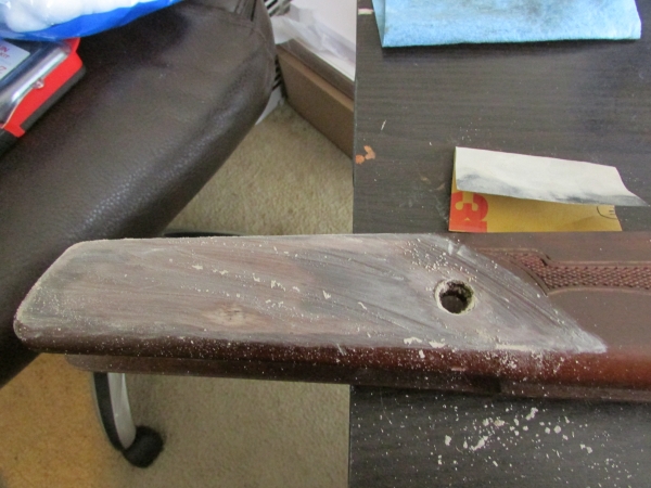

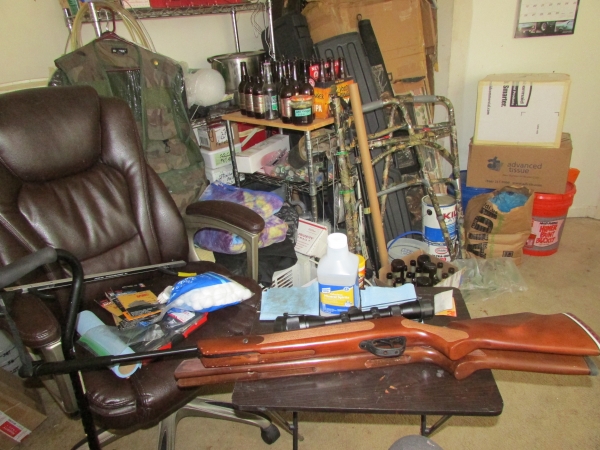

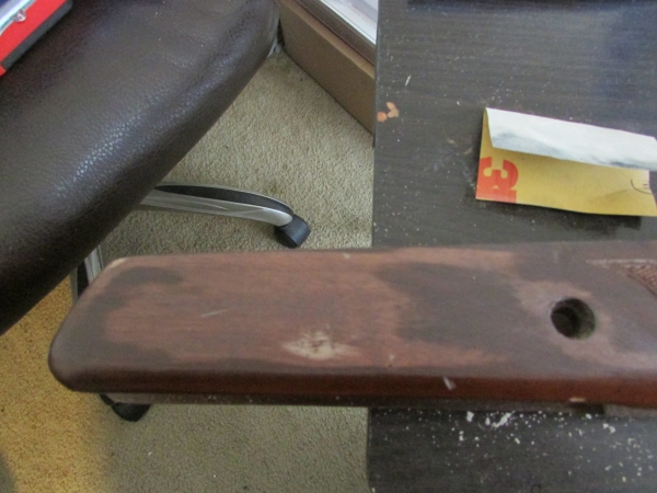

So I sanded a couple spots with 400-grit emery paper, after scrubbing with mineral spirits and a cotton ball;

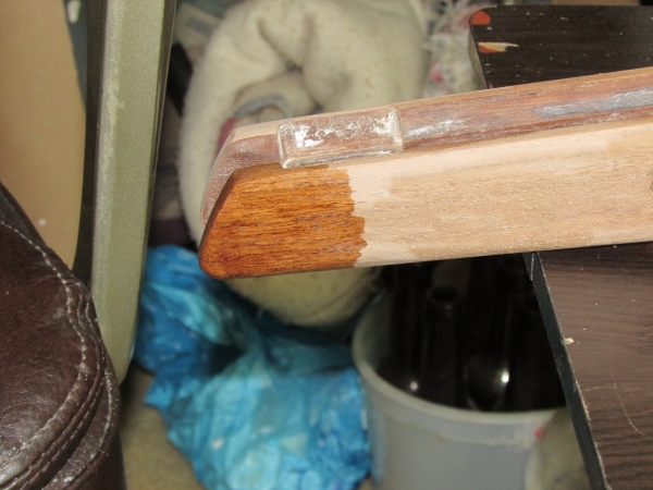

Sanded a couple spots to see the actual wood;
​And the visible results;

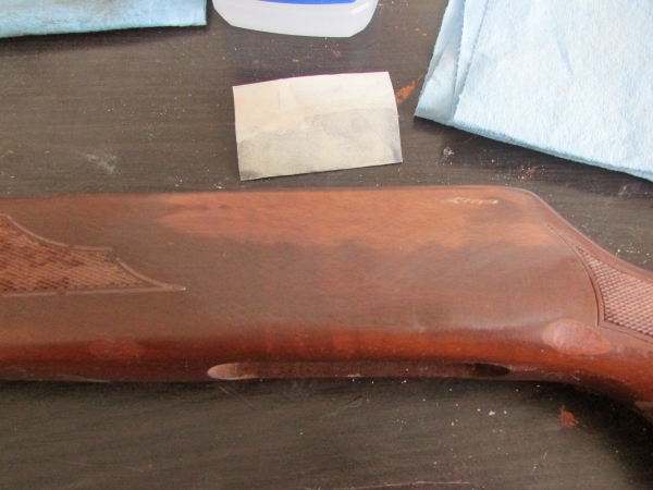

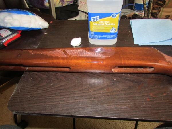

And here, comparing the 1000x to the 95 stock on the bottom;
Well, after some more sanding, my 95 stock looks lighter than yours;

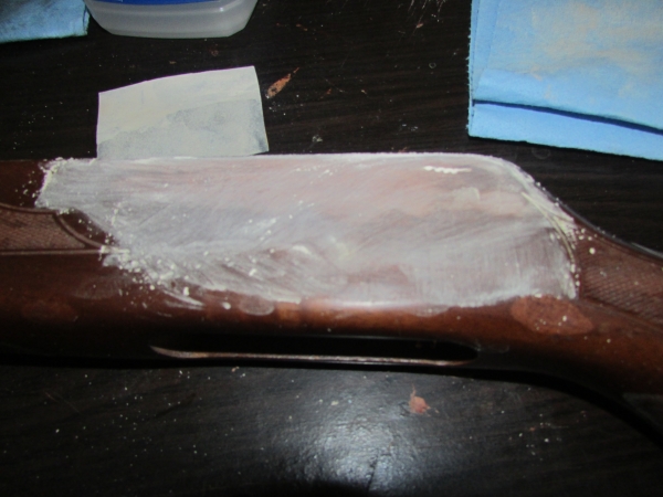

And a bear to sand down through 2 layers of stain. So I got a quart of this paste Strip X;
​Ordered the stripper, brass brushes and blue towels from Walmart, as I have no car atm. So next week I can finish getting it down to bare wood for refitting.

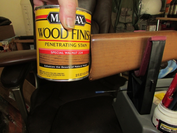

And since I have Minwax oil stain #224, " special walnut" that closely matches the Crosman stain on my 760 v1, I'm thinking my Benjamin Trail .25 would look great in that color;

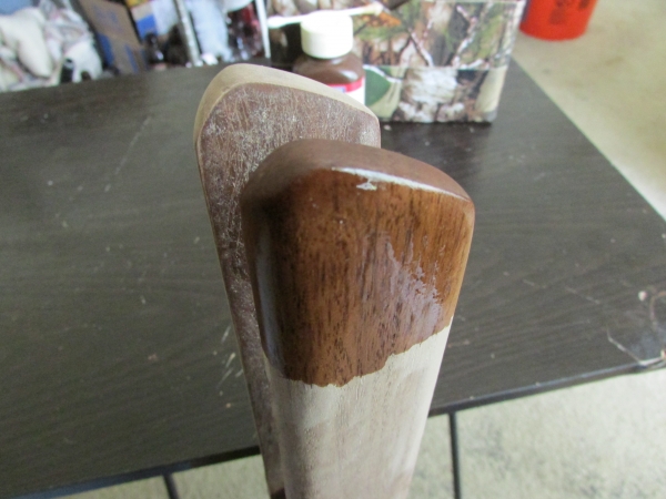

Okay, I'm long overdue for an update. I got the stripping, brushing, etc done on the 95 stock. Cleaned up a couple areas on the 95 stock with a Dremel and a ss wire wheel to fresh wood. Then did a color test with Tru-Oil and a Qtip. The wood seems to have a medium walnut tone naturally. So far as the lighter colored Turkish walnut is concerned. It has a nutty amber glow when the flash is used. And the 3 coats of sealer and stains they used filled the pores and make a nice contrast. I can't wait to see what the grain streaks look like! I'm working on part 2 video, but here's a few pics...

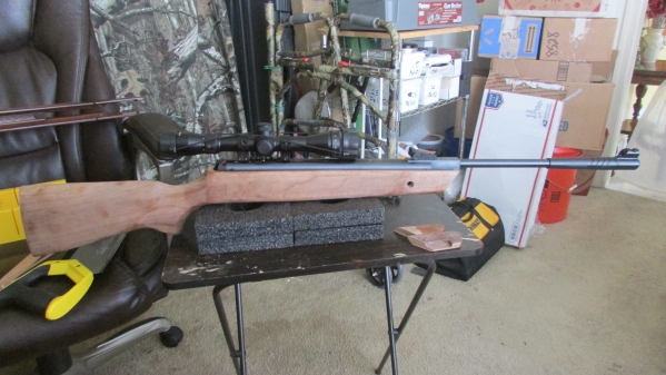

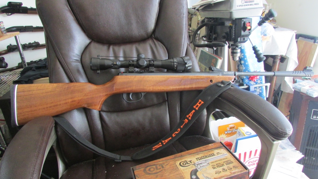

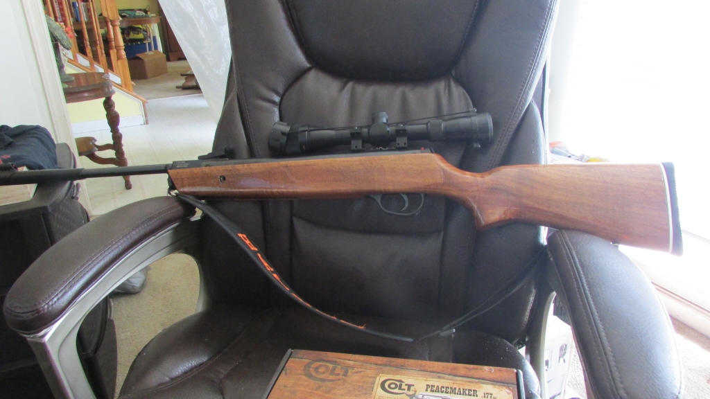

The striker 1000 dropped right in. But a bit lower on the back than I would've preferred. There's a right angled black -plastic piece that fell out. I think it replaces that U-shaped metal part the rear stock/trigger guard bolt goes through on others like Benjamin? So that might be what holds the back of the action tube up? I'll have to play around with it and see?
