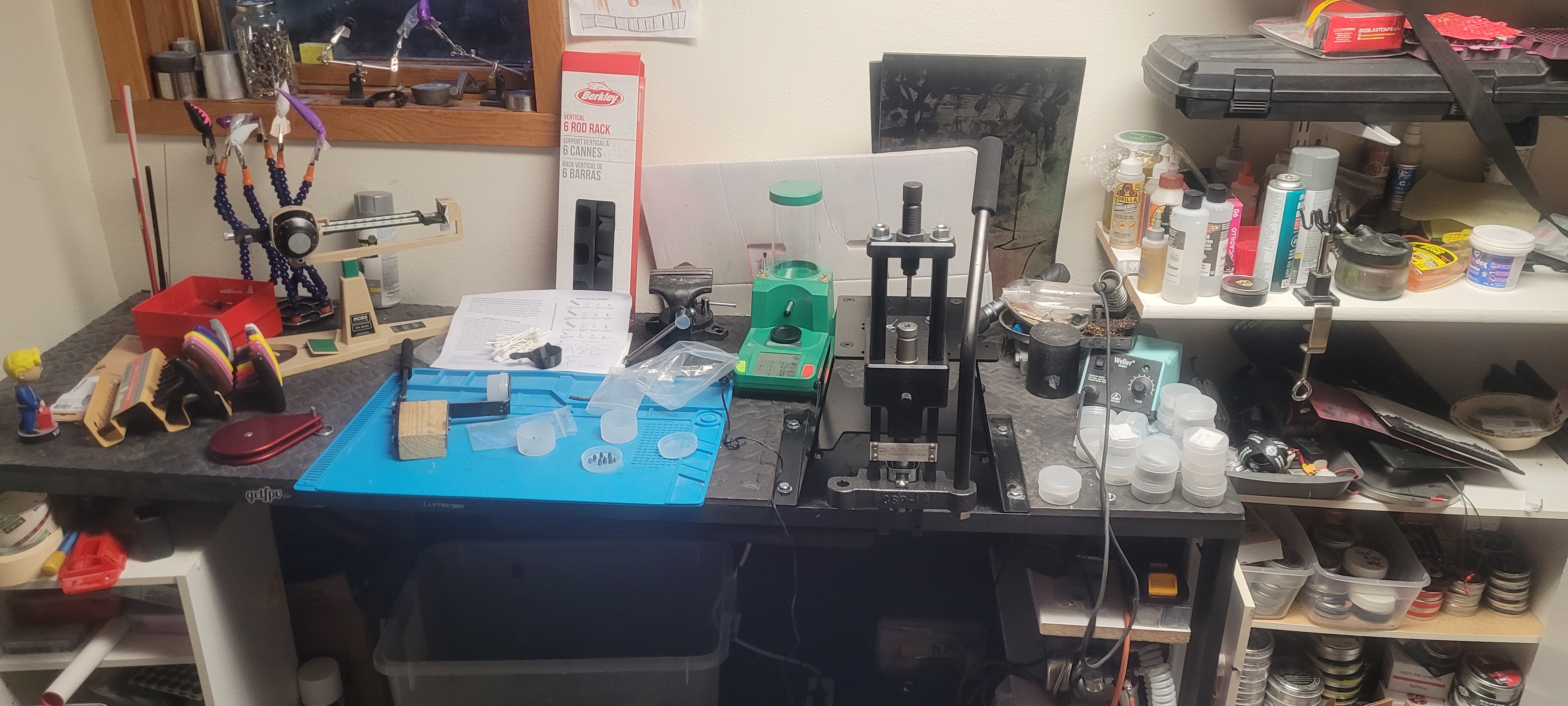

I'd like to expound on the question in the first quote with a further response. So I explained what I'd decided, but did not ay much about what I'd learned. When I was asked this question, I had ordered and received my press, but was a still waiting on other components to arrive. I'd already began reading a book on swaging by Dave Corbin in attempt to better understand what I was getting into. I'd watched numerous YouTube videos, but still lacked enough context to understand all that I was reading, seeing, and hearing. At the most fundamental level I lacked knowledge of all of the components comprising the S press and die sets. Because of this I stopped reading the book until the press was assembled. I did continue reading bulletins posted on the old Corbin site. Fast forward a few months, I was able to set up my press and start experimenting with the swaging process and some things I'd read began making more sense (some things I had to re-read). This prompted me to create the following thread and the press diagram towards the beginning of the thread.
I figured that I couldn't or wouldn't be the last person to encounter the issue of complete ignorance. I have a greater understanding thanks to people like @Ca_Varminter @CBusari @Long_Shot @Airgun-hobbyist Nick from @nielsenammo and others who have been helpful in taking time to share information and/or answer questions. Some folks at Corbin have been helpful as well as busy as they can get, particularly Kelly. I just figured ti was time to fully address the question.

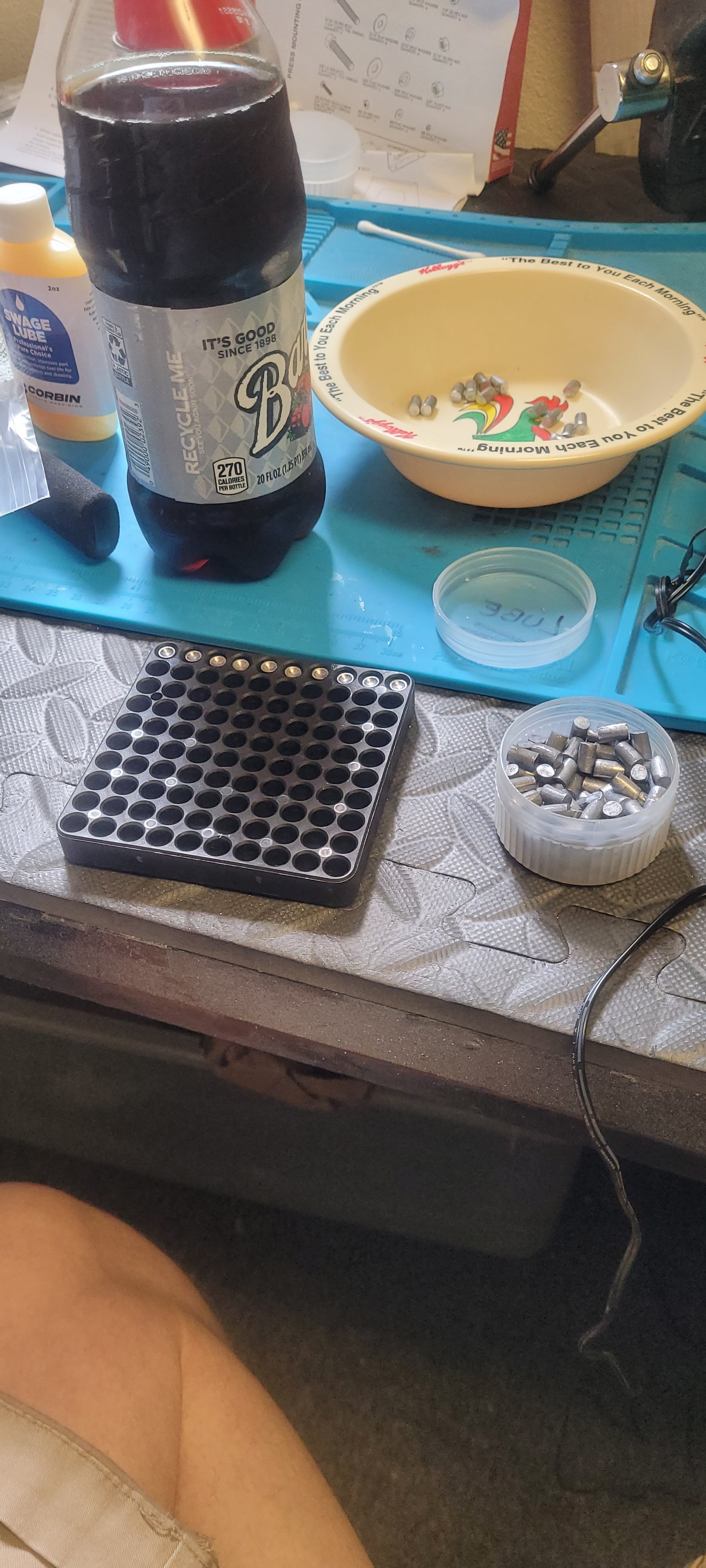

Lots of 218 30gr dish base slugs, and slugs from 28-30 grains in .5 grain jumps in the boat tail.
This system from Corbin is a great way to ensure the quality of your ammo. Extremely easy and very well built. Hell if I cam do it most people here can as well.
