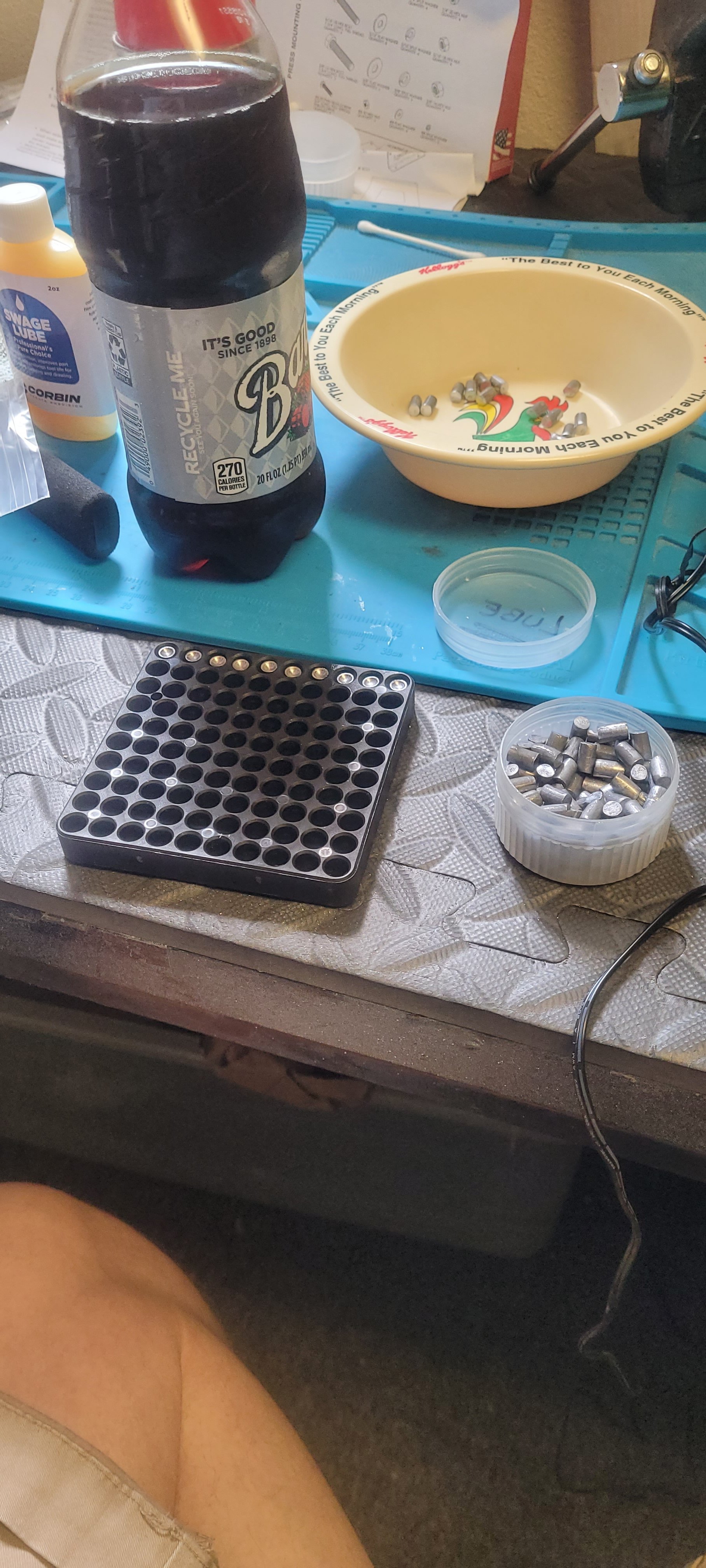

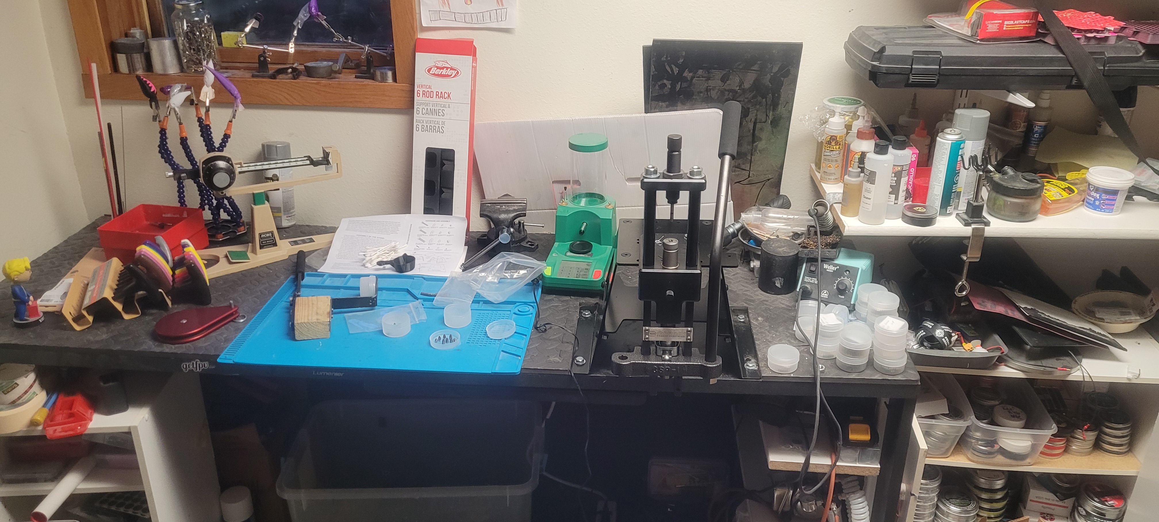

Have been plugging away with my set up. Been playing with the boat tail base as well to see if these shoot any better. Hoping to shoot this weekend to see what happens.
Lots of 218 30gr dish base slugs, and slugs from 28-30 grains in .5 grain jumps in the boat tail.
This system from Corbin is a great way to ensure the quality of your ammo. Extremely easy and very well built. Hell if I cam do it most people here can as well.

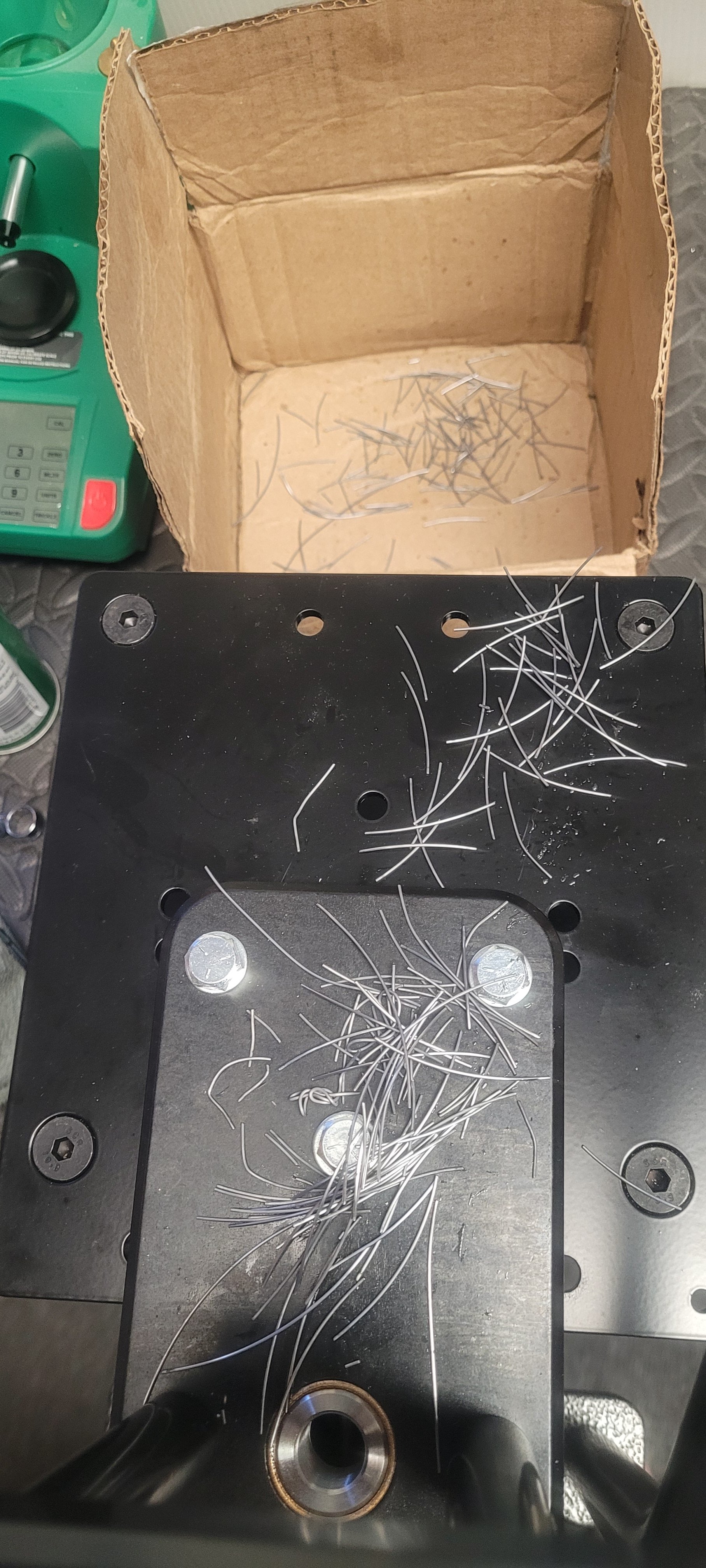

Well, I ended up pulling the trigger on a Corbin and saved $117 so thanks for the post. I finally got wore out cutting the flashing on 6500+ slugs from my other press. There is .001" difference between my die and punches and should be just a few .0001". You can't rub that off.
