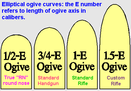

It is more rounded at the top not so narrow. Base of the slug doesn't change diameter it's just the narrowing of the nose. So a 1.5-E Ogive will weigh less than a 1/2-E Ogive given the same length because it has less mass up towards the nose@ZekeZX10 How does altering the ogive affect the projectile diameter? At times are you increasing diameter by one or two thousandths? Or is it possible that the hollow point cavity is smaller or the walls become thicker?
