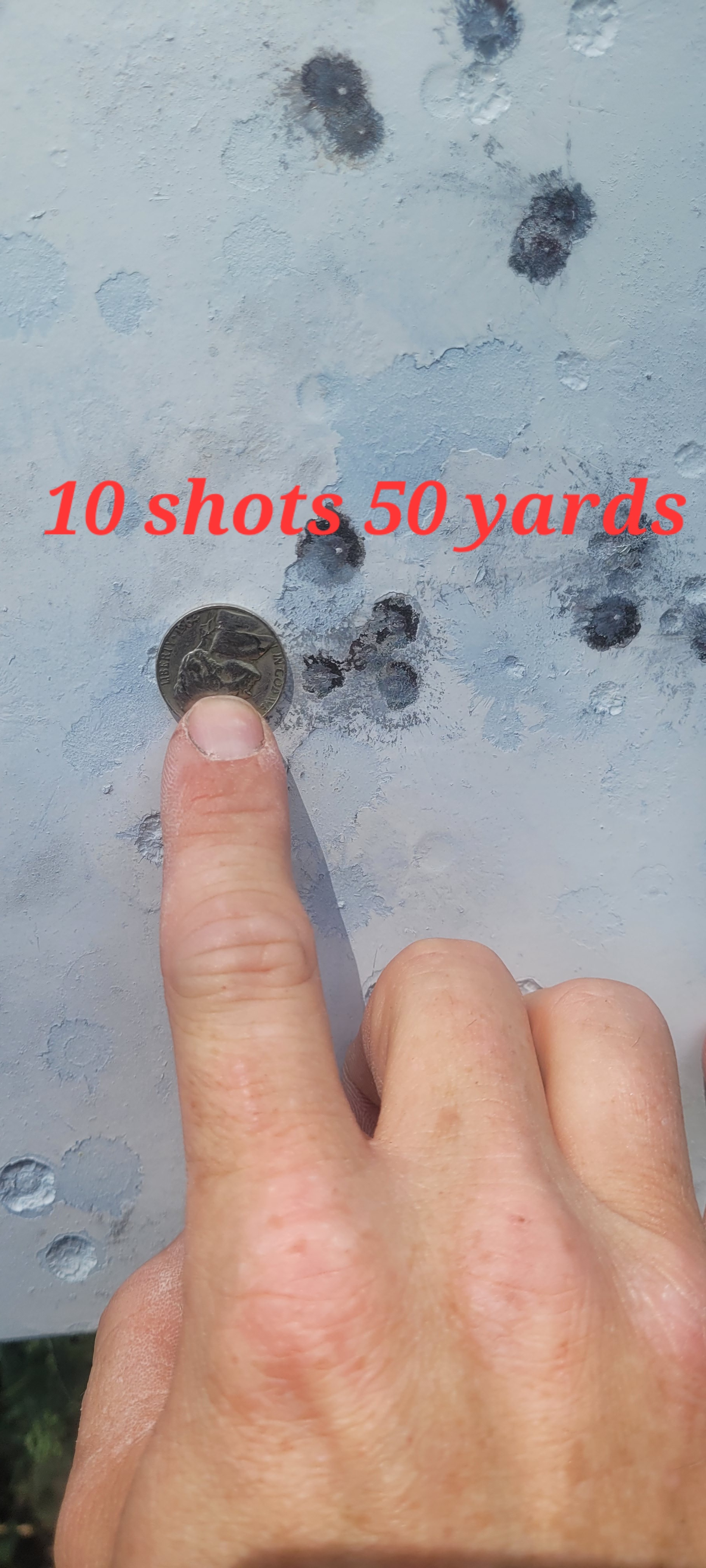

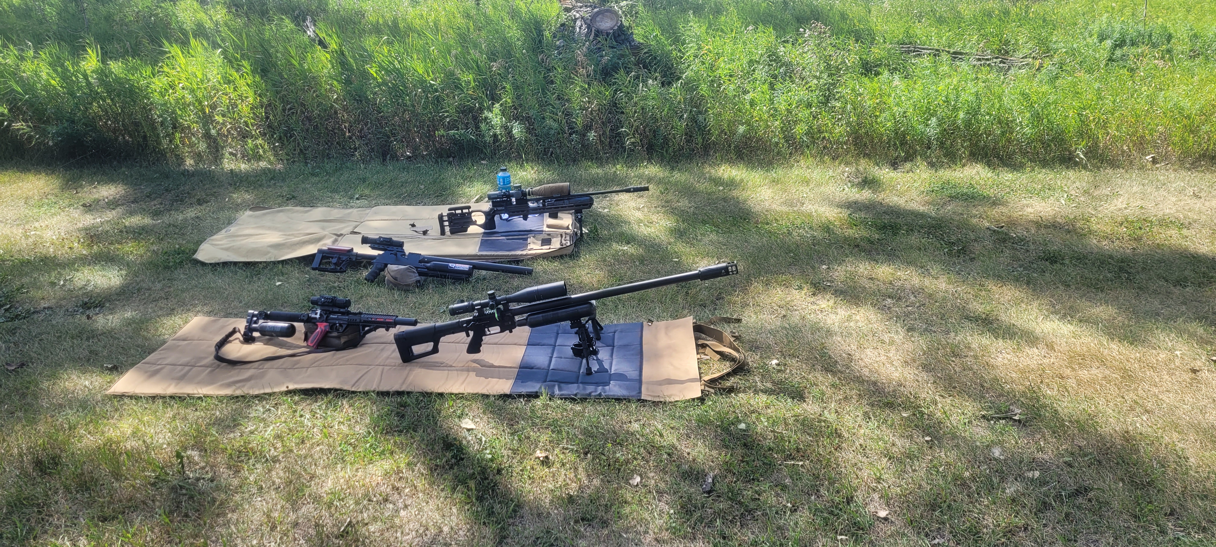

Went out today with NDwind and did some shooting to get our new Zulus scopes working. But while there we were also testing the Corbin X-Punch slugs. These slugs were made in a 218 die set and with a weight of 30 grains. The test rifle was my RAW HM1000X shooting these slugs at 940 fps. The accuracy has been quite good with them and they have proven a good shot.

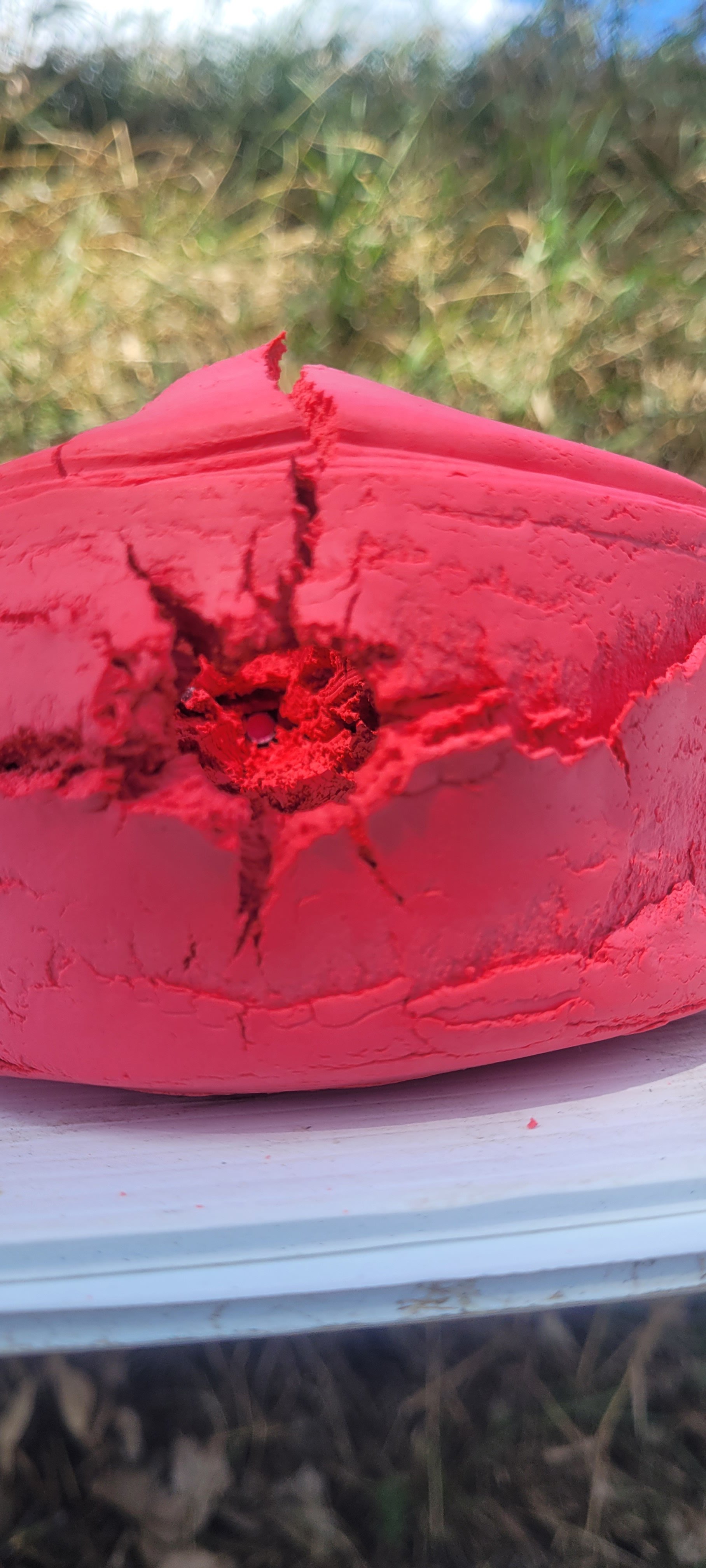

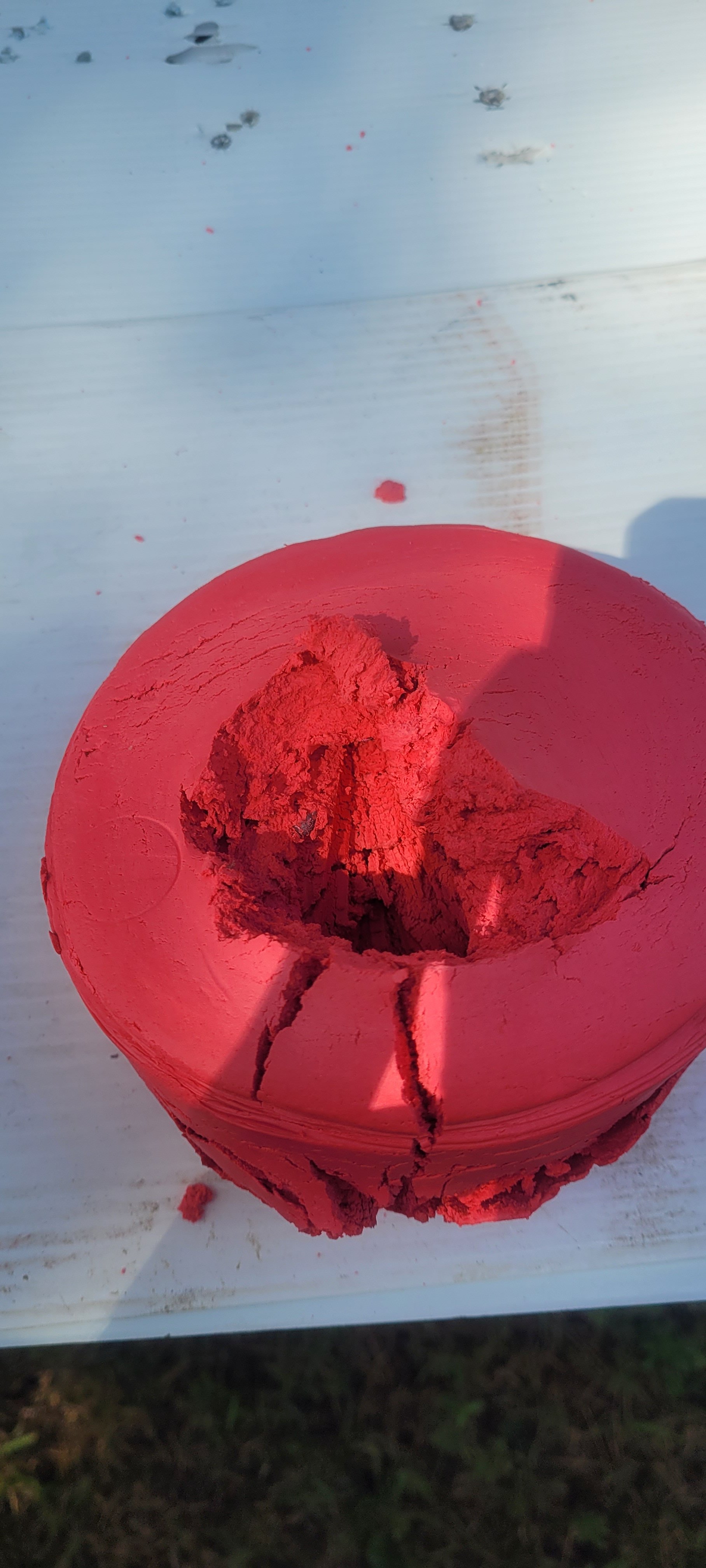

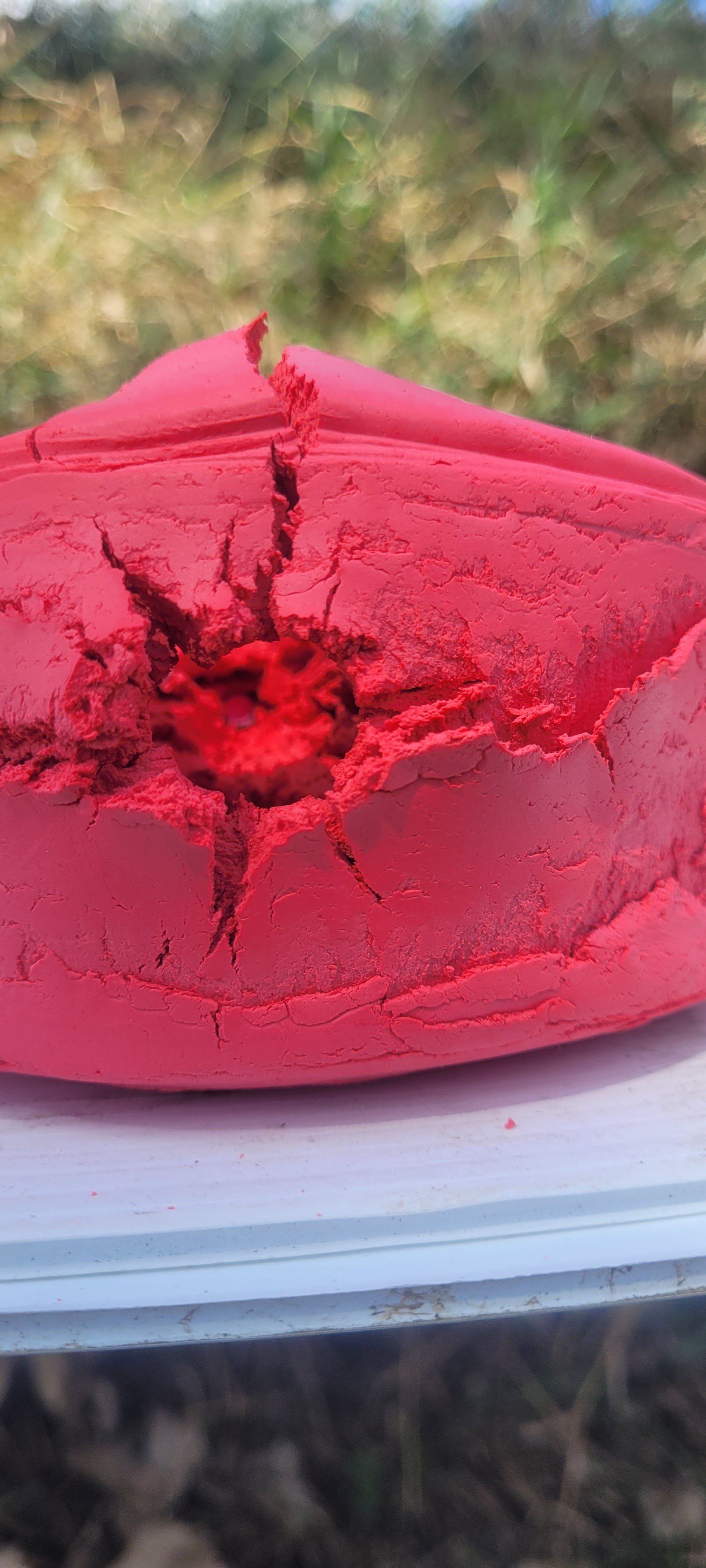

At 50 yards we set up a block of clay. This was picked up from Walmart and quite cheap. When shot the "POP" that came from the impact was stunning! The impact took the top of the clay off and tossed chunks quite a bit away.

Ok enough babbling ..... on to some pictures. The little pink circle is the slug. The slugs were painted using a guide from 68 Whiskey and making the slugs look like a tracer.

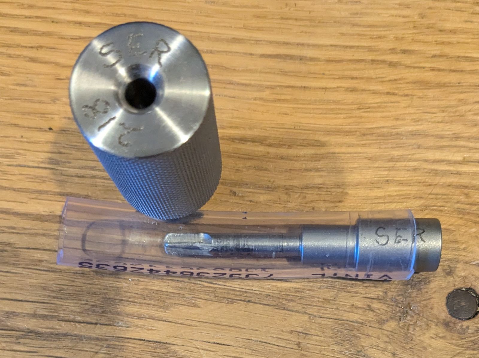

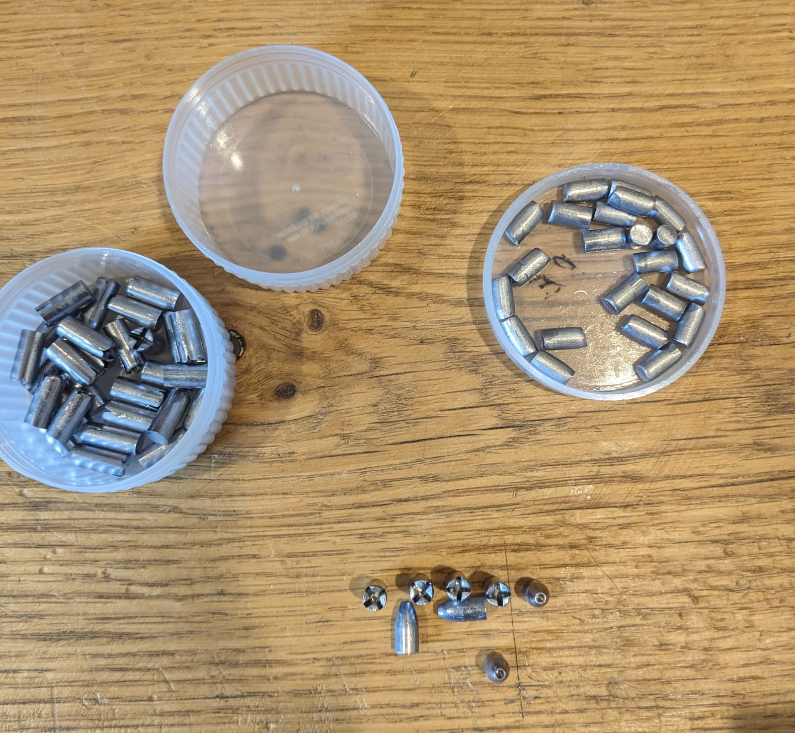

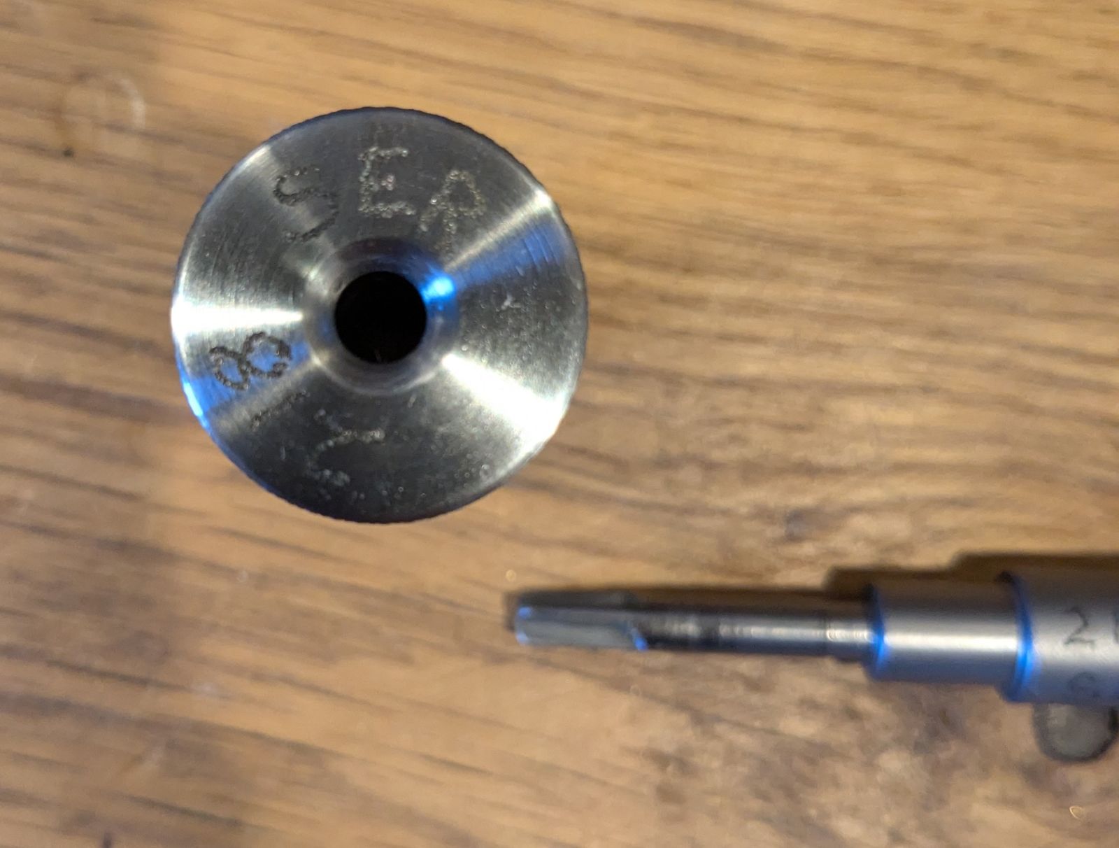

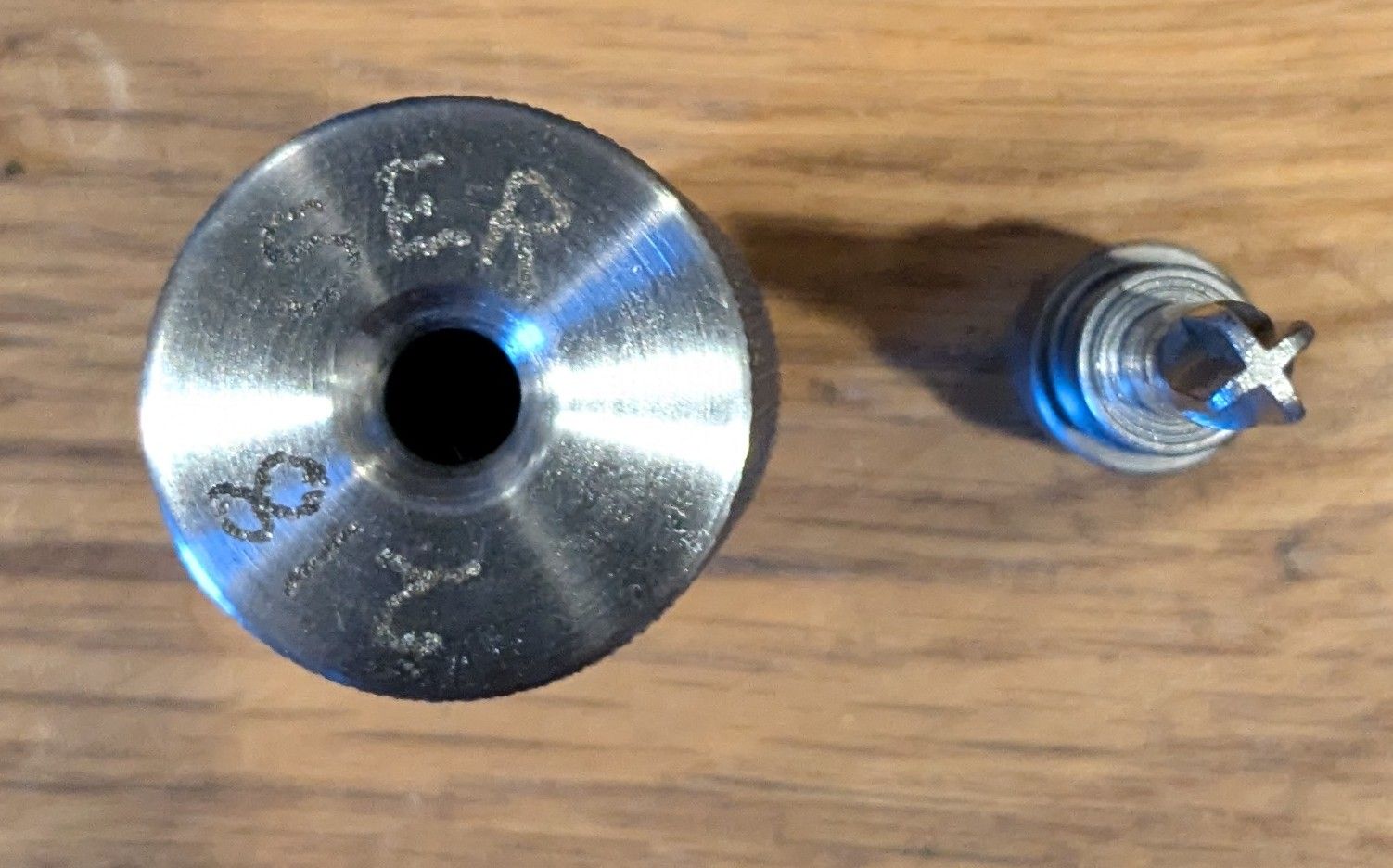

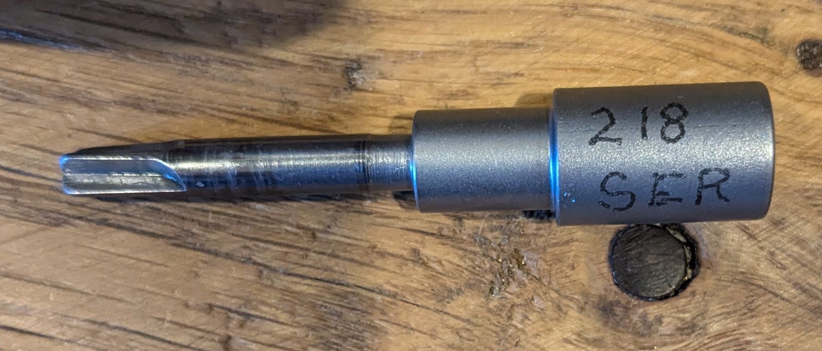

Ok Woogieman started the thread but the dies are mine so here are the pics. the X punch adds a step to making the slugs because you have to form the core with X punch then run through the point form die wich closes the core to the HP. that closes the segments but they dont fuse together. guessing here but probably due too the Corbin swage lube on the core. 30 grain slugs cost .03 cents each for lead. Pretty cheap shooting not figureing my time. What else does an old retired guy do in Winter in North Dakota!
You would have to ask Corbin for 100% fact particulars but I believe this slug was developed to minimize or eliminate pass through when pesting! we will have to shoot some starlings or something to see if we get pass through but it sure raises Hell on clay!:ROFLMAO:
I wipe my dies and punches with Ballistol before putting away. I wipe with a clean dry cloth before using again and wipe a touch of Corbin swage lube over them before swaging again. I store my punches in clear vinyl tubing to protect the fine machined polished edges.

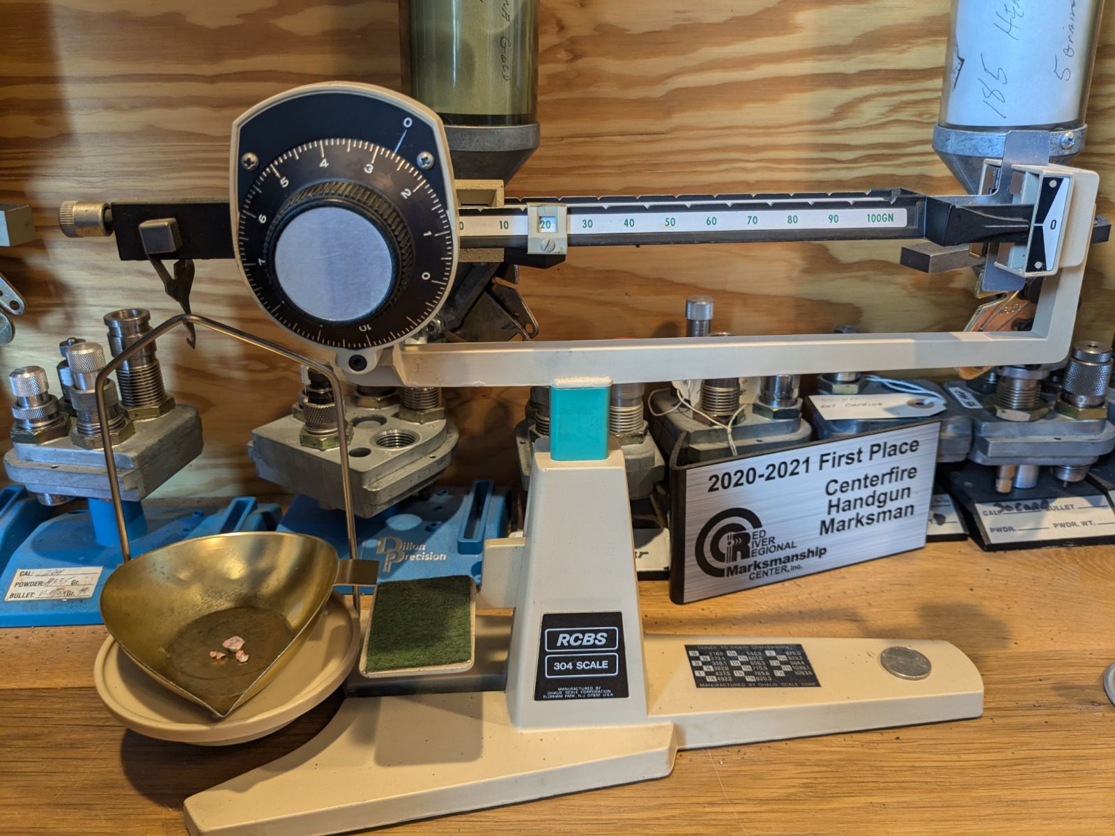

NDwind measuring the fragments we pulled from the clay.
NDwind picked off as much clay as possible without destroying the fragments. 22.7 grains from a 30 grain slug. The segments are about 4 grains each so if we had the other two segments that blew out with the gobs of clay that would 100 % weight retention
