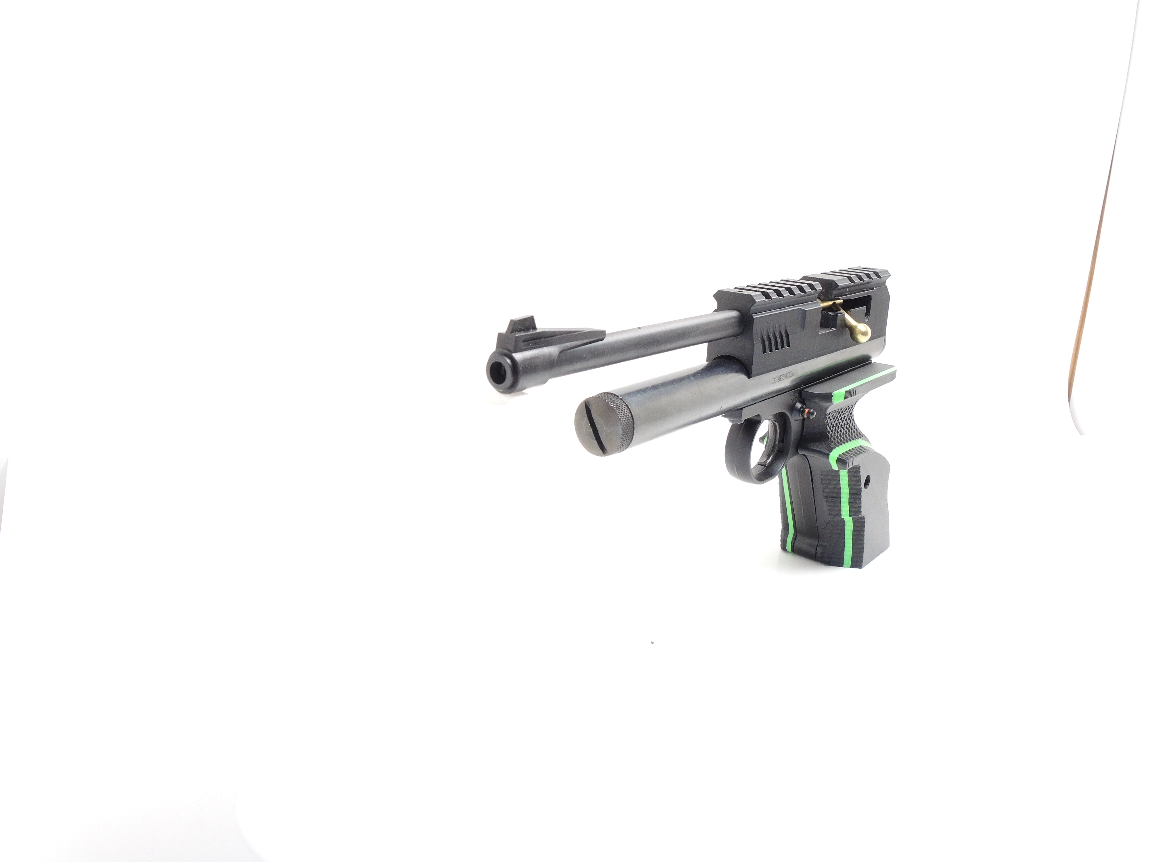

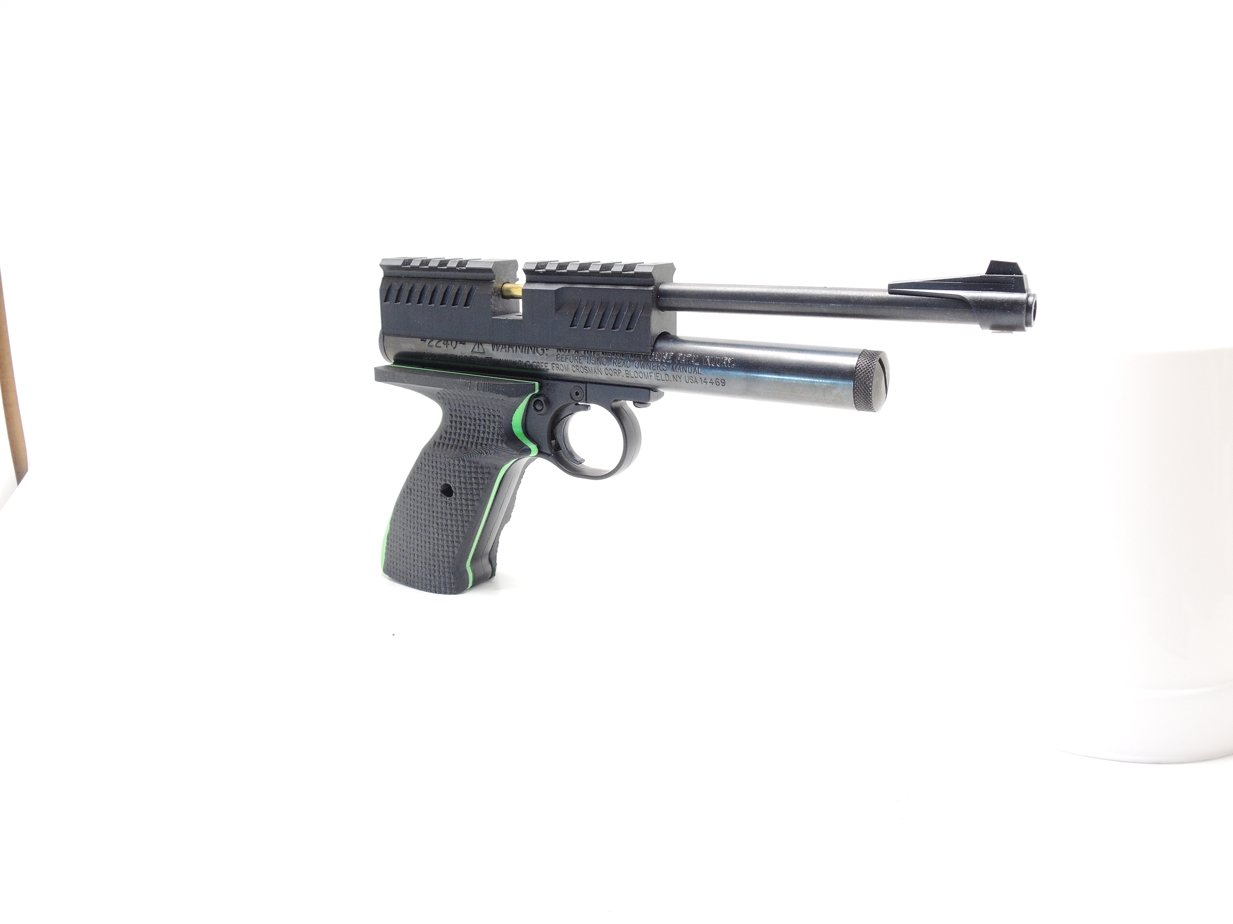

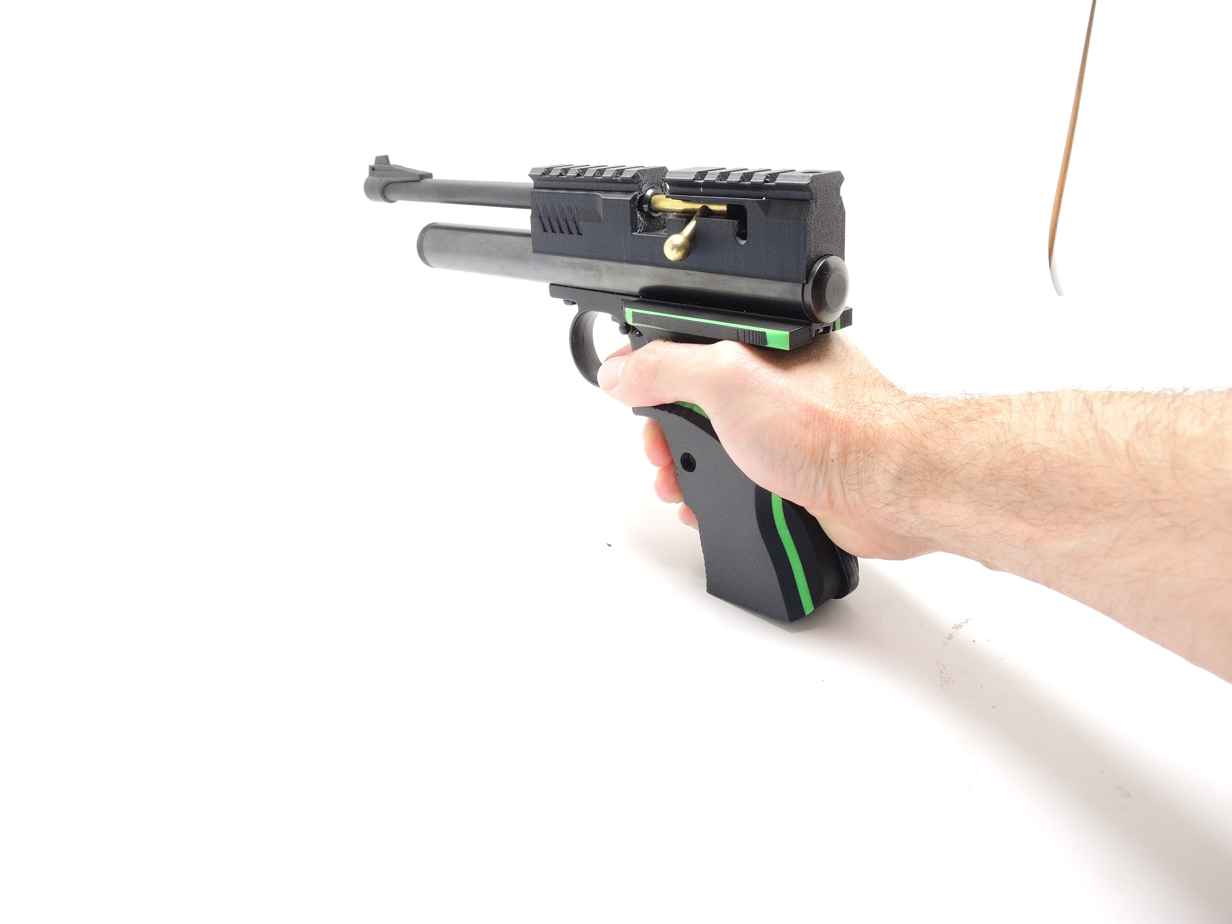

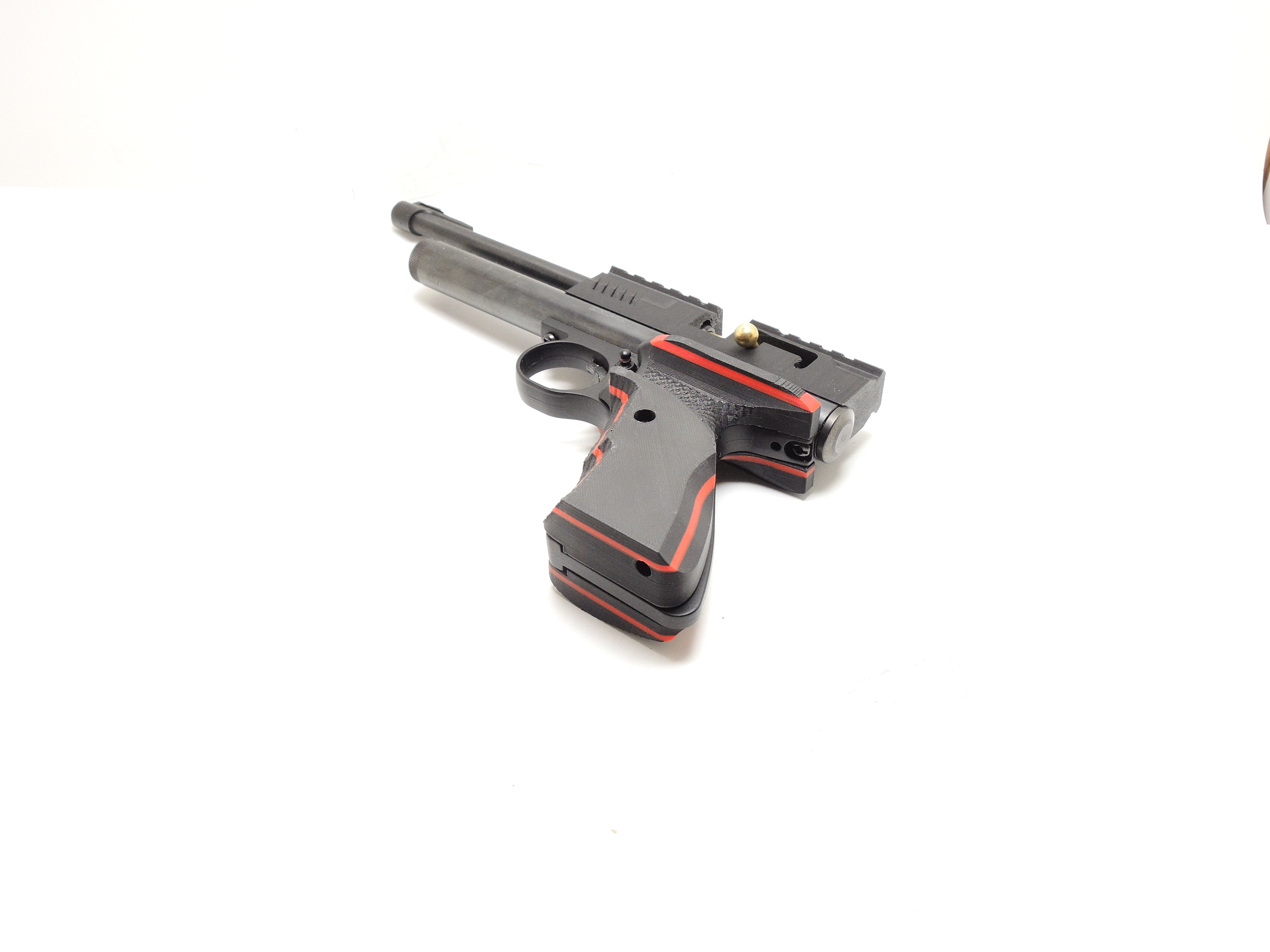

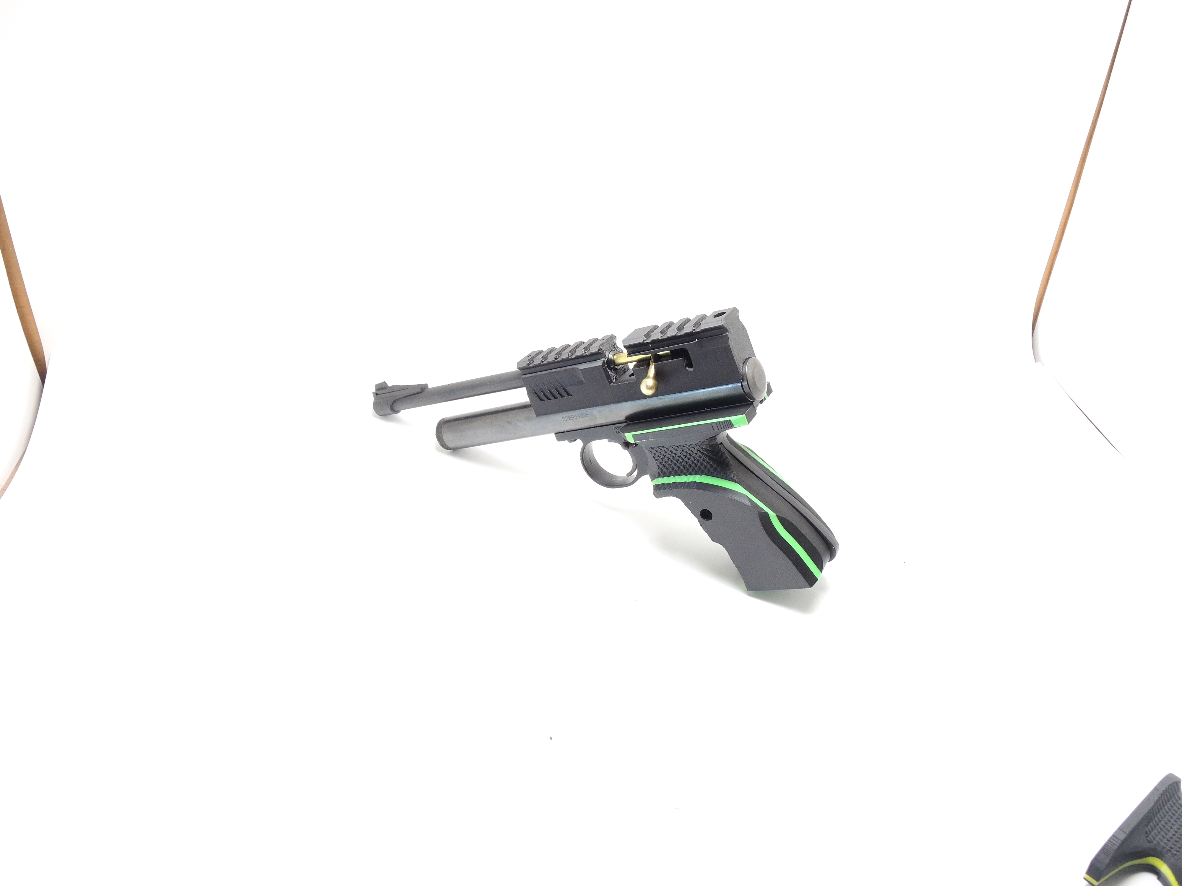

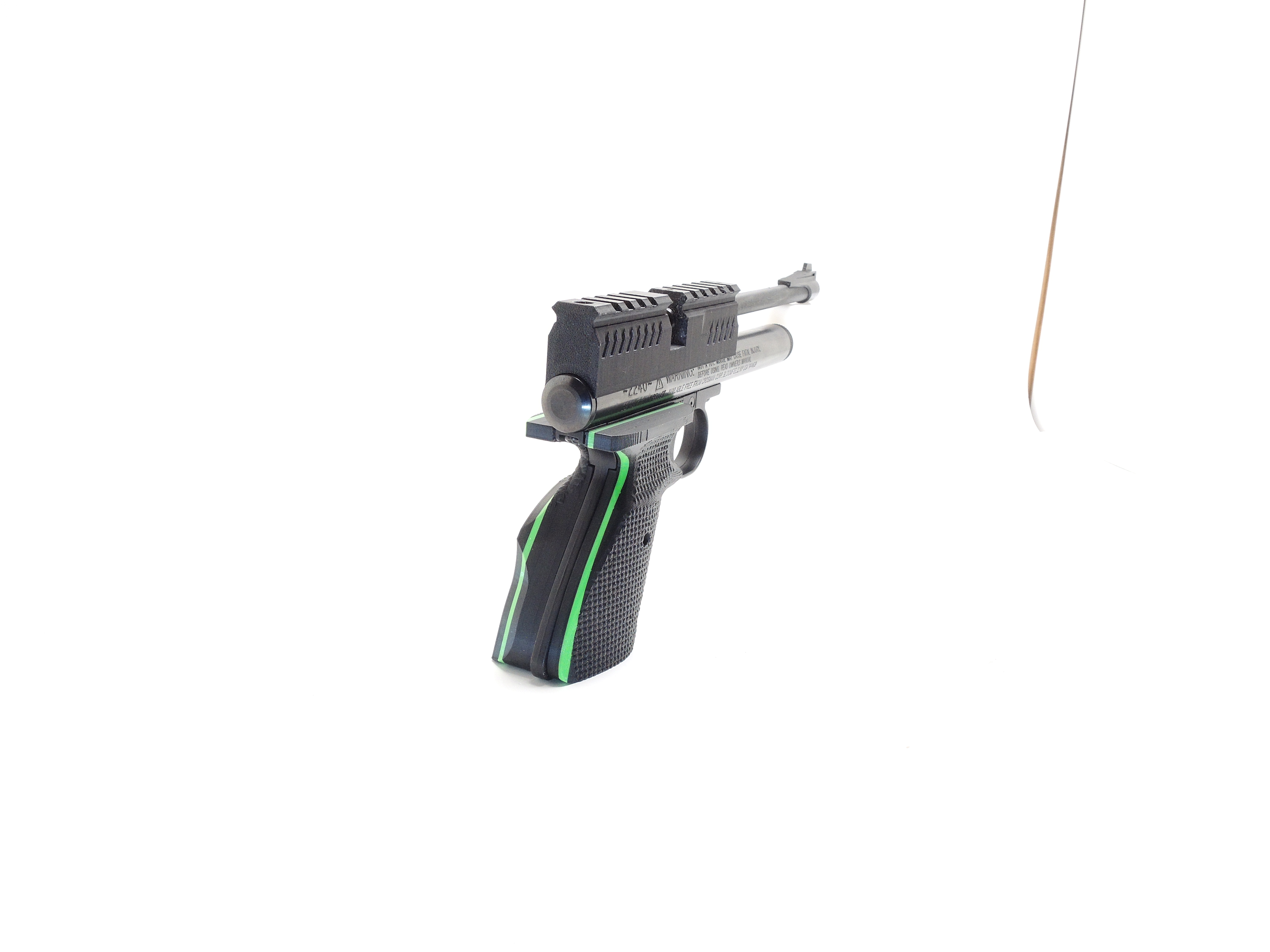

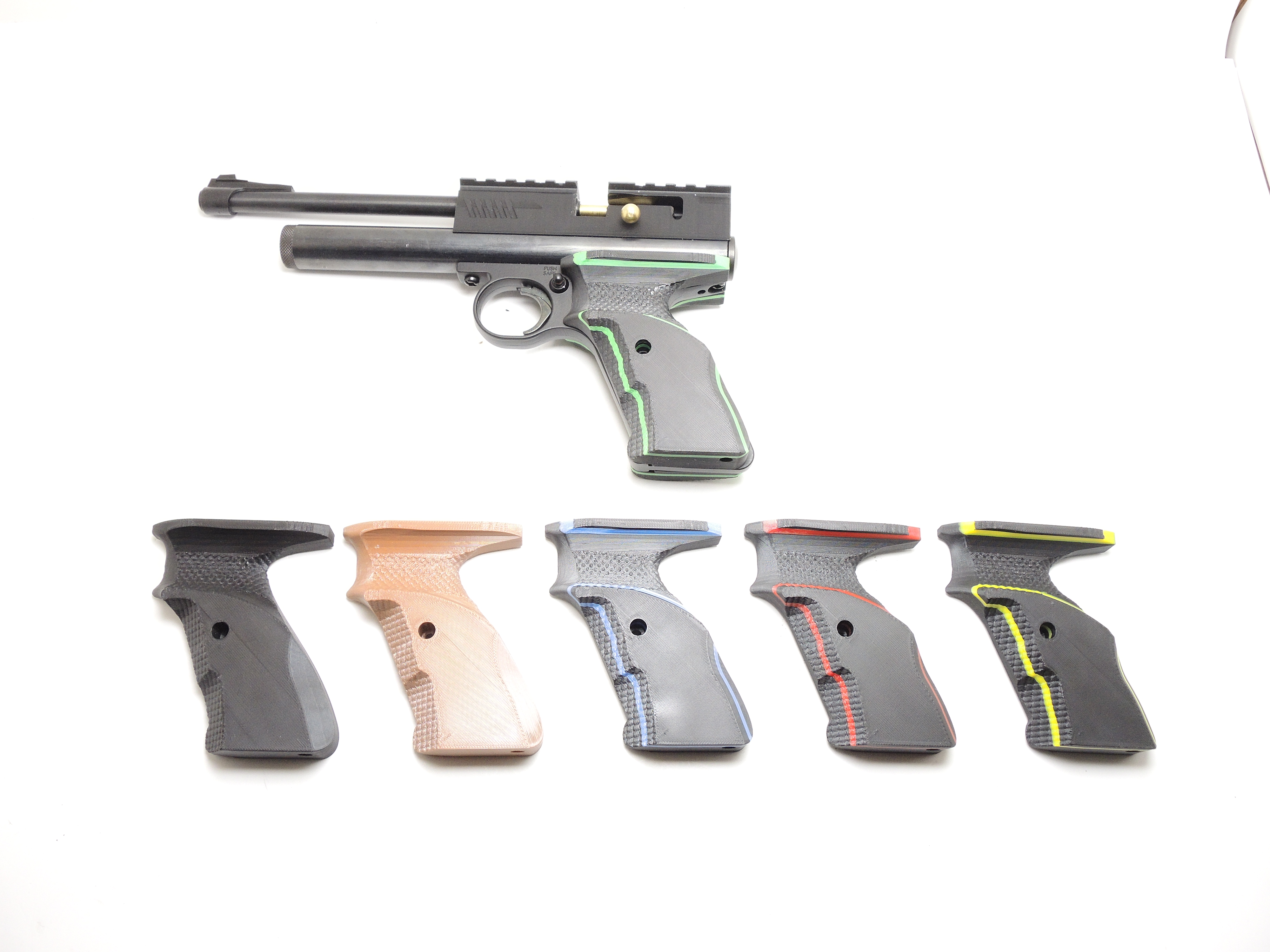

I have been working on this design for a while in my mind. I really want to take the Corsman platform to the next level similar to CROSMODS.
What ever happened to them by the way ?
I finally put it on the computer and now I am pretty happy with it. A total of about 7 different changes to finally get the feel I wanted. The grip wrap around your hand really nice and feels really comfortable.
I have a couple of different colors. I really like the green I also used a brown color which I liked more then I thought I would.
Would love to hear your thoughts.
Crosmods went the way of most custom builders, they had some interesting pieces but their grip frame should have been Ar-15 based and to my knowledge it was not and their grips were grey and ugly
i emailed him about something and got a terse answer back and that was it for me
so, if you were going competition style grips, they word have a strong side grip shelf and i know you have put in a lot of time on these but to be honest the weak side panel is way too heavy
now grips have two main things about them, the feel of course but looks also
just my observation
but good luck with your product

Hello @Squirrel hunter
Nice looking grips and I like that yellow trim.
ThomasT
sorry this looks uncomfortable , blockish , not smooth flowing .
Stan in Ky.
Hi Beerthief, I put a lot of time into the design. I printed about 7 different iterations and this last design when I hold it in my hand, and everyone else hands I ask to hold, say it feels like it was formed for their hands. The grip really feels comfortable, the first iterations did not feel comfortable and the reason I ended up with this version.

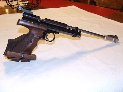

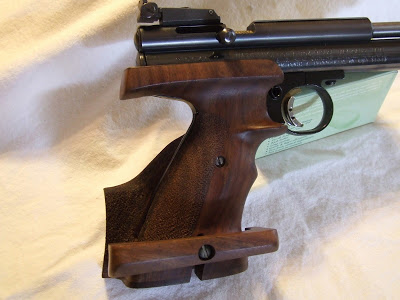

What is the weak side. Can you show me a picture of what the grip should like. I studied a lot of olympic style grips and ended up with this design. The feel of the grip feels sturdy and comfortable, but I guess I don't know what I don't know because I don't own any olympic style pistol to compare, I can only compare from pictures.

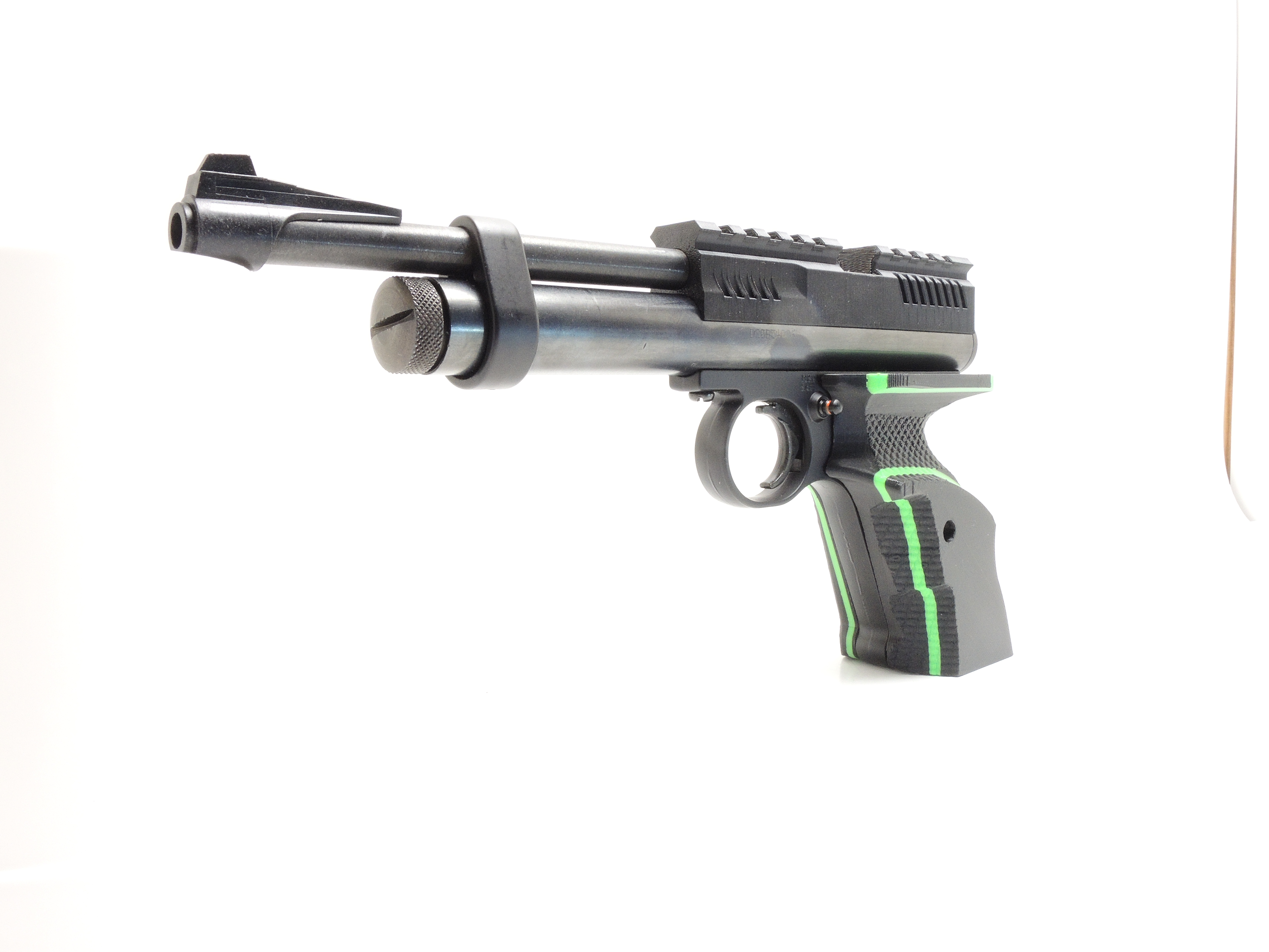

Your grips look great, but again, what kind of breech is that,Purdy please?
Sorry I thoughtI answered your question. Its my own design. I made it to accept a Umarex magazines. The problem is the bolt will not go into the magazine because it is larger then .22. I am trying tryin got find someone to make me custom bolts so they would work with the magazine. This another project I am working on. I want to sell them as a kit to turn into magazine fed.
This is what you are looking for…

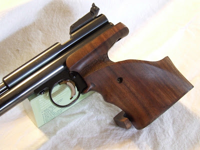

Here are some more pictures for you to study…
