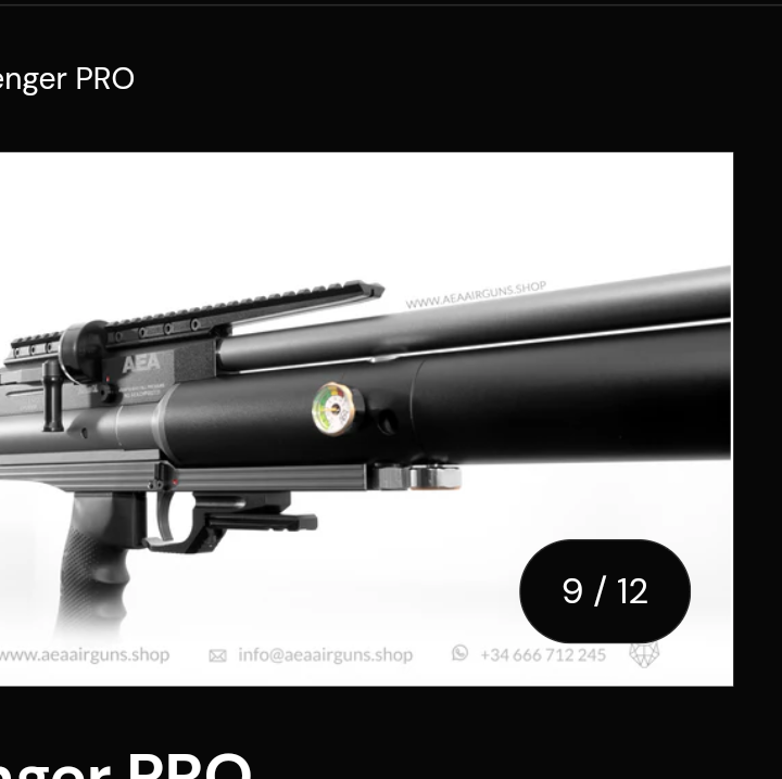

I only just saw this website last year and I know there have been AEA owners over the last 4 years. Most people don't know this website exists, this website is based out of another country. Majority of owners that have bought these air guns have bought them through fox air power, the pellet shop, utah airguns. Even at my local airgun store, AirgunOne Inc. We had a really bad experience with the distributor in Davie Florida. Idk about the other stores experiences but my local one had a really poopty 2 year experience with them. They would send guns without gauge caps, the baffle stack orientation was backwards, one mag instead of two, sometimes no mags at all, or they came with broken poppet valves and he was stuck with fixing them for who ever bought them. For the longest, they really didn't have any warranty. But Binatac and Zack would do what they could to make sure that he could help us fix the gun. I know the pellet shop guarantees the AEA guns you buy from them up to a year. I couldn't tell you about the rest of them though.

You can download the parts list PDF off the pelletshop website.
Just degas, unscrew the gauges replace the o-rings on both of the gauges, then reinstall them, and fill to pressure.
What I have seen on every Chinese airgun I have is they do not dress the o-rings, so when you reassemble it use a o-ring dressing.
And while you're at it, just get the o-ring list of all the o-rings and order them so that you have them on hand for when they fail, and use better o-rings than AEA does😬

To be honest, I really like the looks of the Challenger Pro. I spent about an hour watching Videos on FoxAirpower I must say that the .25 producing 100+FPE was quite impressive. Most of the older Videos showed a 2 1/2 -3lb Trigger pull, he showed 1.5 on the one He had. The 2 year new warranty is better. But the horror stories have kept Me away.
