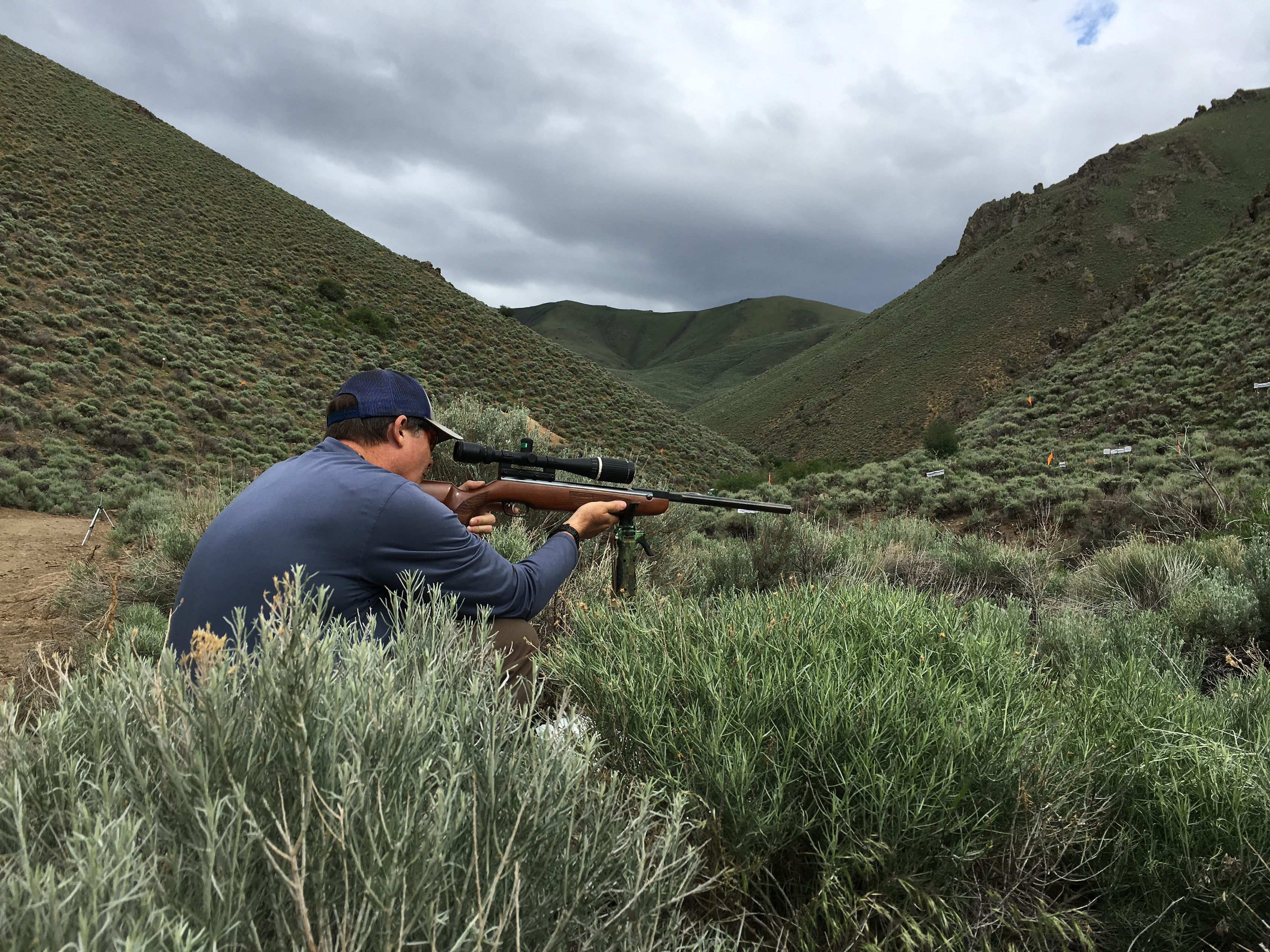

The Battle Mountain match in Nevada is a very difficult venue to shoot, the wind, the sun, and the canyon walls are relentless. A 45 yard target looks like its 55 yards away, a 55 yard target looks illegal, one's sense of scale/distance is distorted and there is very little around to judge wind when it is under 10mph.
This is not a post for commenting on the new scoring formula, it is to try and figure out how to set an 'easy' 36T course in a location where there is a lot of wind. Since the scores are relative to that match a low scoring win counts for full points (36T course), we'll just have to live with the lower hit percentages (we're Tough Enough).
Typically the course in Nevada has been set at or around a 28T, which sounds low yet some of the best shooters in the world have a very difficult time breaking into the typical hit percentages seen on a more difficult course without the Nevada wind.
