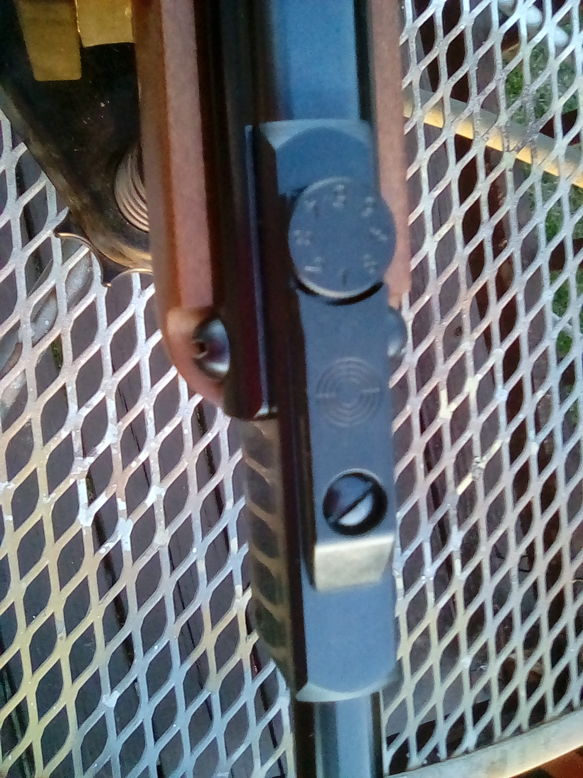

After installing a Williams FP-AG-TK rear diopter sight on my HW30S today I removed the Weihrauch factory rear sight. I'd like to install a cover of some sort to cover the exposed screw holes from the sight, does anyone have any leads on such a device? Thanks in advance! :)
I use allen screws flush with reciever

...modern fasteners are 0.8 pitch, Weihrauch used 0.5 pitch...you would not want to re tap the breech holes to accept the modern pitch...
...wrong thread pitch, M5x0.5 is required unless breech hole is recut, after which the rear sight elevation screw could never be used...
