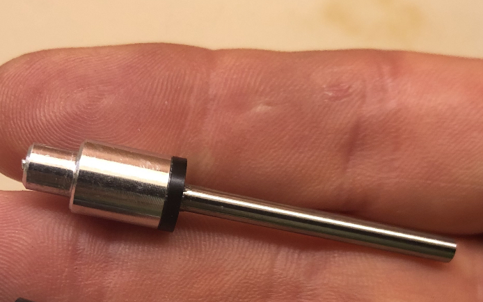

As I suspected, it’s a failed poppet. The metal valve-stem and head is moving with a hammer strike and the Delrin material is staying on the valve-seat. It’s failed!

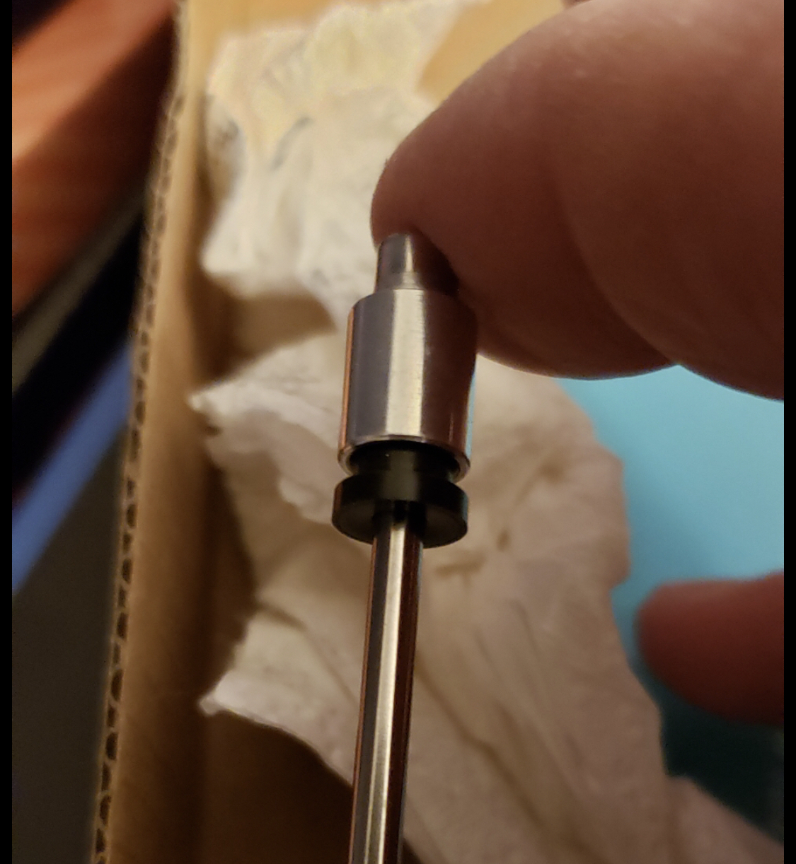

This is what a healthy factory poppet looks like:

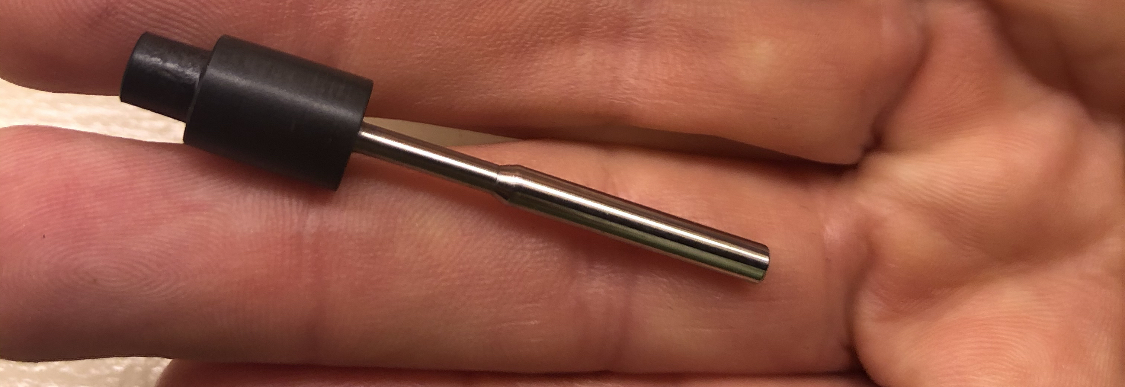

We’ll get you fixed up friend. I’d like to get a custom poppet that my buddy John Hagan has made in the past. I’m not sure if Hagan makes custom PCP parts any longer. He was having health issues last I heard, unfortunately! It sure is a great poppet. Has a Titanium stem which he coped for better flow and had a full Delrin head:
