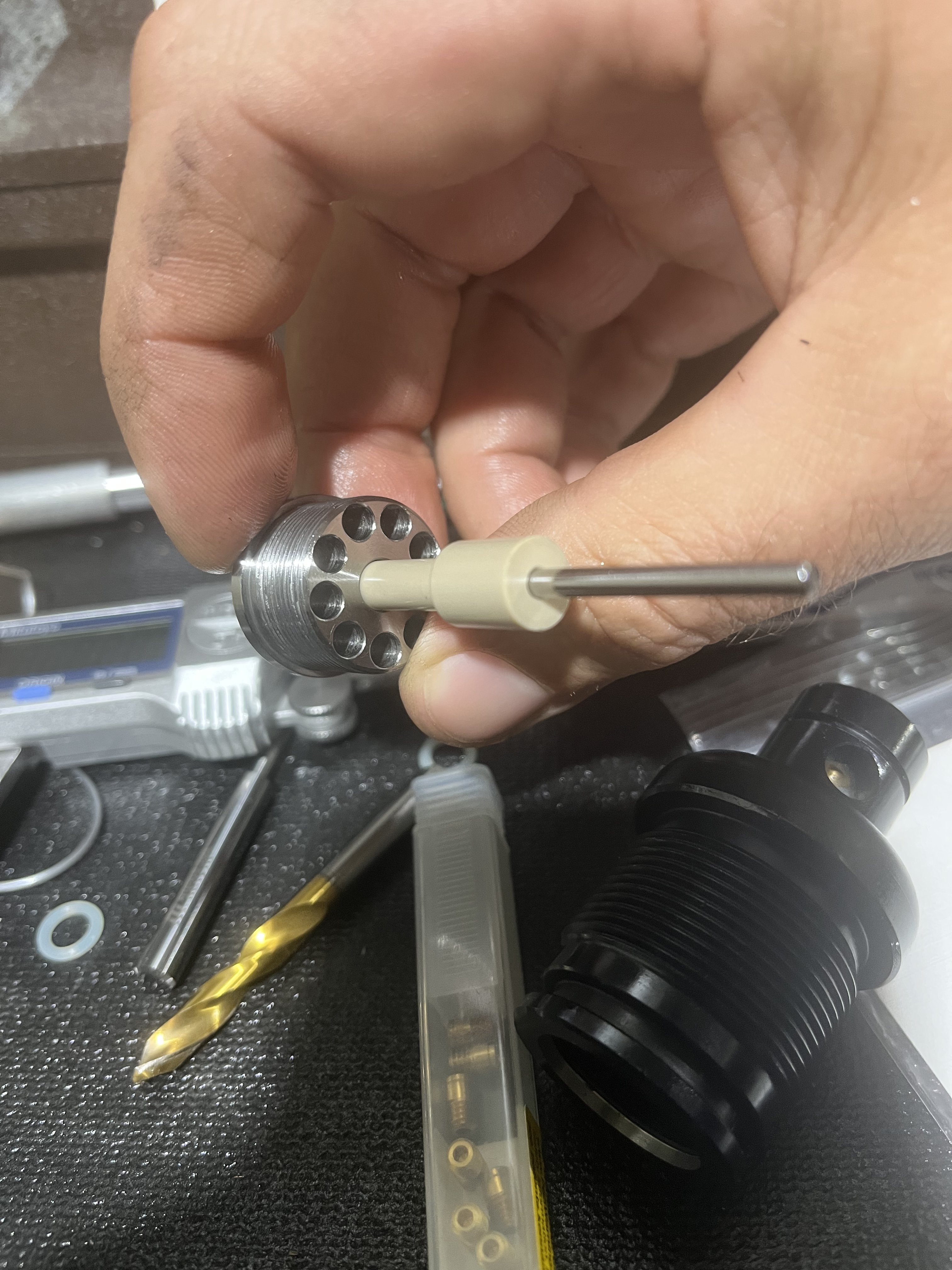

I dont have much time anymore but got to do some more toying with the 9mm cricket. I posted awhile back about a balanced valve but ive got a “ perfected” version in it now. What a power house and effiecent too! Heres where im at:
.320 porting
Peek balanced valve ( .380 poppet, .245 secondary, urethane internal orings x2, .062 vent with .048 jetting in the back)
Light weight free flaoting hammer
Huge 6” plenum extension tube ( I made it)
Huma reg
1 degree leade after chambering for 125gr slugs. Very important on these barrels as I couldnt even chamber a slug.
Long story short, the stock hammer spring was waaayyy to much ( total plenum dump what a recoil!) I had a taipan spring laying around that would open the valve perfectly at 115 bar. What a suprise I had when the chrono showed 1020fps at only 115 bar with 81gr pellets. My end goal is 950+ with 125gr slugs. I think I’ll get there around 160 bar. Anyhow just wanted to share. Next up is boring out a koi to work and adapt it to the factory shroud to help even out the shroud to the tube and gain a little less noise. Heres a quick pic I took of the valve. You can see the small jets in the tube for tuning. This is unfinished but the only pic I took!

Tinkered a little more today, I think I need a valve return spring which will be easy. At 160 bar I cant find a good balance between the jetting and valve dwell. Makes alot of power but wasting a ton of air. As far as the signifigance of it, I just really really like the looks and compact size of the cricket but wanted some more power for slugs from it. It would also not be easy without some sort of balanced valve in it.

Well, orginally I had a short stiff spring. But now, ive got the stock spring back in with preload, a heavy return spring, and a .029 jet and its actually working better. Easier to tune the valve. This is a learning curve for me thats for sure lol.
Some more fun results. Using a short heavy ( from talon tunes) taipan spring with delrin spacers to tune the gap for now, and a .034 jet with no spring preload shows im getting closer. The heavy valve return spring seems to be a must. At 150 bar Im getting 990 fps with 93gr slugs and its just sipping air and is much quieter. I took 10 shots above the reg from 200 bar and had more to go. Pretty cool!

Well, dont want to give any false hope here, looks my chrono went bad giving me false numbers. Got another one out and got some real number. 990 @ 150 bar with 81gr jsb. Still not bad! Easy to cock, and more shots than factory. Still got some work to do!

So it seems the smaller jetting, the more lift and dwell but there is diminishing returns. The larger wants to close the valve too fast unless a heavy hammer spring is used. But, by using a large jet and no return spring gets the valve hard to tune and wastes air.
Is your valve similar to the JSAR balanced valve? I’m asking because theirs had jets too.
Have you tried tuning it by making different size vent holes in the valve stem?
