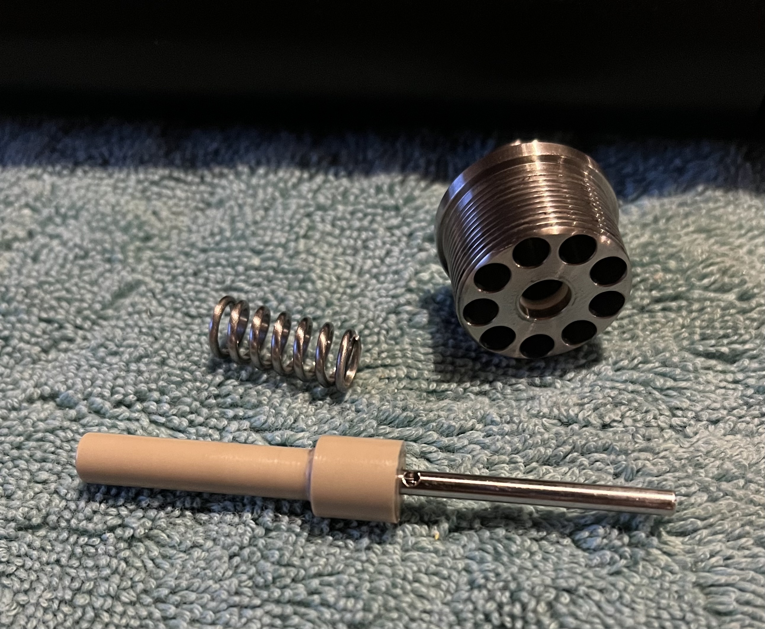

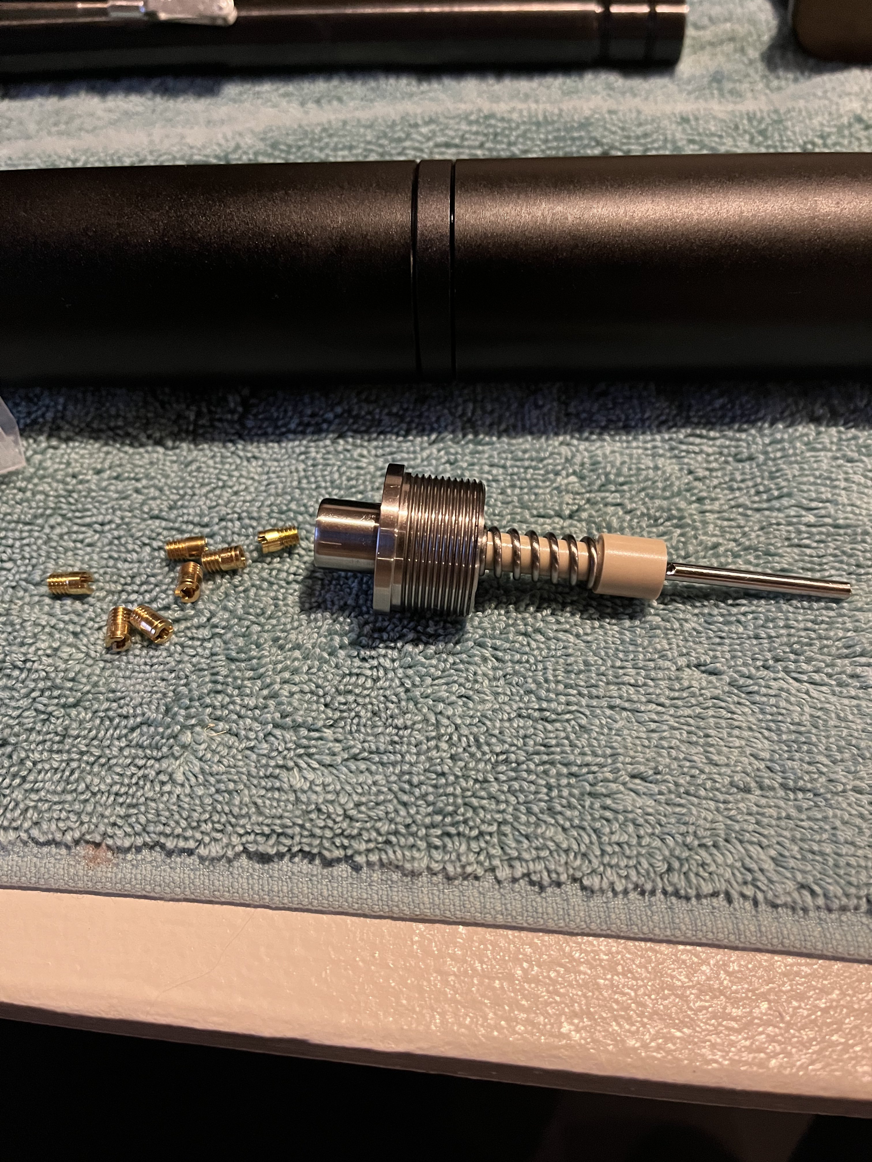

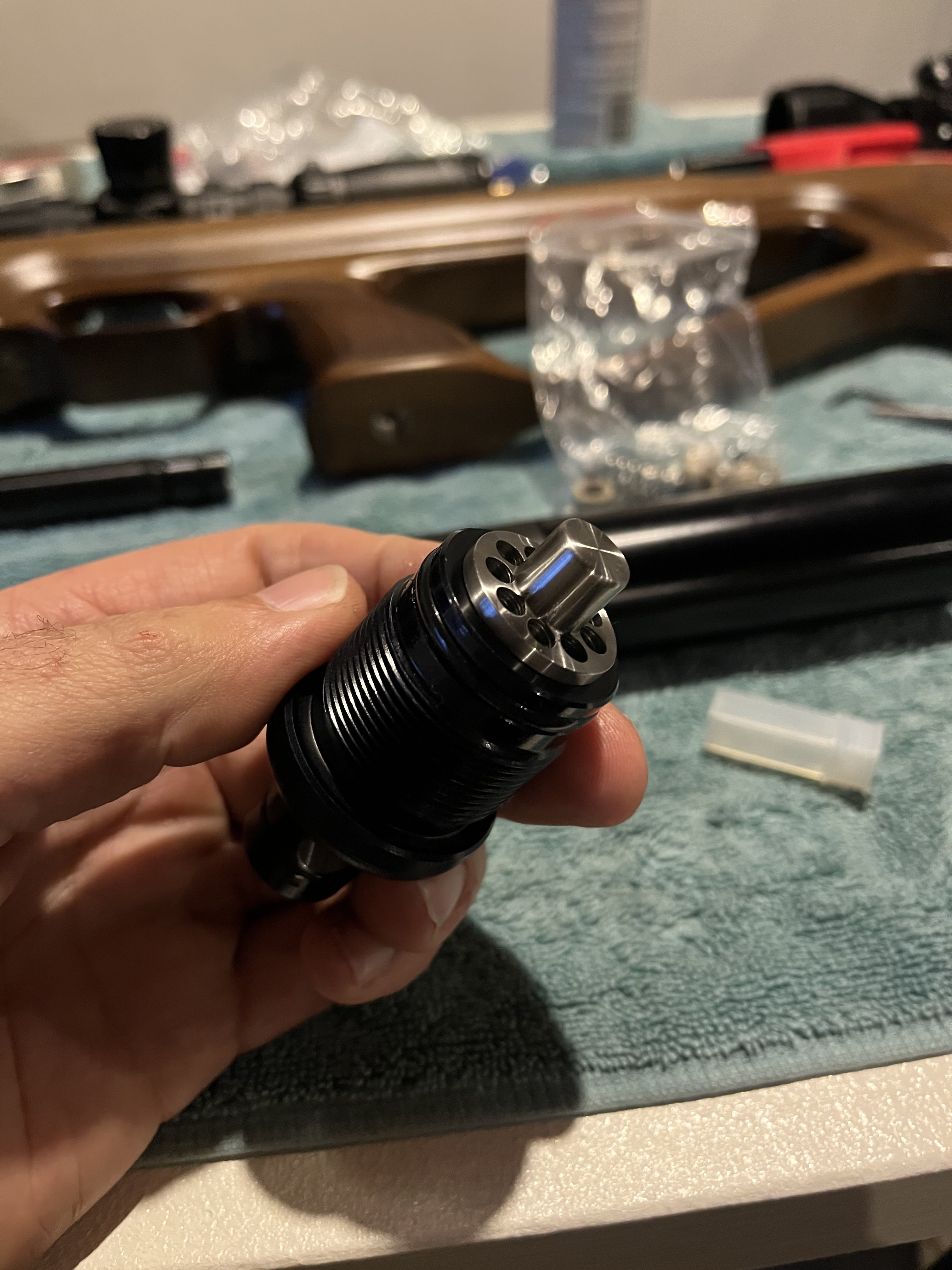

Heres some valve pics. The jets basically control your lift and dwell. Going too small makes the valve lazy, but will open with very little hammer strike. Too big and it slams shut too fast and needs a heavier hammer strike. Finding the sweet spot makes the valve “ tunable” using the hammer spring. It honestly takes hours of tinkering, but worth it! Also, I havent messed with the hammer weight, stock around 36 grams. The combinations are almost endless, but I settled on a free flight hammer thats super easy to cock now with way more power than factory. Materials used are 17-4, peek, drill rod, 90d cast urethane o rings. Dims of poppet are .380/.250

I ordered a 26 twist 31” blank. I prob wont get to it this season though. I would expect 100+ more fps, around 220fpe. However, I just sent off a really really cool shroud assembly to get hard annodized. Its very similar to a donnyfl core, with some changes. The inner core is 11” of baffles, 1.25 dia, and has a m18x1 on the end to add an additional ldc. Id loose all that with a longer barrel. I did figure out that leaving the hammer and spring alone and just swapping jets can take power to 190fpe, down to 65fpe. A jet around .058” makes 90fpe with pellets and is alot of fun! Super high shot count and wicked accurate. If I was clever enough to swap the jetting with a needle and seat and make it externally adjustable, Id be on to something lol
