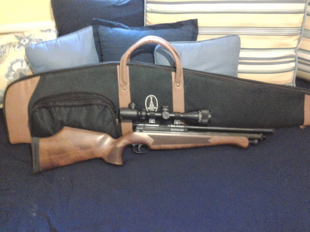

USMCShooter1, First thanks for your service. Very nice tuning on the cricket. I to bit the bug on a compact .22 when they hit the street. Love it. The Bsa hornet got my attention. They were/are nice guns. This is my .177 that's way back in the gun cabinet. Very good shooter. I haven't seen a post on the Hornet in a long time.
