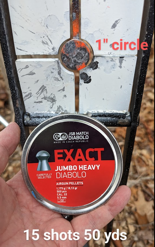

I have the Cricket 2 Tactical 45 .22. I only shoot in my backyard and only recently found a way to safely squeak out a 50yd shot. I've started testing all my pellets in all my guns at 50 and 25yds. My Cricket was loving the JSB 18.13. Once I saw how well it was grouping on a 2" target at 50yds I decided to shoot a mag at the quadrant target and I put 11/14 on the 1" center circle at 50yds. That was fun since the 50yd shot is new for my backyard range :)
