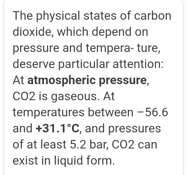

Picture liquid co2Liquid Co2 turns to gas at ambient temperatures. Needs to be gravity fed. Fire extinguisher "might" have a hose going down that may hinder getting it to do what you want it to do. Refrigerator would probably work
