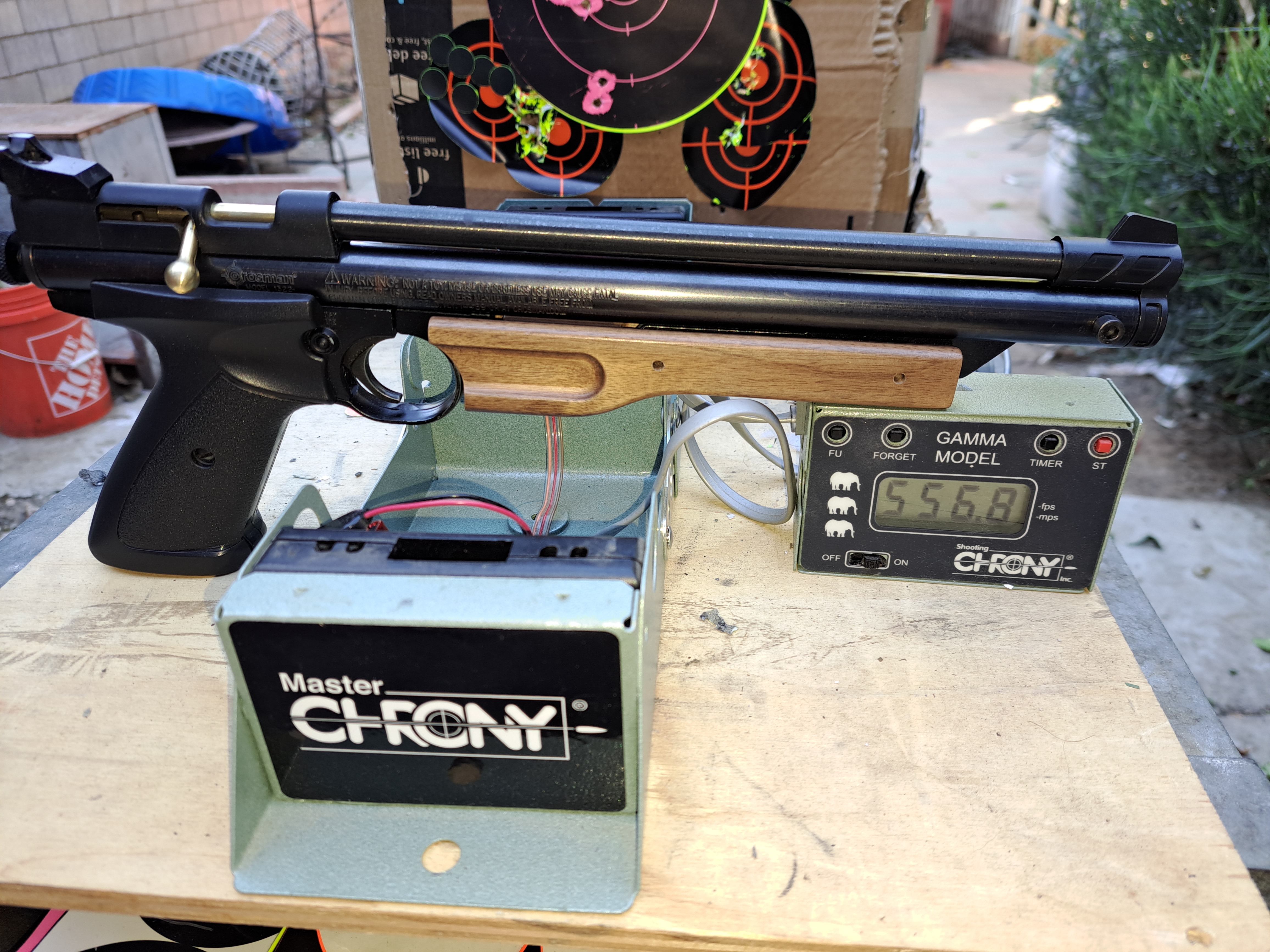

i only have the buckrail moderator on it and a steel breech. still fun though. my notos took up all my modding attention when i got it. i might have to revisit the 1322 to add power. i’d like to have a higher power pumper.

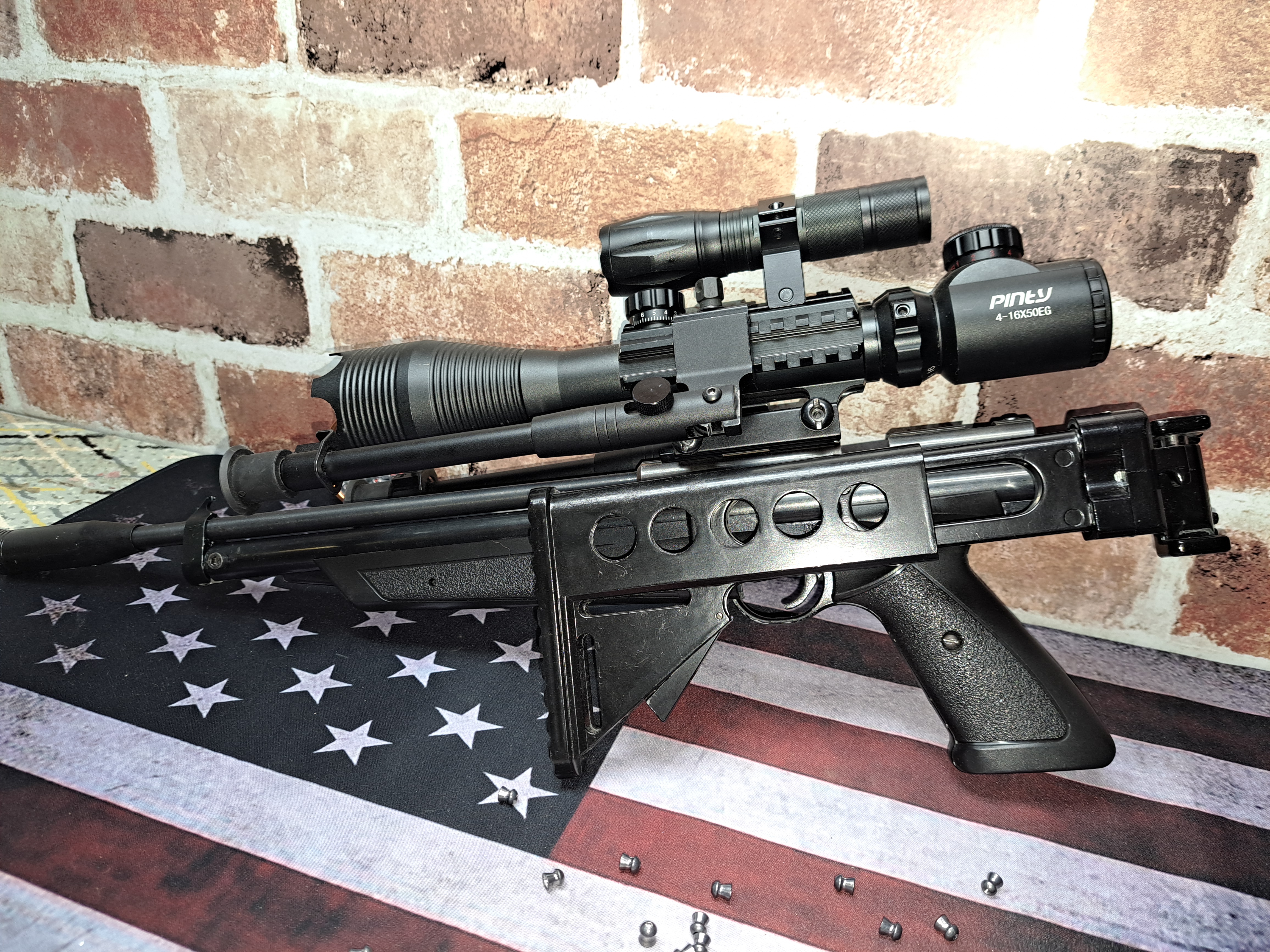

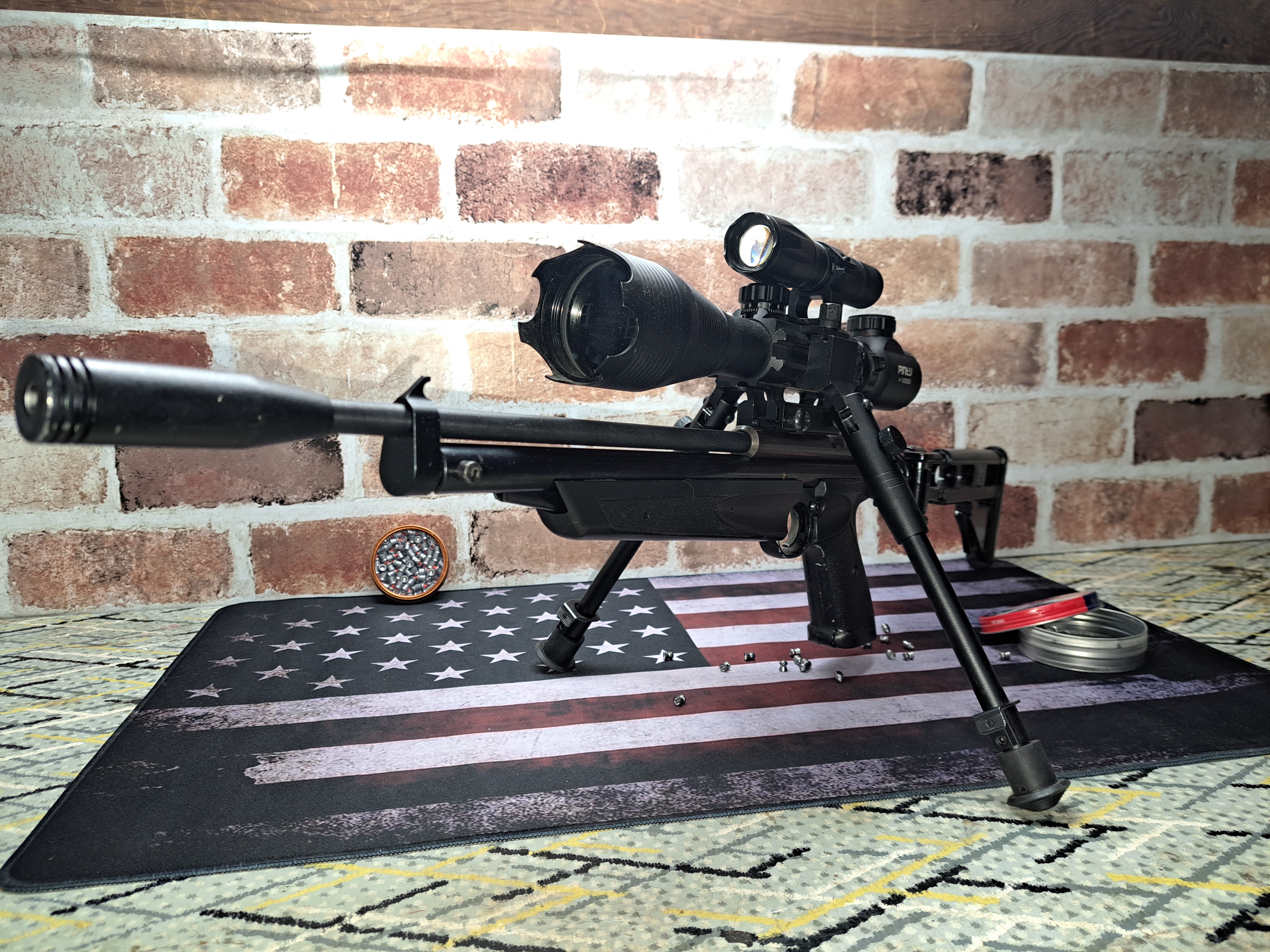

Start with the valve in the tube and mount the breech using the transfer port to align it than mark your 4-48 screw hole and rear breech hole. Drill and tap your 4-48 hole and drill your two rear cap holes at the same time granted you have aligned it properly. Cut excess rear tube to be the same length as the rear as a1322. Once you you have your top end and rear cap on mount your grip and mark the front grip/valve screw hole. Yes, it's a bit of work but worth the effort.

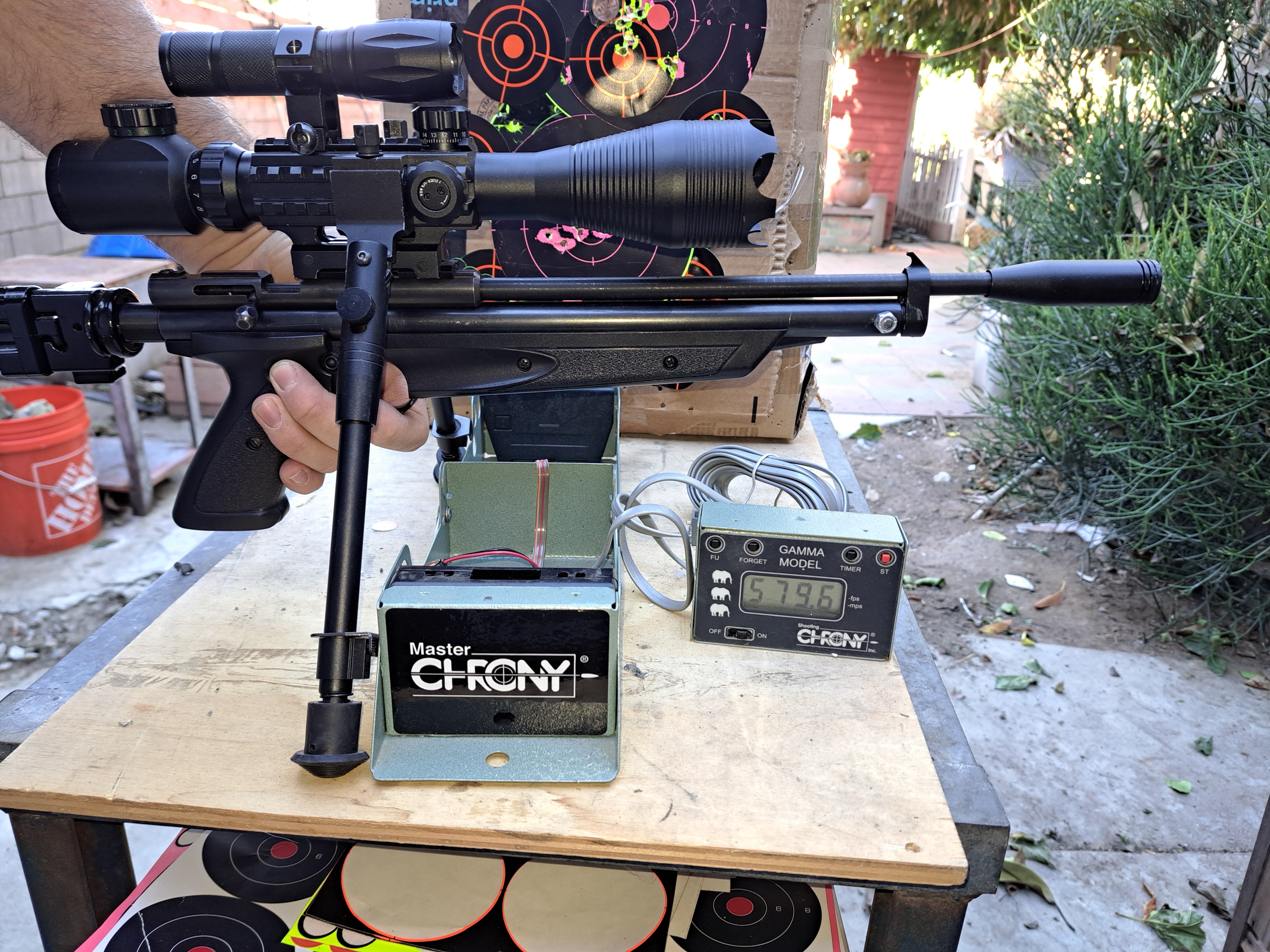

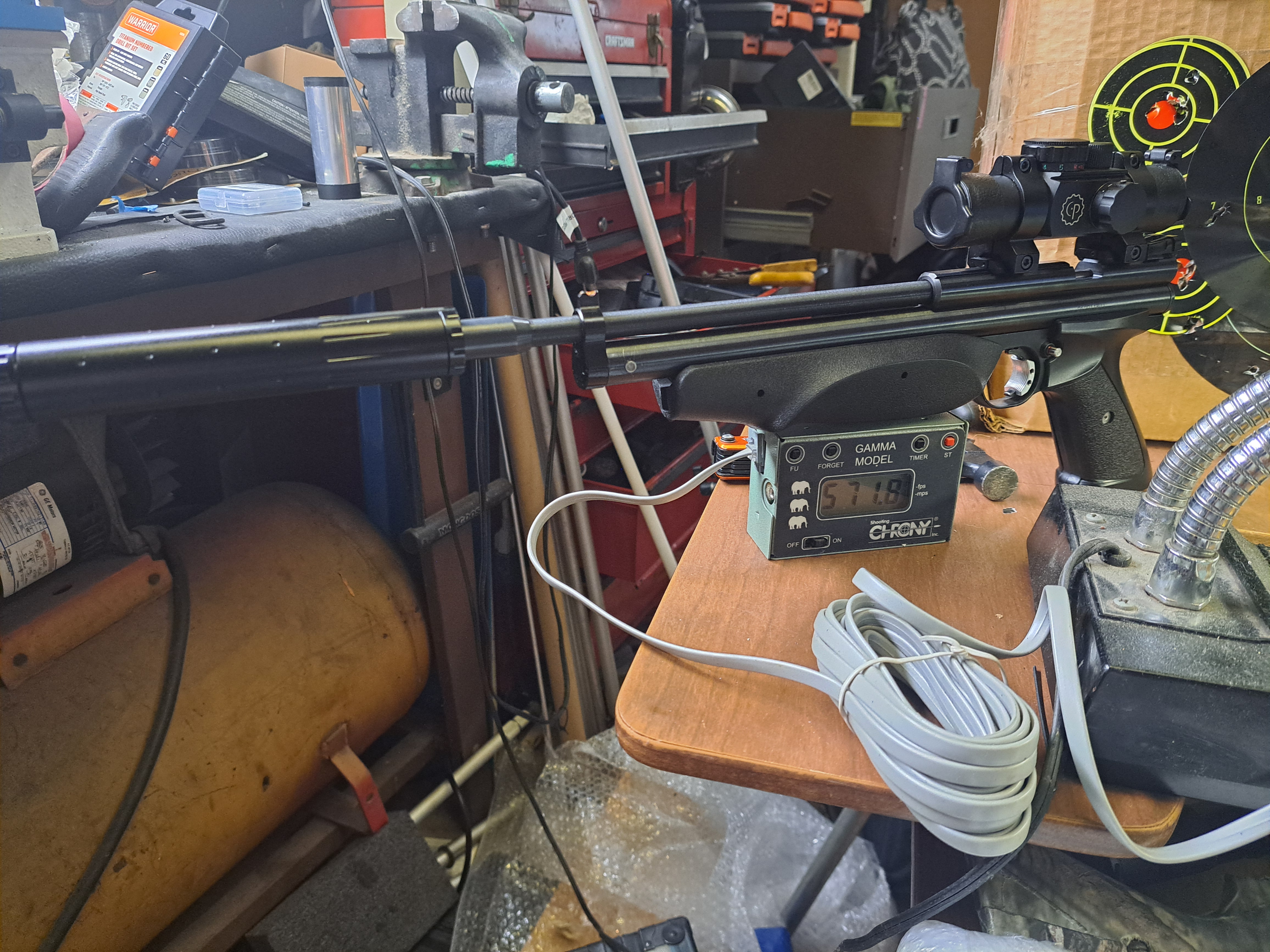

This is with 15.49 pellets before I finished the last few mods to the valve and have not chronied it yet and it hits harder now. Easier to pump and faster to get there.
Also need to extend the hammer pin slot.
Start with the valve in the tube and mount the breech using the transfer port to align it than mark your 4-48 screw hole and rear breech hole. Drill and tap your 4-48 hole and drill your two rear cap holes at the same time granted you have aligned it properly. Cut excess rear tube to be the same length as the rear as a1322. Once you you have your top end and rear cap on mount your grip and mark the front grip/valve screw hole. Yes, it's a bit of work but worth the effort. View attachment 498104View attachment 498111
This is with 15.49 pellets before I finished the last few mods to the valve and have not chronic yet and it hits harder now. Easier to pump and faster to get there.
what bipod is that and where can i get it? you have a very clean looking build there
Reactions: Rayan51
I've wielded it as a pistol with stock and scope stripped of and it's manageable. The complete build is HEAVY including the more recent added full size ldc and the only thing plastic is the safety, the grips and the forearm. Taking off the bipod makes it more manageable in weight.
This will be a full magnum pistol soon with all the carbine parts moving to a 2100 tube.

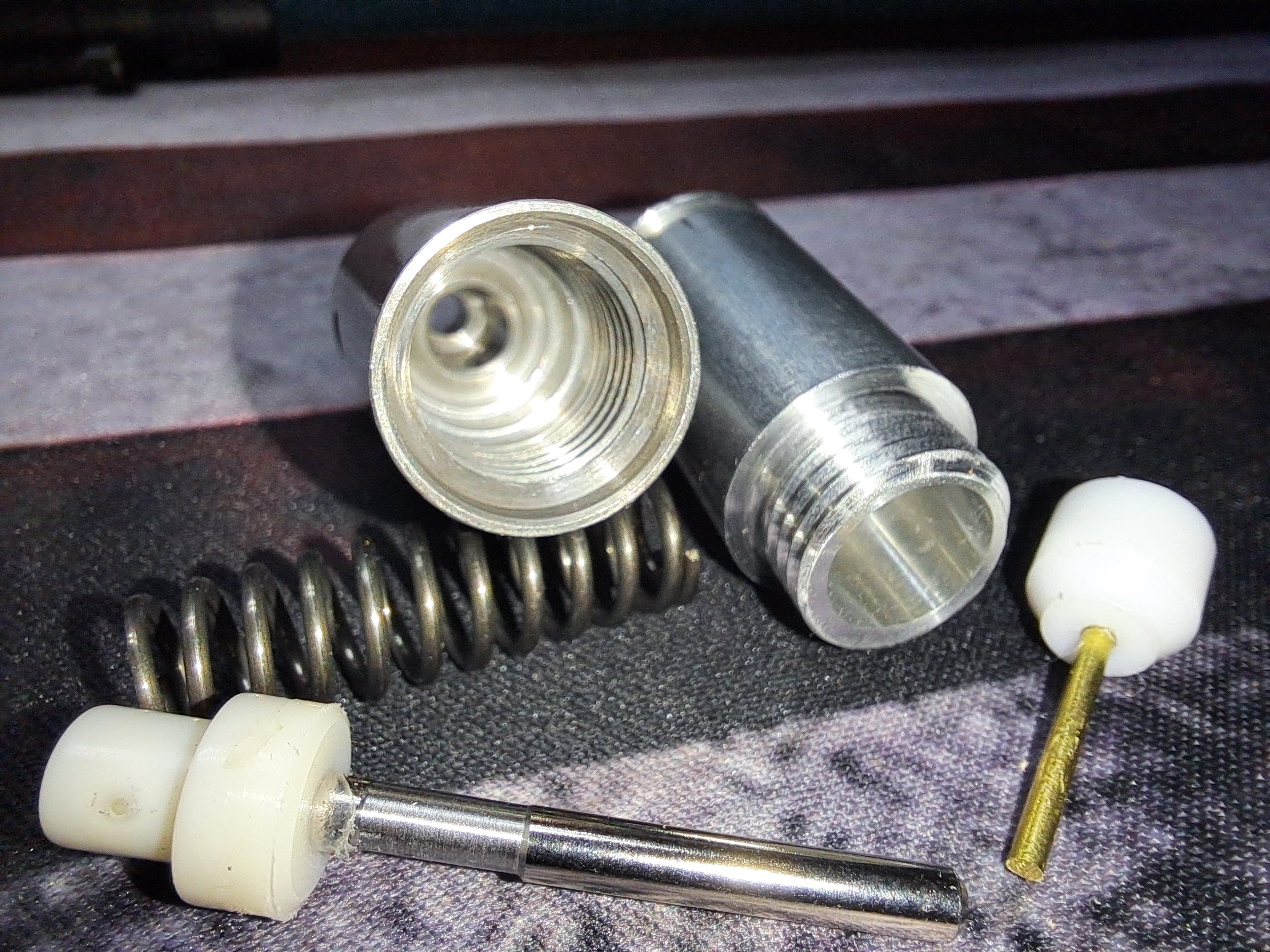

Add a pin to the inlet hole to remove head space. A little bit of volume goes a long way along with a larger transfer port and matching barrel transfer hole. 16 pumps with a pump cup with the previously stated mods and 15.49 pellets. Flat top will do much better and with less pumps.
