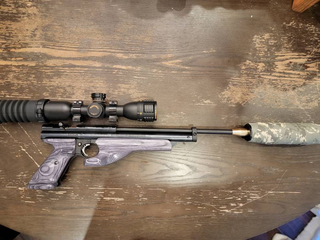

I have this 1322 and yesterday I put a bunch of Mac1 secret sauce down the pump arm tube (I know bad idea). Almost immediately after it started shooting really quietly. I thought my moderator was working super well at first, but when I went outside and pumped 10 times and shot my pellet bounced off my 5 yard target.
Since then I have completely taken this thing apart 100% three separate times. Every screw and o ring including rebuilding the valve. I replaced the o-rings and wiped off all the excess grease.
I don't have a chrony handy, but it still seems to only make like 1/4 - 1/2 power of what it used to though. Any ideas? Is the valve broken?
I may end up just buying another OEM crosman valve on ebay .... seems like that may be the easiest but wanted to see if anyone else has come across this before. Thanks

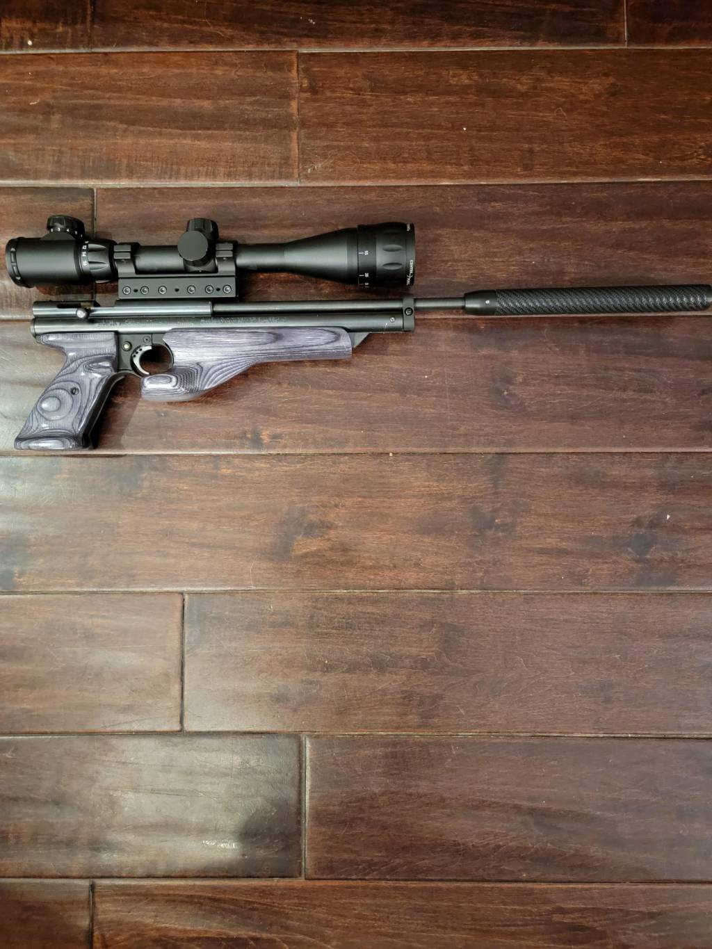

So I installed a new Alchemy Airwerks power valve kit, which also includes bigger hammer spring and transfer port, and was able to finally chrony this thing... this is not the flat top piston, but another type of power valve they have available.
At 10 pumps with 15.89 grain JSBs I'm getting 460-462 fps pretty consistently... on Chairgun that shows about 7.5 ft pounds at the muzzle.
I'm pretty sure I can pump this thing more, but does that sound right to you guys? I can't tell if this is still shooting low powered or not. 7.5 ft pounds is not bad, but I guess I would have expected it to be in the mid 500's or even 600's fps.
By the way I have a 14 inch LW barrel in case it matters for velocity.
