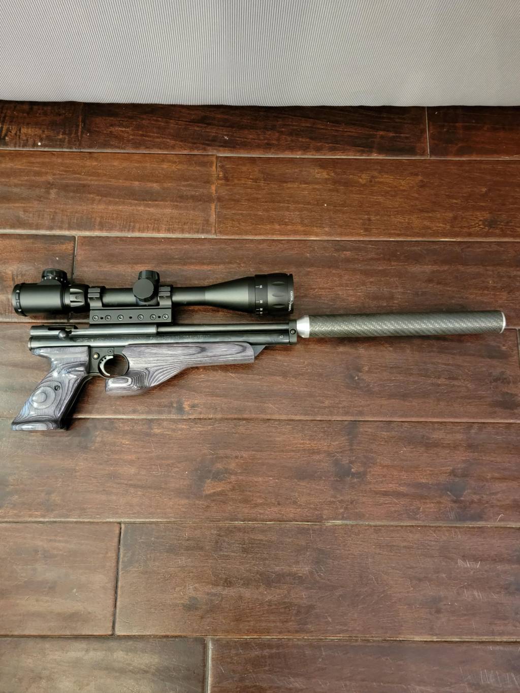

I just got this back recently from Tim at Mac1. He added his accuracy and power tunes on my 1322 and now it's super consistent and puts out good fpe. That includes him making a flat top valve/piston and his custom stronger piston.
With 10 pumps and a 10 shot string, 15 grain JSBs, avg 500 fpe, spread 6 fps, std dev 2.1 fps, about 8.8 fpe. Super accurate even I can shoot it well.
