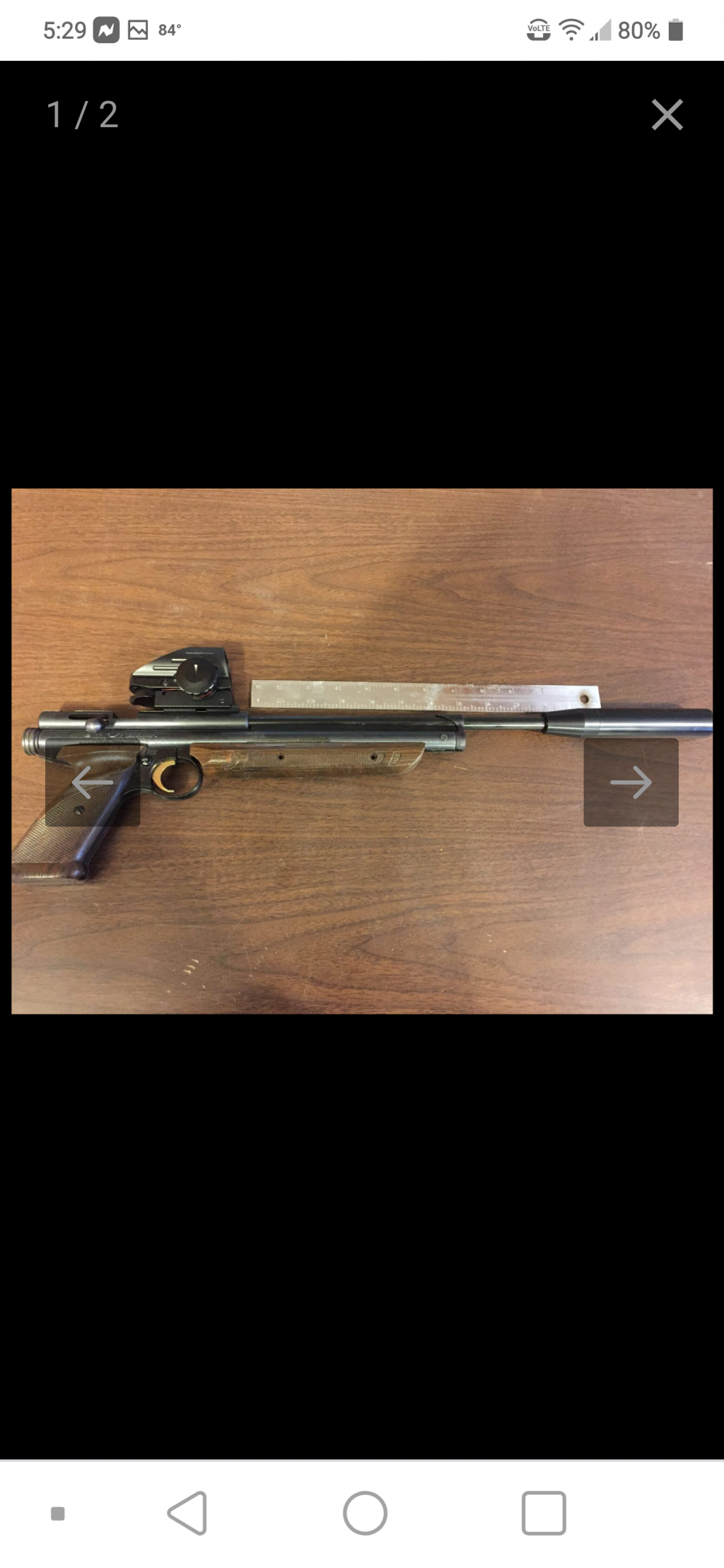

If you are looking to purchase one, this mac1 tuned with tko for sale on warrior
forum. The tko will make either mouse quite.

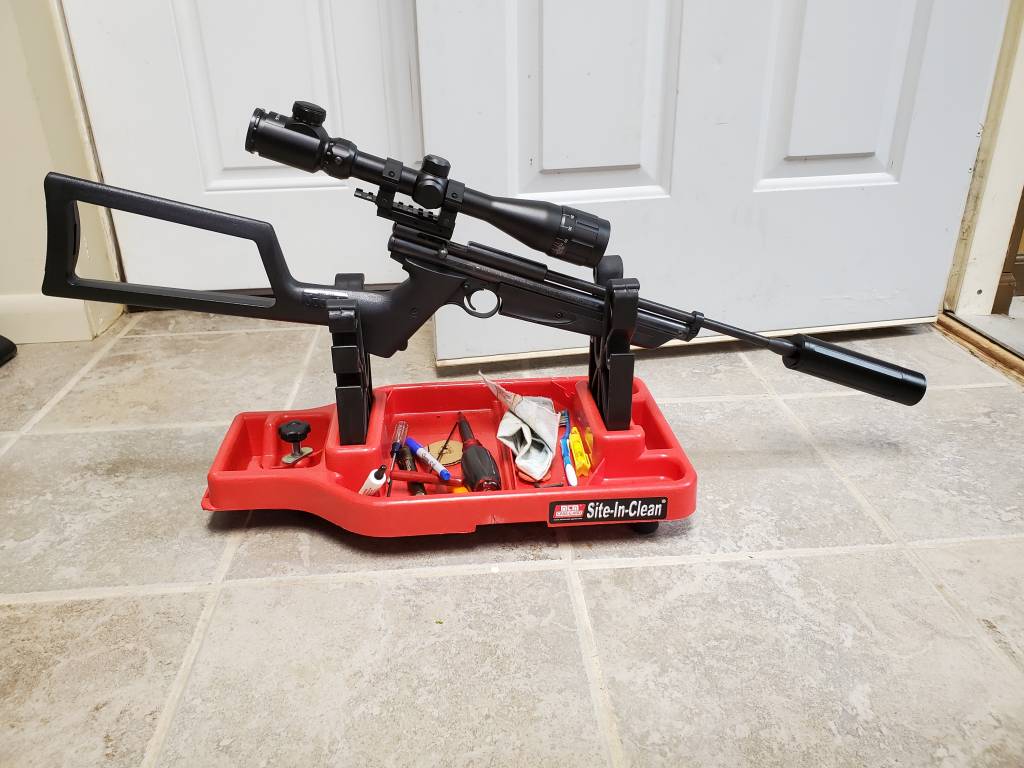

Yes I did. The adaptor I bought has the 1/2 x 20 threads that match my Sumo from another gun. Long story short, I did the steel breech, then a 14 inch barrel. Had an extra Sumo in the gun safe and figured why not? The adaptor is a snug fit but is secured by a grub screw. I bought if off ebay and it came from overseas so it took a little while to get here.
It's ugly in my opinion, but it was built for a purpose. Its super quiet, shoots a dime size group at 18 yards (porch to squirrel distance) and never gives a pass thru. My pellet to confirmed squirrel elimination is 6 out of 7. The miss was my fault.

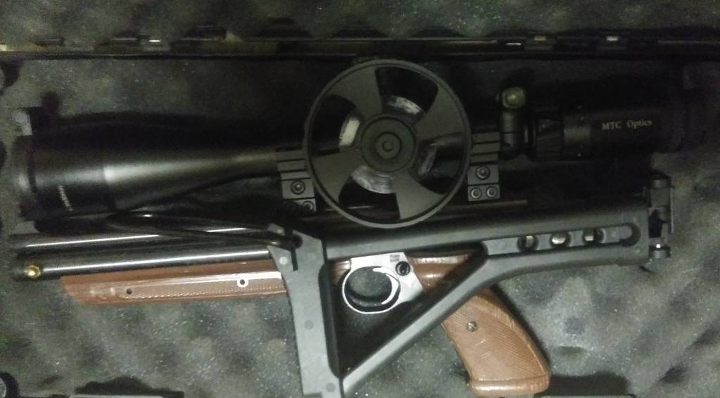

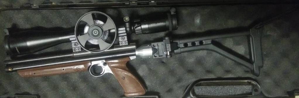

Heres My 177 only did a DIY flat top piston and hammer and trigger mods and added on some stuff. It's one of my beater trunk guns. Scope is a POS and the FX No Limits Rings cost more than the gun but it NEEDED adjustable rings to zero the MTC VIPER PRO.
It's not offensively loud at 5 to 6 pumps and powerful enough for plinking no need for 10 pumps you will see unless you need to pop birds past 30+ yards I saw no need for a silencer. If later I was gonna quiet it like silent I'd just buy a longer barrel like $40 factory Crosman barrel and throw on a $26 Airgununiverse LDC. Barrel adaptor and other brand silencers are a waste of money and adds too much weight to the 1377.
