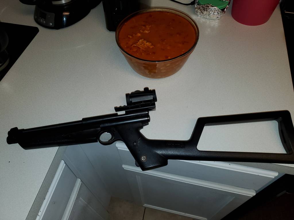

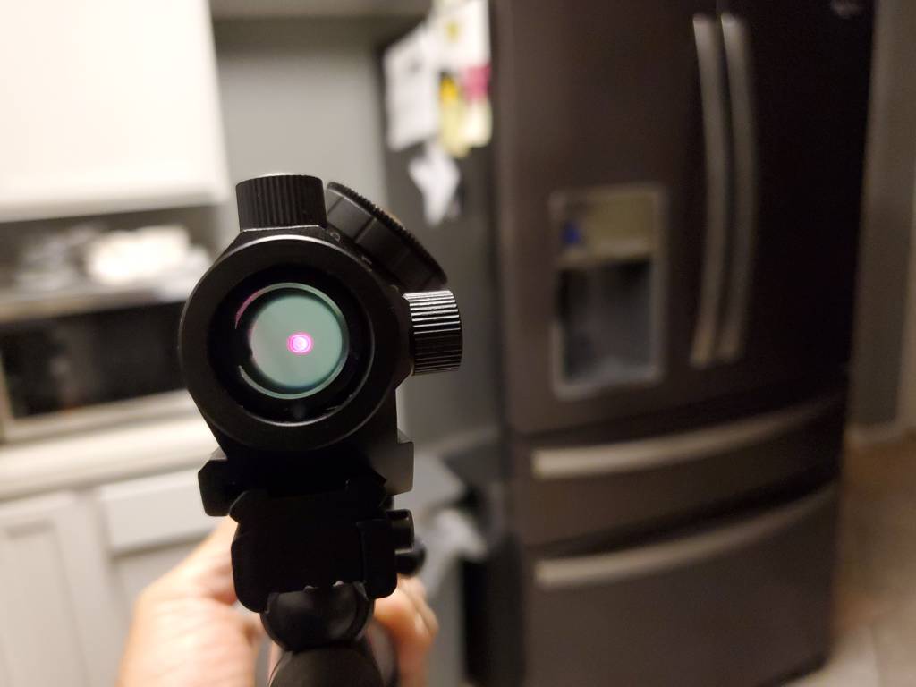

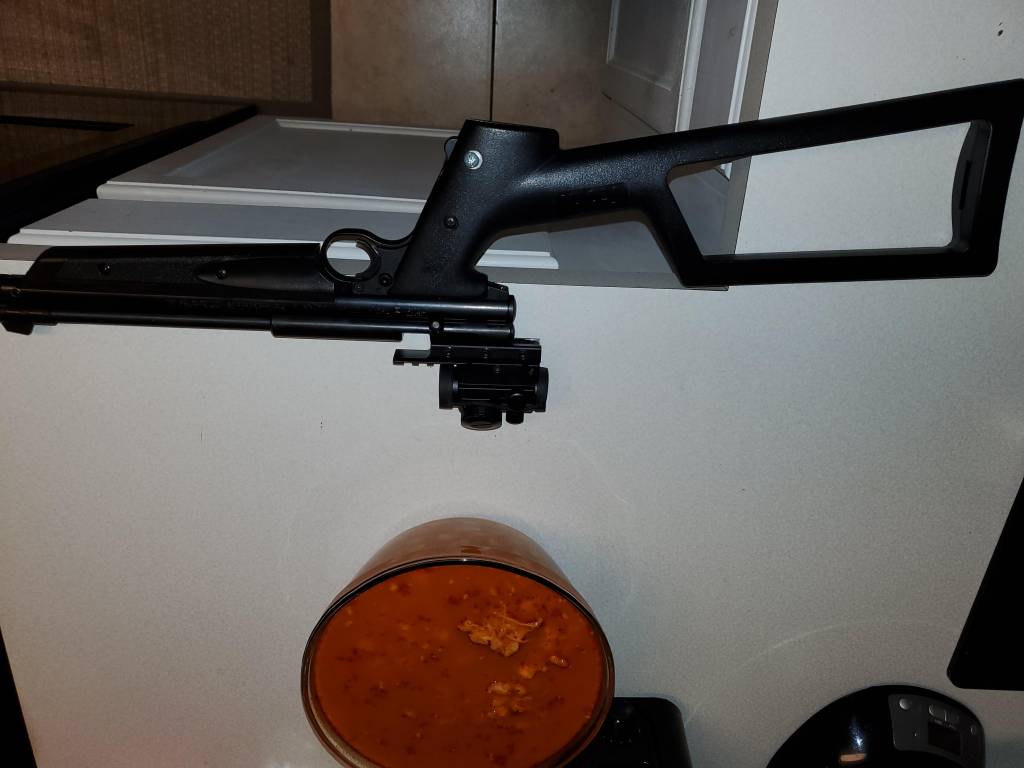

I also have the steel breech, stock, and cheap RDS. As LGD said, most RDS, when zeroed correctly, they should be parallax free.
My 'dot' (disregard picture thru RDS) at brightest setting, looks like a misshapen square. I tone it down until it looks like a dot.
I only rarely plink with this, no hunting.
