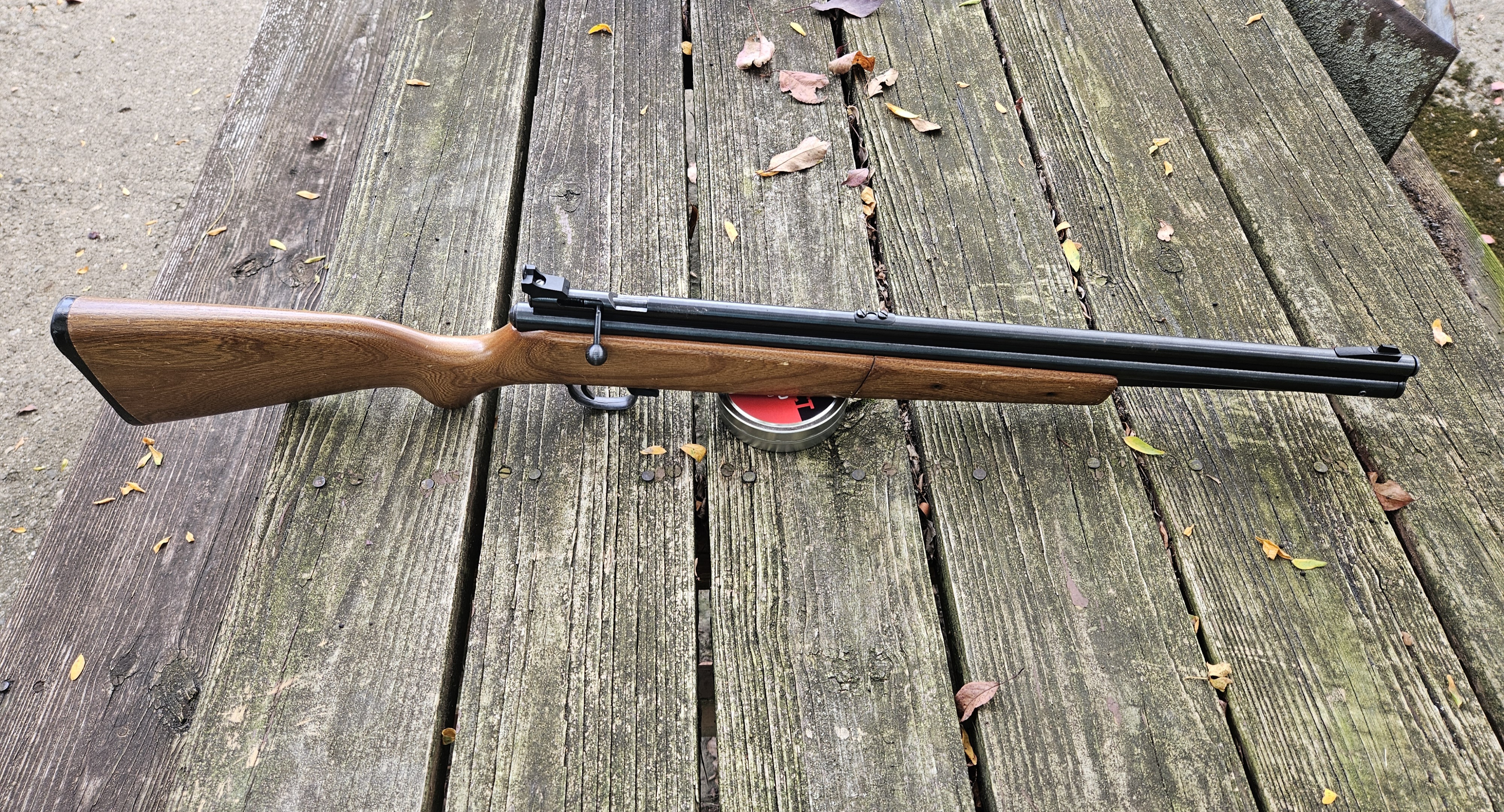

Crosman 140 fourth variant
Love my 140 but keep it to 6 pumps most of the time due to the trigger pull issue. Shoots pretty close to my Sheridan although the Sheridan has a better trigger pull and better sights. I remember back in 1970 my big brother got one and I wanted desperately to shoot it. I had to pay him $5 back then for 5 pellets. Finally bought it off him when he got a 22 rimfire. Now I got every airgun I had or wanted as a kid which is special when you shoot them. These 140s and 1400s seem to going for reasonable cost unlike the Sheridans.

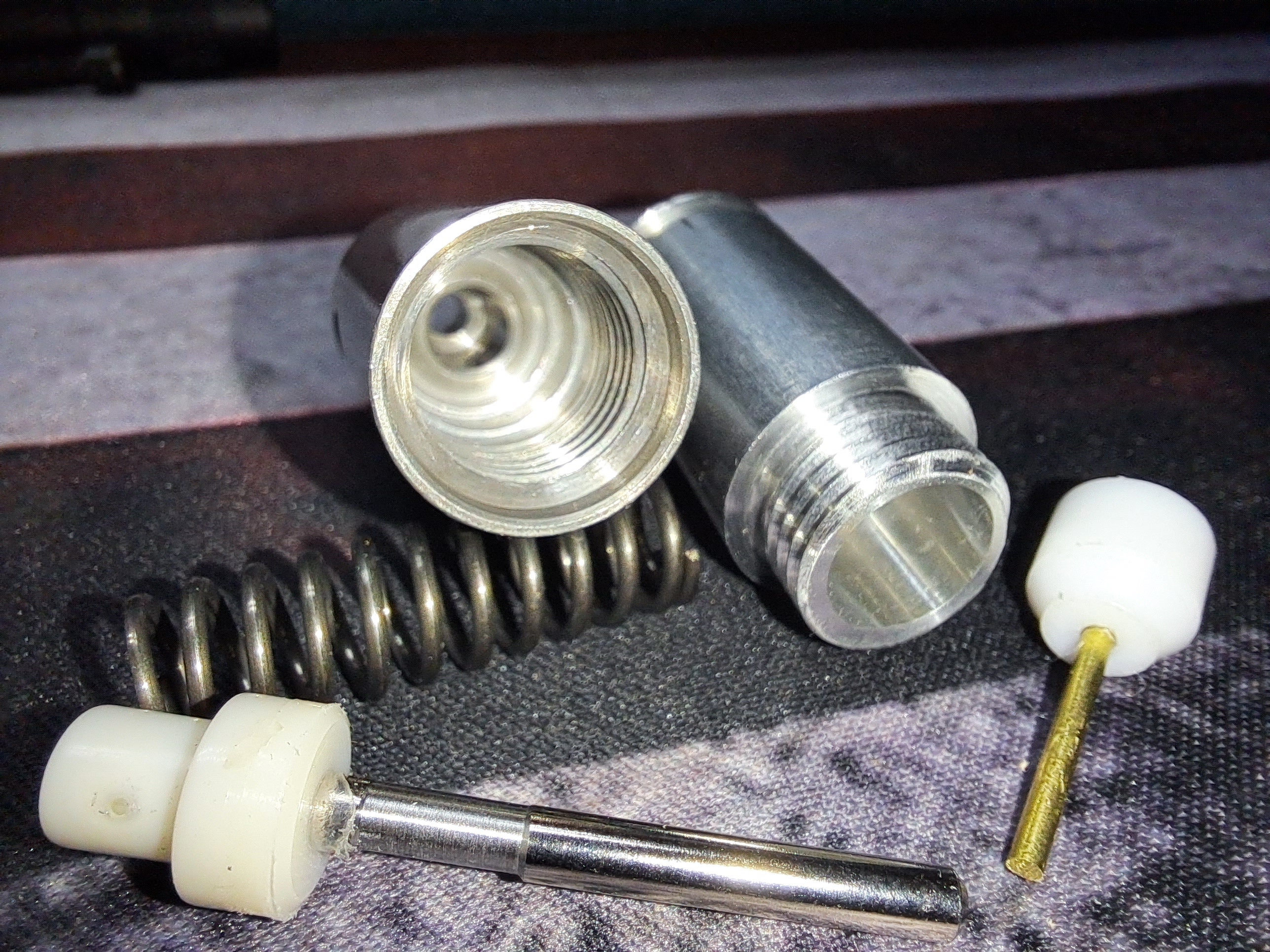

Hogged out the valve for max volume.155 ports all valve mods done, pinned the valve Inlet to remove almost all head space flat top piston weeker valve spring. Poppet valve ground down for flow and I use a rear cocking knob with spacer for more spring preload. Was getting 510fps with 27.5 grain before all the additional mods mentioned. I plan to chrony it soon and zero it for 20 yards. The .177 is getting over 1k with 7 grain on 10 pumps.

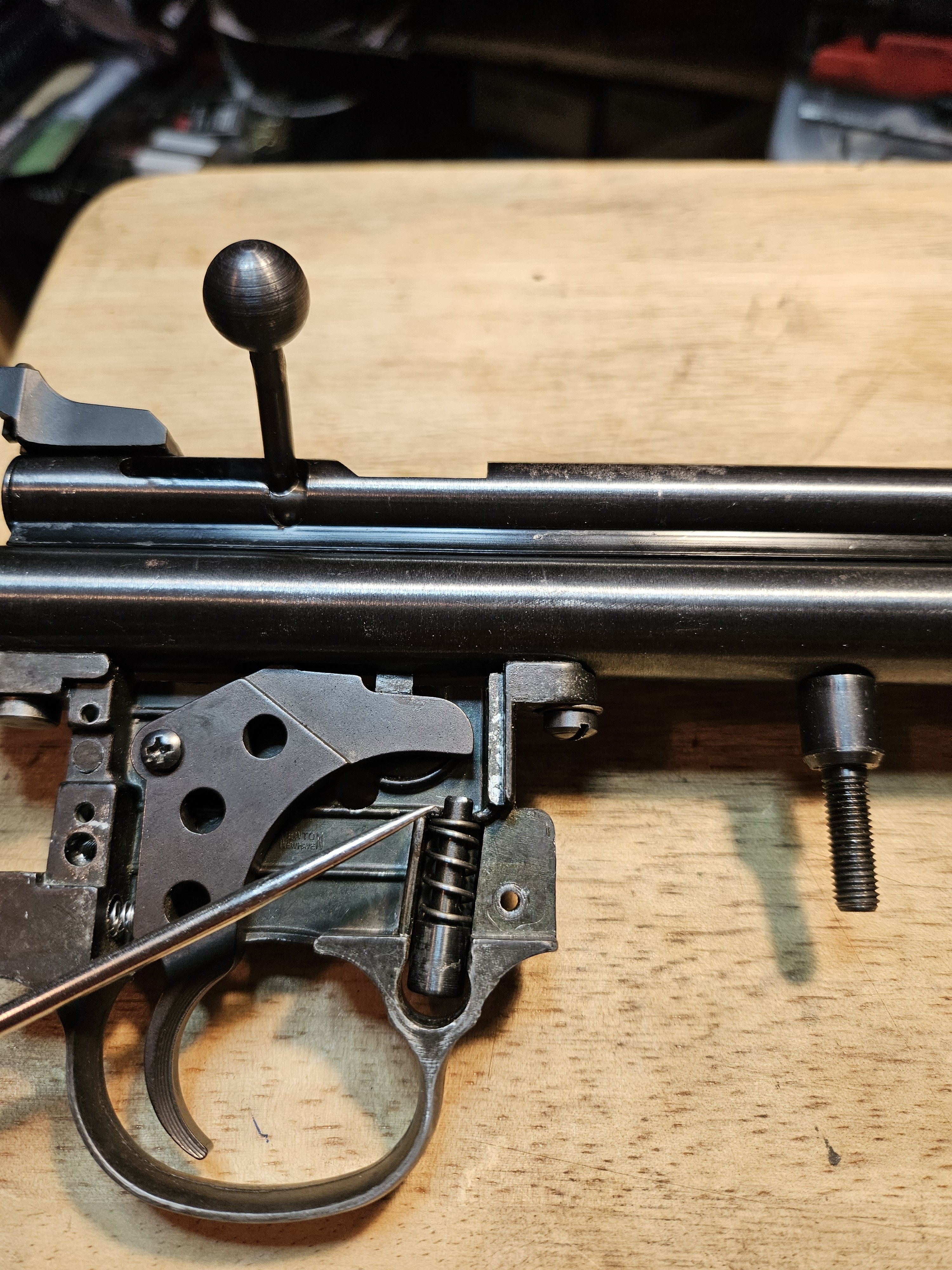

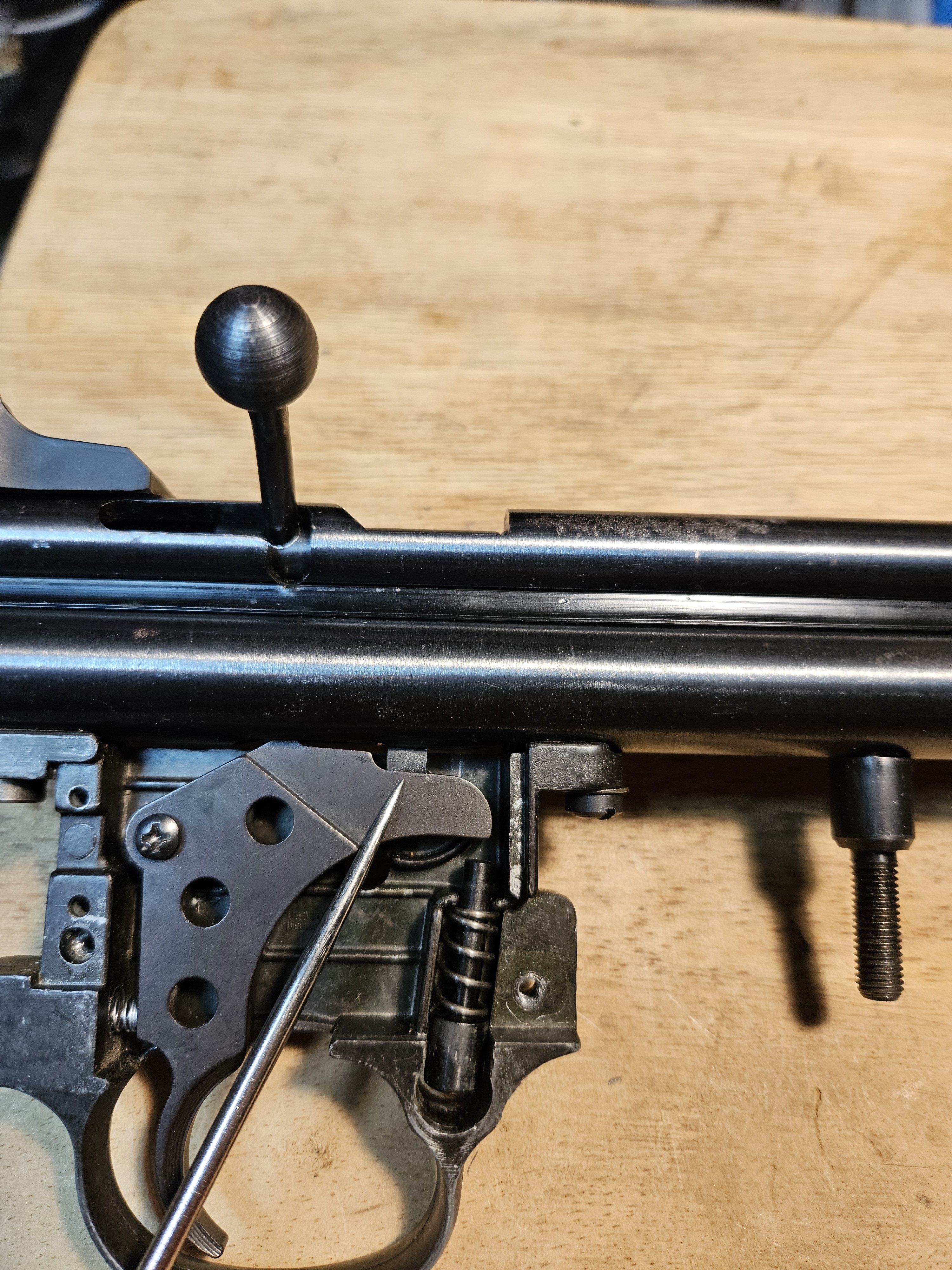

Absolutely.
The probe is pointing to the .125 shim that I used. It is 90 durometer rubber bonded to the trigger nose with Zap a Gap CA glue.
The trigger surface was prepped with a swiss file, 320 grit emery cloth and acetone. The rubber shim was cut to size and cleaned with acetone.
The above photo also shows the safety plunger at OEM length. Left as such, the safety lever WILL NOT be able to be reinstalled, and you will of course have NO SAFETY.
In the above photo the probe is pointing to the safety plunger that has been shortened by .125, that relates to the ammount that I shimmed the trigger.
This allows the safety lever to be reinstalled in normal fashion, and YOU WILL HAVE A FUNCTIONING SAFETY on the rifle.
As always, proceed with caution, make careful measurements, and be absolutely sure to bump test the bejeebus out of the rifle before committing.

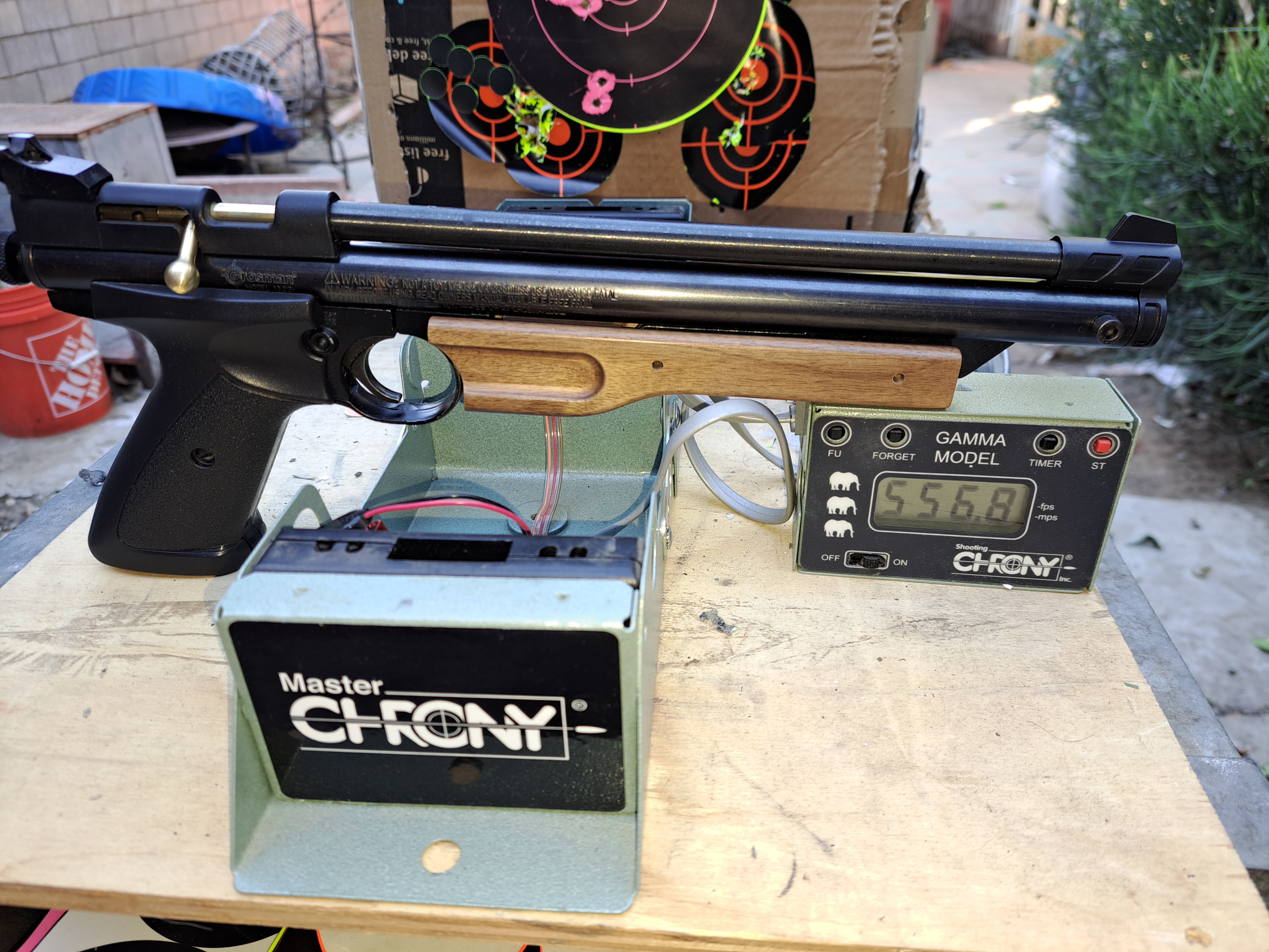

Larger valve volume (not too large), Inlet hole pinned to remove head space, valve spring compressed for easy open, poppet ground for flow, .157 ports in the barrel and transfer port, and exhaust angled for more flow. Produced 556 fps on 16 pumps with 15.49 .22 pellets on a stock barrel and pump cup. The same can be done on the 1400 as I did it on my 1425 and 1477.

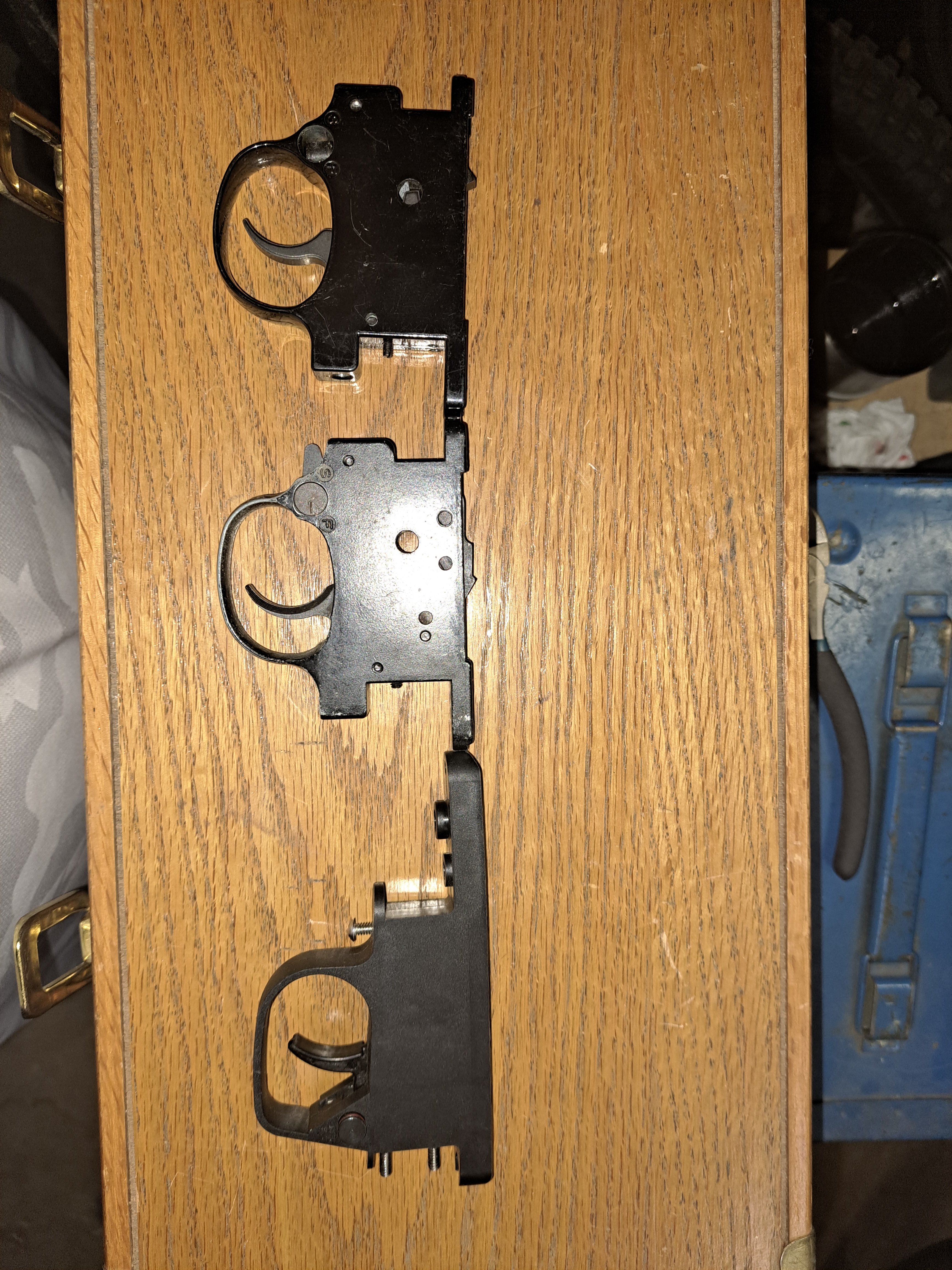

In order as pictured.
Crosman 2260/ disco trigger
Crosman 140/1400 trigger
Crosman 160/Qb Trigger
Notice the seer engaged in different areas and function different. The 160 holds the hammer from going forward, the 140 holds the blow off from coming back, the 2260 and the qb trigger fiction in the same way to a degree but hammer engagement is different. The qb trigger would not work on a 140 but a 2260 trigger may with some seer modifications or convert it to a standard poppet valve and make a new hammer.
