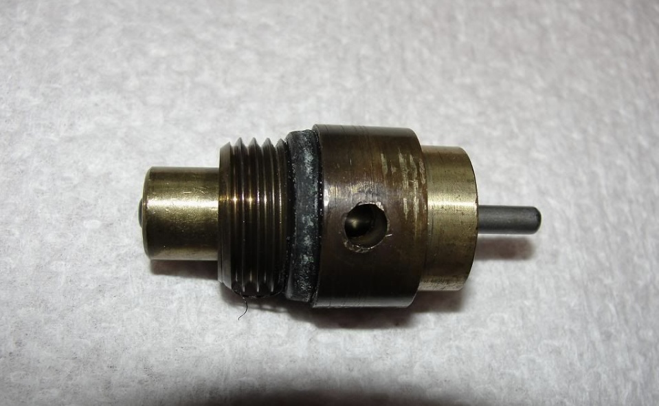

Should the seat face be sharp, so it cuts into the seal material slightly? Looking at the seat of my 150 valve it does look like it should be sharp, not flat, so it penetrates the seal material slightly.
I am thinking I need to use something with an angled face to polish the face of the seat to ensure I keep the same profile.
If the valve assembly shown in the photo is the one you are having issues with sealing, I strongly suggest you replace the o-ring with a 112 urethane one before you attempt any modifications to valve seat or poppet valve to see if that solves your problem. The one shown appears to be very questionable.
The original valve seats appear to be flat or nearly so.

i am all about Urethane Orings when dealing with CO2 but i am not sure that CO2 would touch this Oring and cause it to swell through absorbsion

I too prefer polyurethane for use with CO2, but the more common Buna-N is perfectly fine for static seals like the one on the valve.
i am 100% with you after spending much time on the 850 forum polyurethane Orings are a must if you are do it right but granted harder to find
