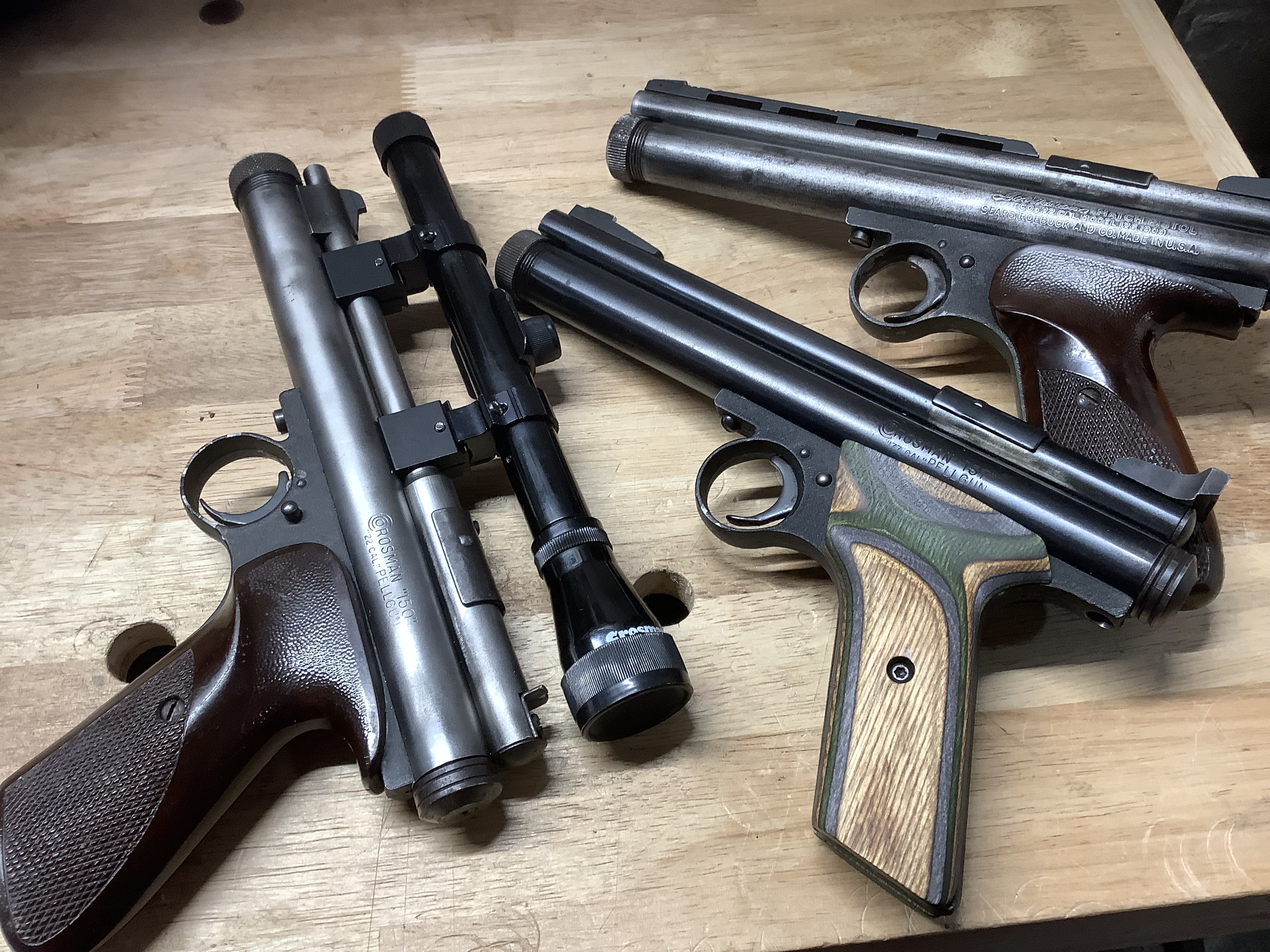

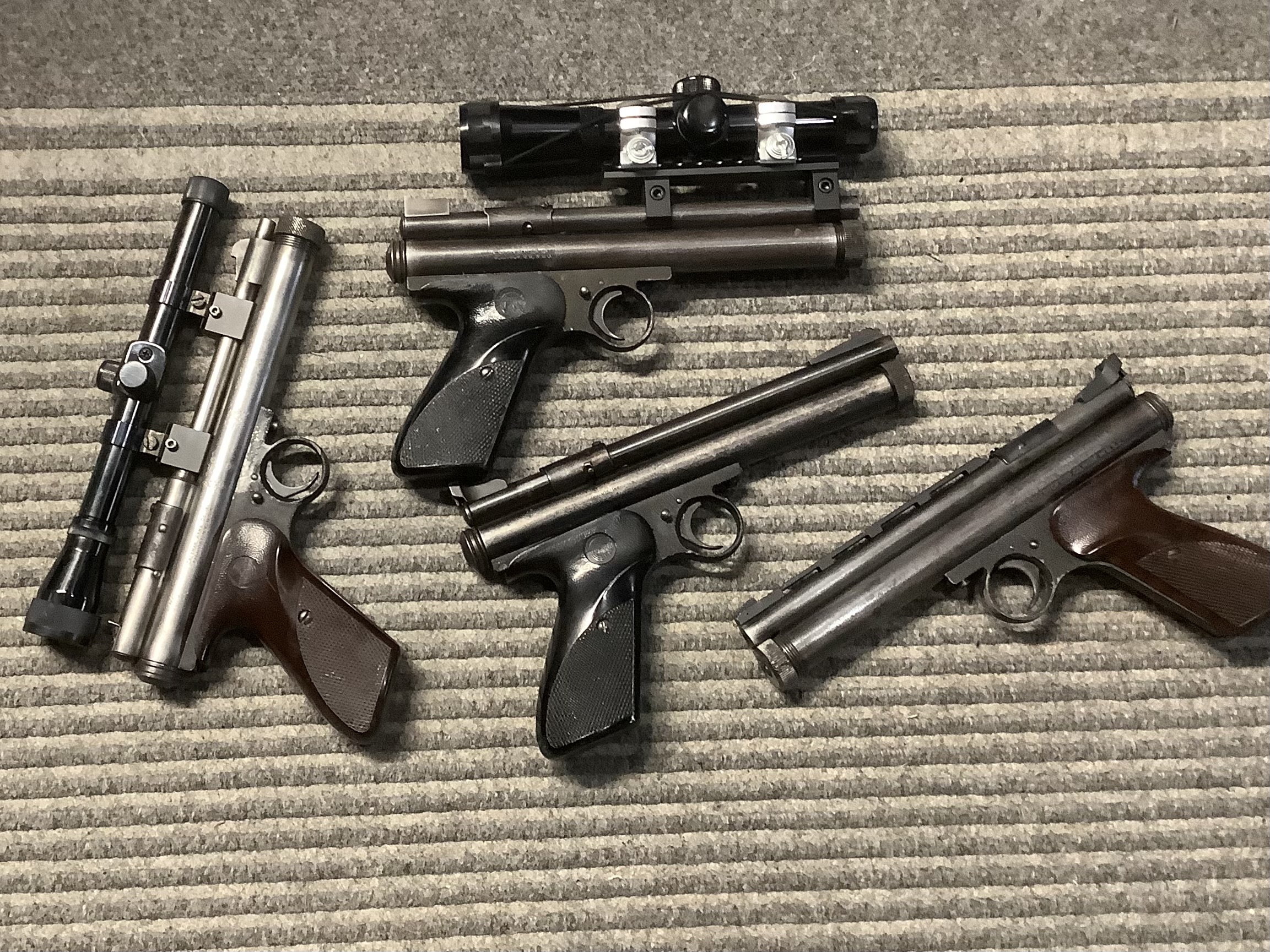

Replacing the valve spring and pin with plunger fixed the problem. The valve was remaining open after a few shots or even just one pellet with all the gas exiting out the barrel. I believe replacing the spring in the valve fixed it. The old spring felt weak the new one felt too siff but it was perfect.
Lesson Learned - When in doubt- springs come out. I can t measure spring tension with my fingers duh!
Shoots great, so I am really happy with my 157; I used up a bunch of co2 s figuring out the problem. Also bought a seal kit too. I shot my 150 often and recently added a scope and a trigger job. Planning on adding a rail for Red Dot and a laser to the 157.
