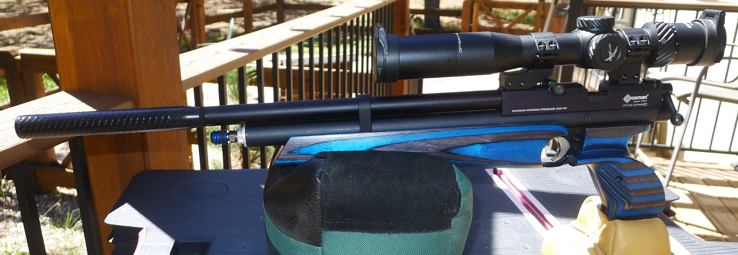

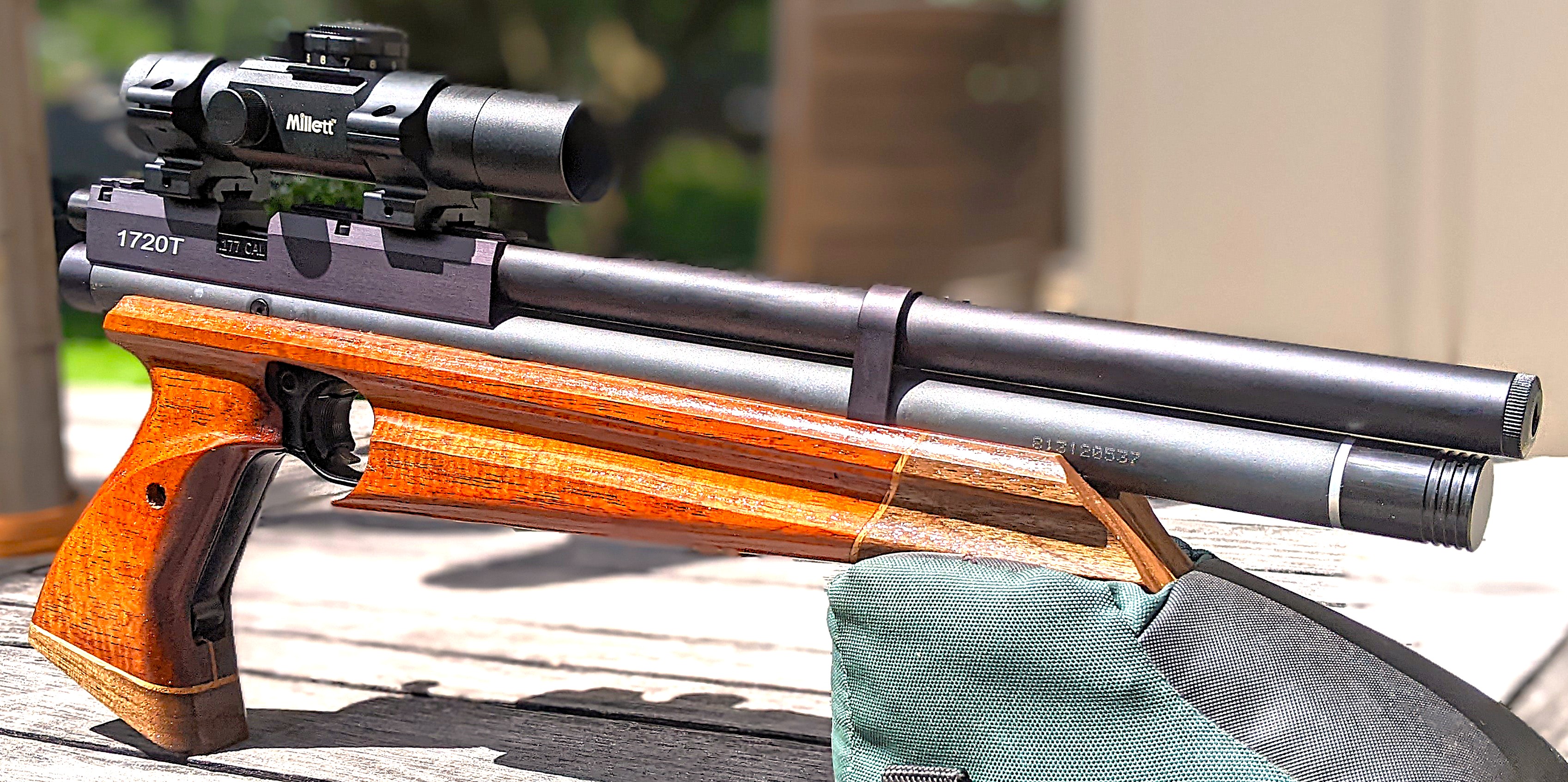

1701/1720 current configuration
Crosman 1701 converted to 1720
Huma Regulator
TP = 0.080”
Alchemy Airwerks Stainless Steel 2 Stage Trigger
TKO Moderator
DonnyFL moderator adapter
Steven Corcoran Forearm & Grip
Optisan CP 3-12x32P Scope
UTG Accushot Scope Rings
