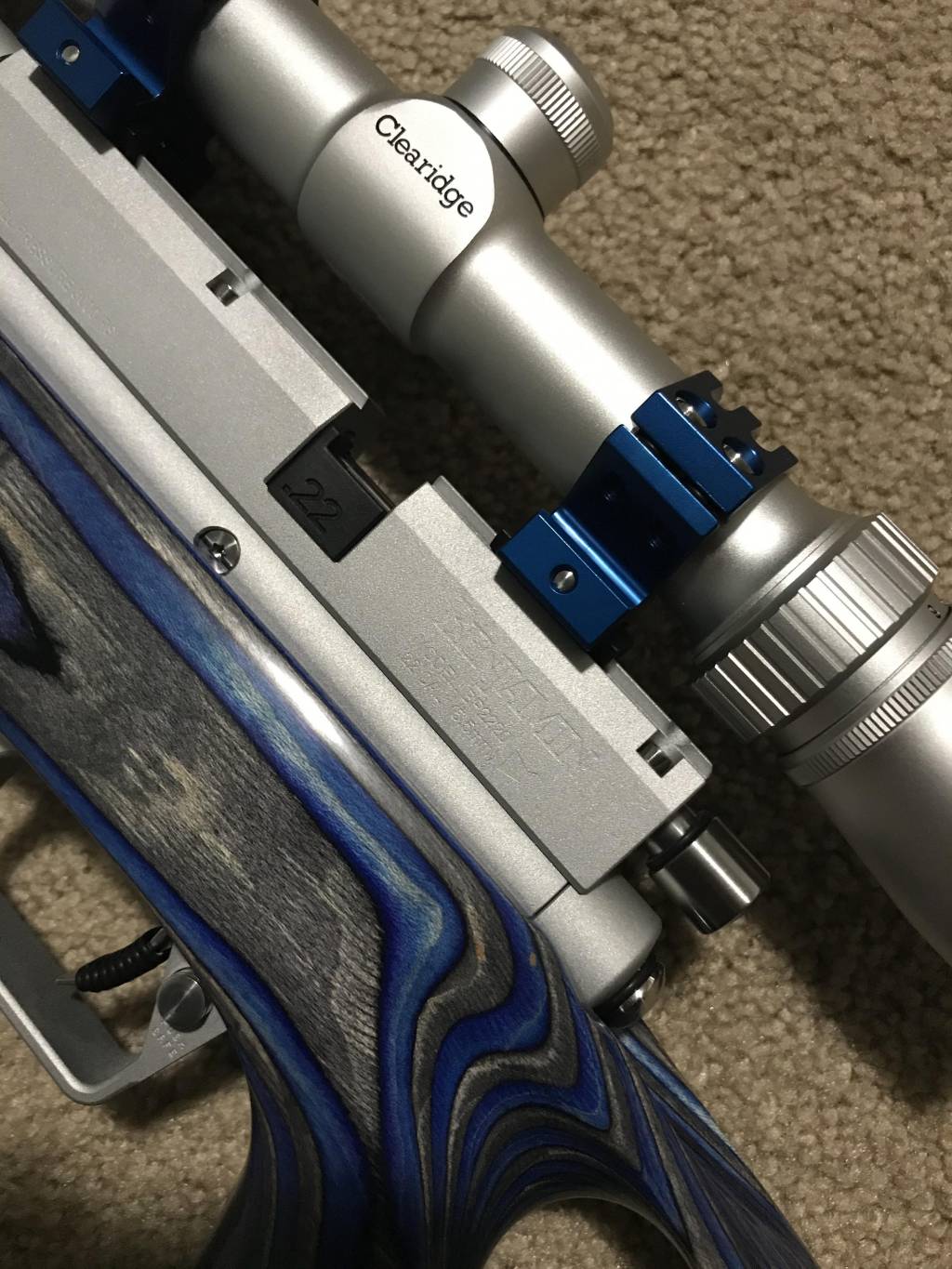

Crosman 1701P Bolt
The cap bolt that locks the cocking bolt must have come loose.
All you have to do is remove the top section to see if the clip ( secured by 2 tiny screws ) that orients the cocking bolt is also locked in place.
On my PROD, I placed an O-ring in the back section of the cocking bolt so that when I engage it it presses against the rear of the breech.

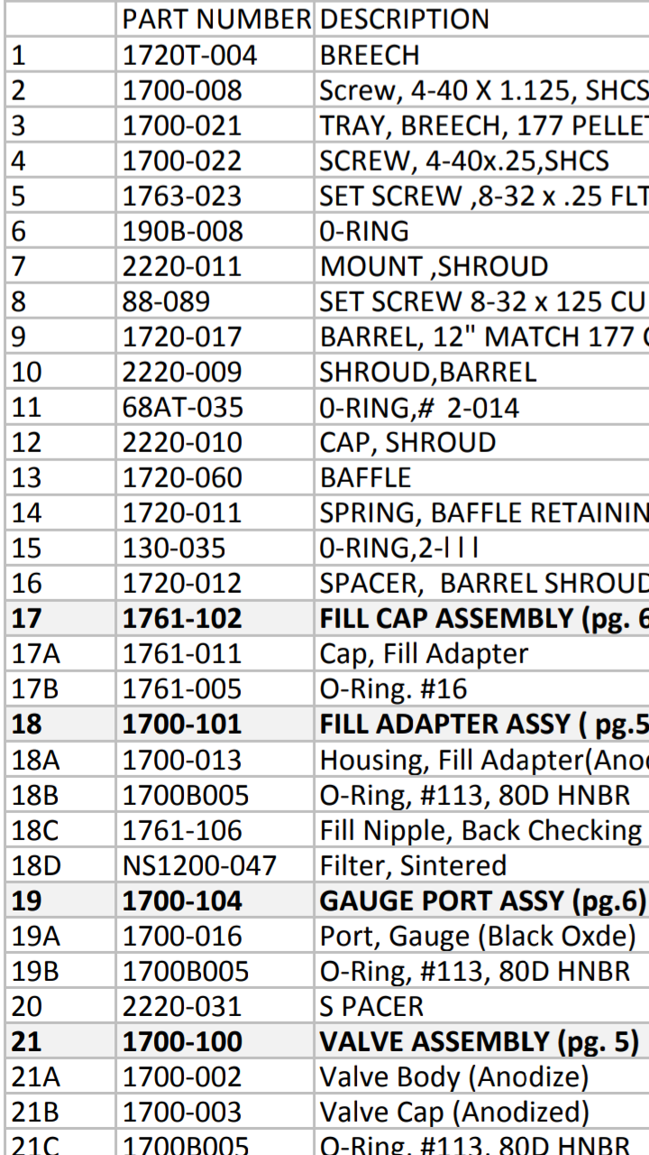

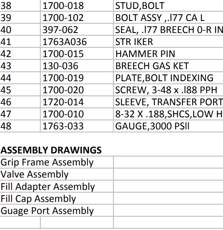

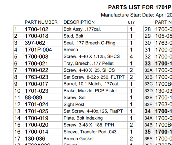

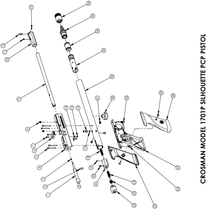

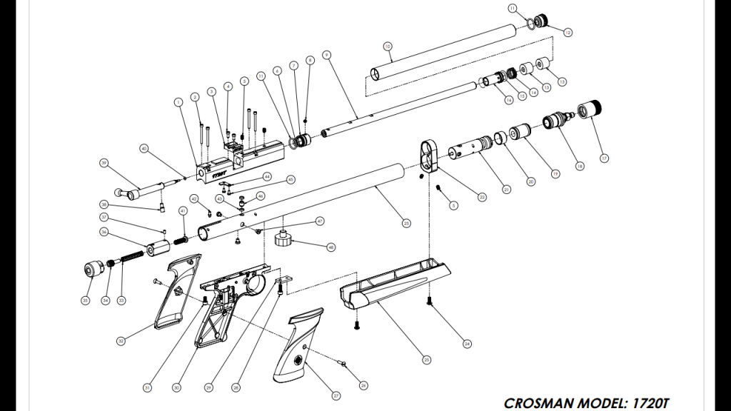

They share the same part numbers of the major parts in question-
My 1701 breech/bolt had the same issue. I'm guessing that's the way some of then are. It is an annoyance at worst. For me it was irksome enough to address. I drilled and tapped an additional 8/32 into the top rear of the breech and dropped in a teflon ball with a grub screw on top of it. I gave it just a very slight bit of pre-load and that took care of it. The bolt is still very smooth to operate but no longer flips open when inverted.

Don't know if the 1720T, and the 1701 are the same bolt assembly, but this video is of the 1720T bolt. If they are the same, then this video will help. I've never had my 1701 apart, and I'm going to leave it alone, along with the modest power and shot count it has.
